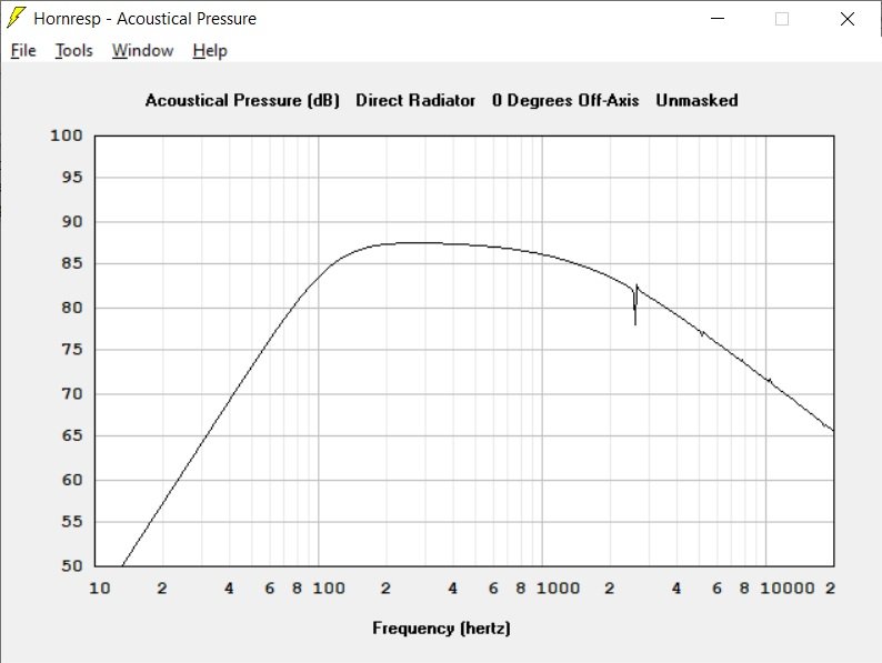

HR has only the possibility to add two ports (ME1 and ME2). I like the easy usability of HR. Even if akabak is harder to understand, you have this high degree of freedom. At the moment it is just not possible to simulate this configuration in HR. I don't get you, how would it be possible to get the right pipe size in HR?

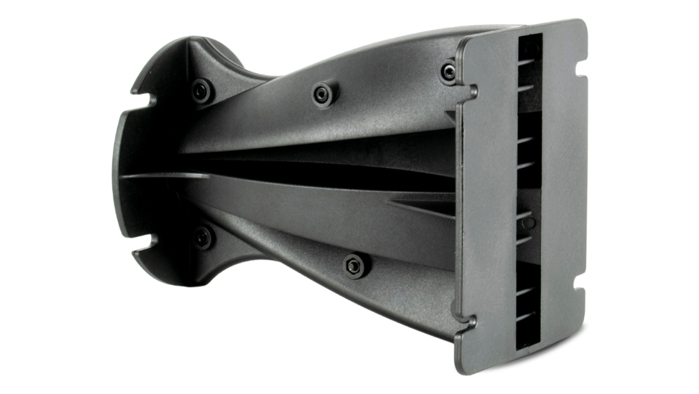

as for line arrays there are conditions that need to be met for them to work right ... these are very difficult to meet which is why line arrays are generally not used unless there is some very specific reason why you want one. to give you a rough idea drivers must either be spaced closer than 1/2 wavelength at highest wavelength fed into them ( not possible in your case ) or the gaps between them should be not more than 80% of array length ( not possible with circular sources which are effectively shorter than their diameter ). so again, basically impossible in your case.
professional line arrays are built with special drivers that have square baskets for tighter spacing and special internal ( not visible from outside of speaker ) waveguides on tweeters that look like this:
these waveguides allow the array to meet the 80% requirement because they can be butted up flush against each other.

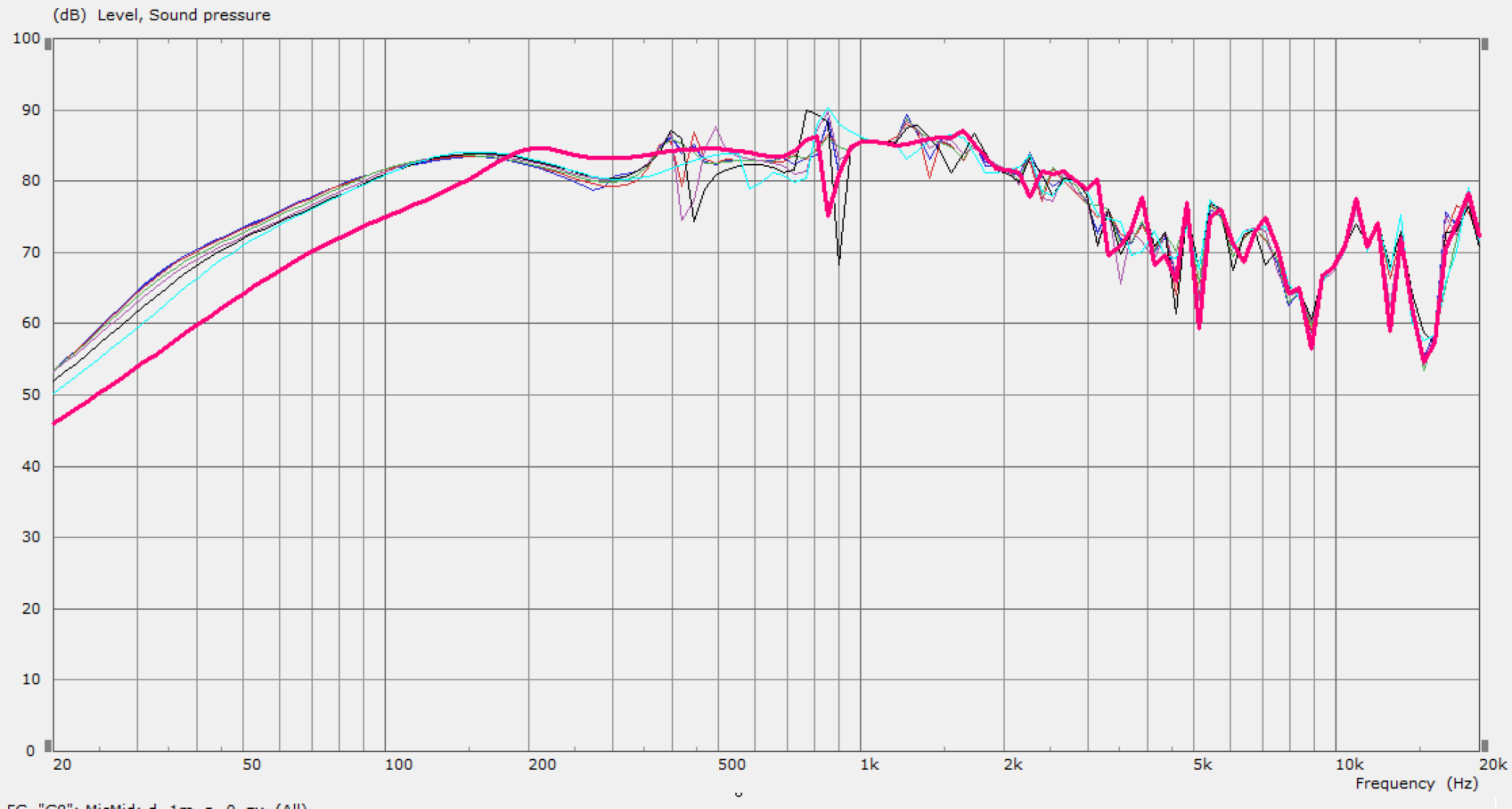

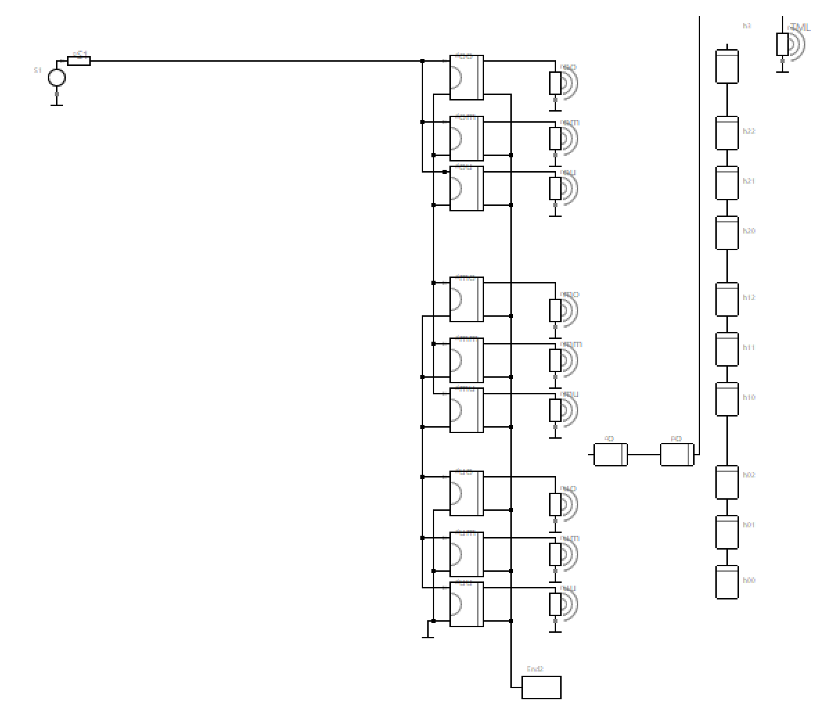

An update after a while. In Akabak it is not possible to add damping to a waveguide but in ducts. So I changed the 3 wg by 9 ducts, each duct being proportionally smaller than the previous one to obtain a tempered line. To my delight, the f-response did not change. Then I try to change the values of the ducts and nothing happened. Therefor I have delete one duct by another. Shockingly the fr did not change significantly. Only when I was deleting the last duct (86mmx105mmx233mm) there was a clear change:
So the pink response is just 3 BR chambers with 3 chassis left. Here is the LEM with the last duct not deleted.
I try to understand if something is wrong with the LEM.
@3mb0t Which model is being used ? if you DM the project to me, I can have a look at it.
The concept you are trying to build is inherently very tricky to tune because of all the interactions (bass reflex, transmission lines, HF combing). If you have modelling doubts, start by making it simple, like 9 drivers with their own individual sealed chambers, to verify the known monopole behavior. It will be easy to enable one driver at a time to incrementally see the effects when checking the model.

Hi Allen, I dont think that is a akabak problem. I try a lot today and can tell, as DonVK sad, its an interaction between the systems (BR, TML, LA).

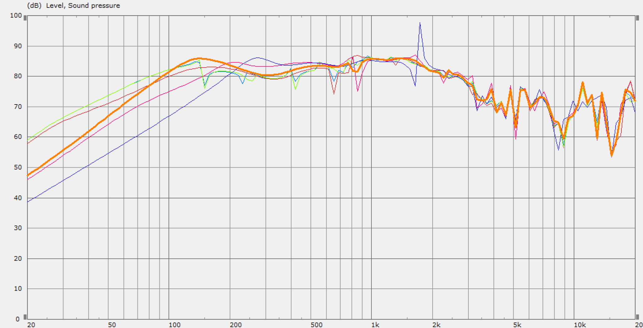

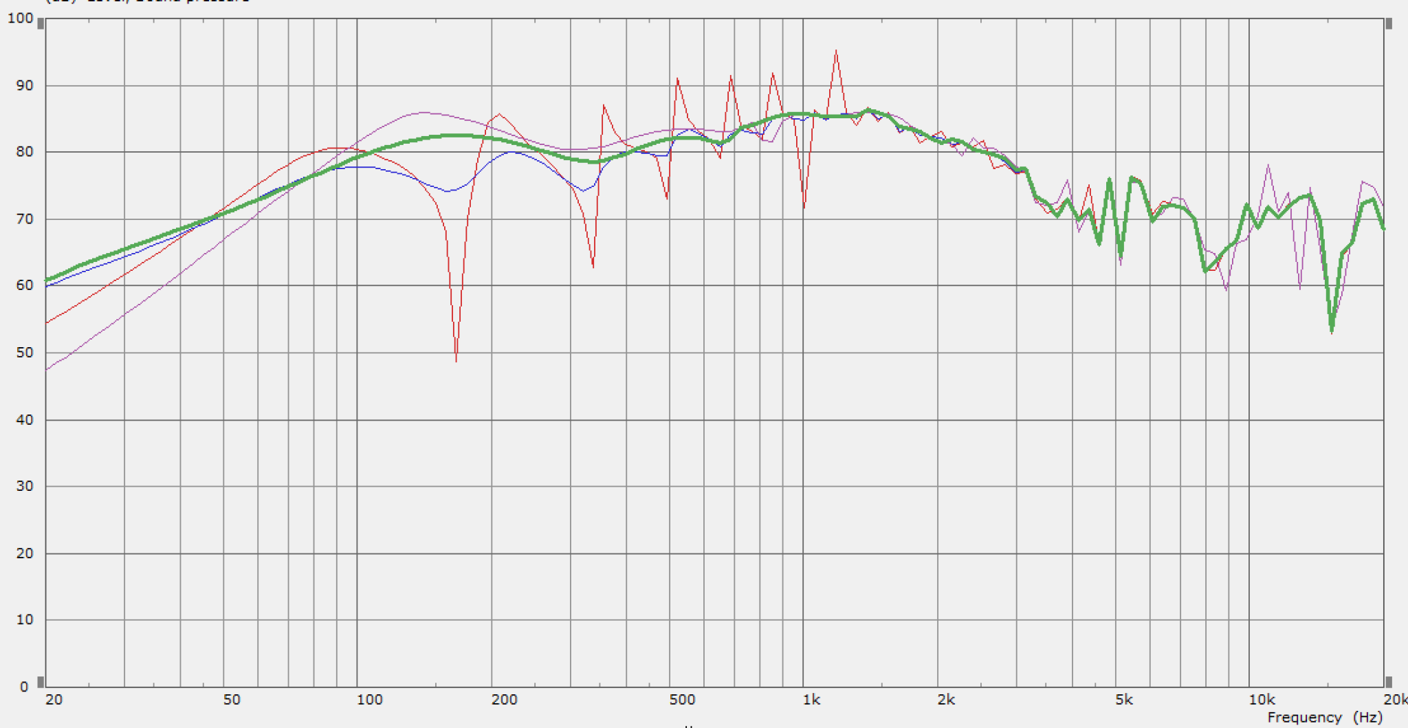

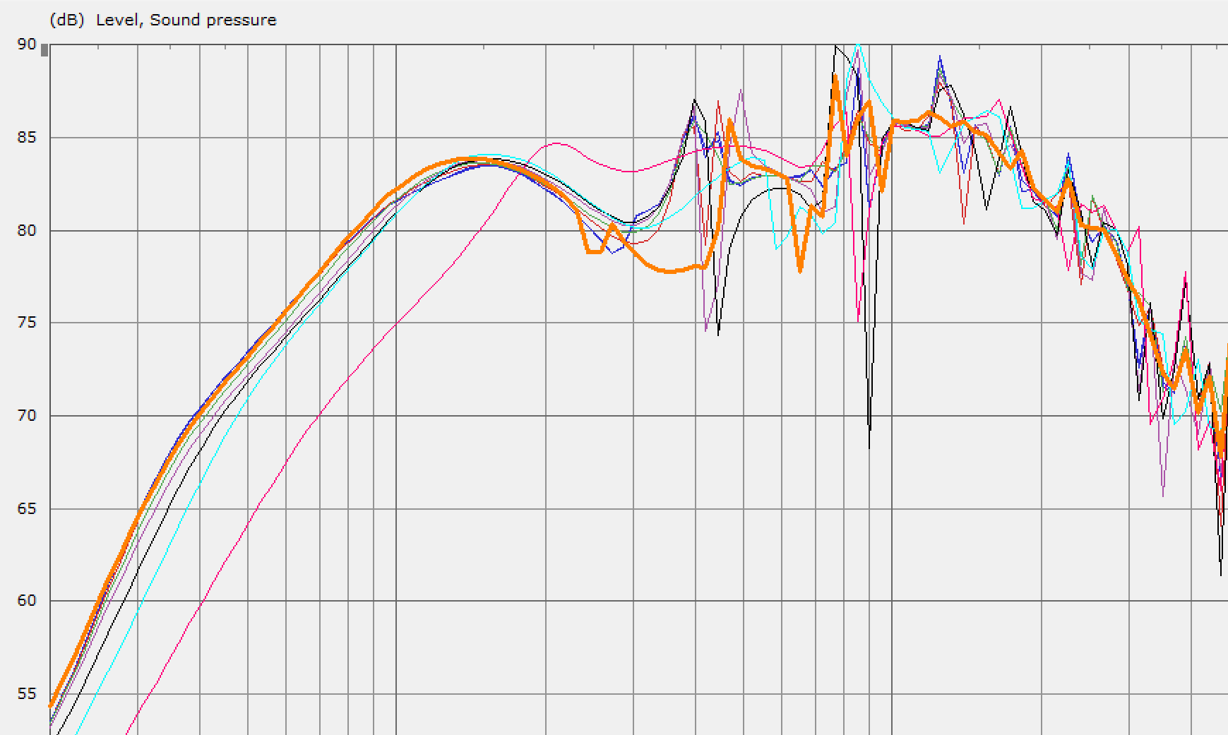

As you can see, I vary the concepts between: single big chamber, single small chamber with and w/o high pass (GHP), BR, simple TML, damping, different filters, different harmonic compensation (2nd, 3rd, 4th, 5th). Here are some FRs:
Also try, as you DonVK said, start simple from the start:
I can say, it is nice to see the different LF outcomes with different housings up to 600hz and its fun to see that complicated filters (that can be easily made with akabak) have the same output as simple closed or BR enclosures with enough volume. But, the -6db drop because of the line array could not be compensated w/o a change in enclosure design, an active push or a massive db loss between 100 and 5k hz.

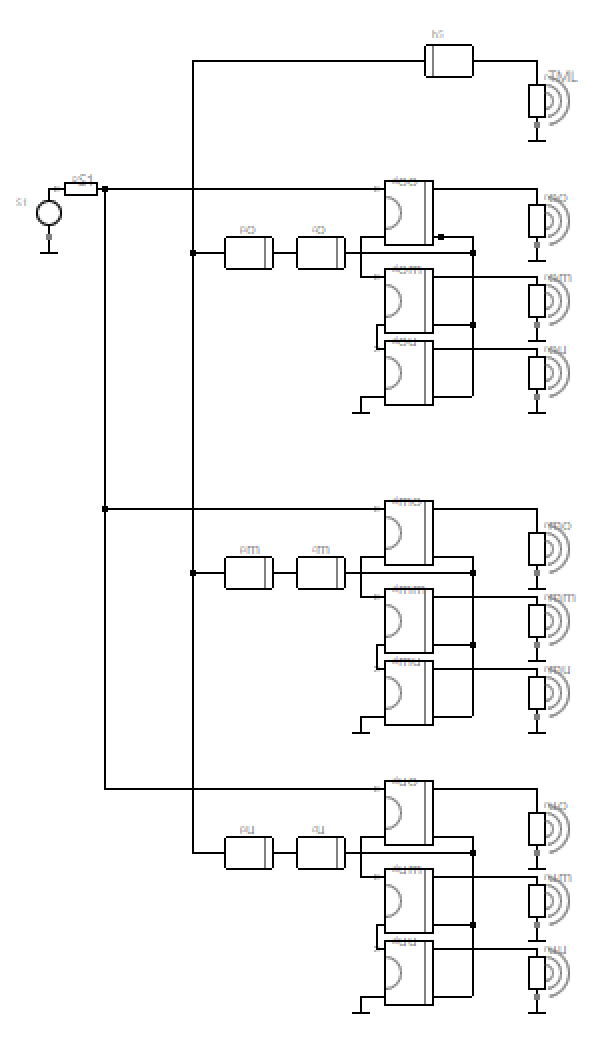

Here is a screenshot from the rebuild session and what is left, w/o all the passive components 🙂 :

Thank you for the offer to help, as I wrote, the main problem is the line array, that is not optimal for a linear FR 🙂
Overall thanks for all the response and input. It was fun and I have learned a lot about akabak and how to use it.

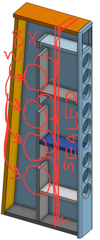

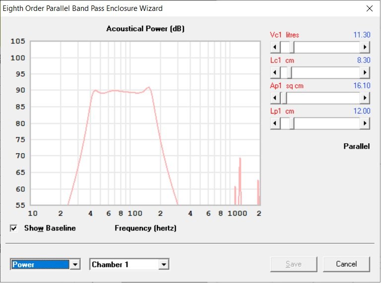

Another configuration suggestion, that would give you the look of small drivers in a LA. Similar electrical connection 3S3P as before, with 3 chambers in the enclosure. Just playing with some ideas 😀
Chamber #1 holds 3 series drivers internally configured as a BP8 (see attached graph) for the low extension. The BP8 should have a 1st or 2nd order LP to match the next stage. It will not play very loud (95db) before hitting Xmax. The alternative is to EQ boost the LF but the same Xmax problem occurs. These drivers are hidden internally, with a single exit port.
Chamber #2 holds 3 series drivers in a small closed chamber to deliberately limit the low freq output (see attached graph). This would have a 1st or 2nd order LP before the next stage.
Chamber #3 holds 3 series driver, each in its own sub-chamber to minimize HF standing waves. Two drivers have a parallel RC shunt to bypass the driver as the frequency increases to reduce the combing from multiple drivers at HF. At some freq (say 7Khz) one driver (middle one) is primarily acting a the tweeter, the other 2 drivers at reduced levels.

If you don’t need too much SPL, 4 drivers would work. 4 woofers in series parallel would get +6dB sensitivity at same impedance. There is a 10in version of the flat woofer but more expensive. More drivers may handle 600w but doesn’t mean you have to give it 600w. It still sounds better because cones move less and distortion is lower.
