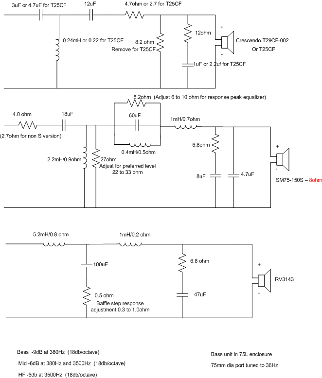

Hi
The ATC unit will actually give a 24dB/octave slope from 380Hz using a 2nd order filter as shown. I have tried a 4th order filter for the Volt but in practice this is not that important. What matters more is to shap the low pass filter to correct for baffle step and sound preferences. I have tried many different passive crossover filter designs over the past 2 years and the solution shown is the best so far. I have also used the non S version of the ATC and other than sensitivity adjustment the crossover works the same. The S version has higher power handling because of the higher sensitivity and also sounds slightly cleaner. Both versions sound amazing. Regarding tweeters I have used in this design the Morel Supreme, SEAS Crescendo and SEAS Mellennium. The SEAS tweeters sound by far the best with probably the Mellennium best of all, however, this tweeter has low sensitivity and is easy to blow up when played loud. The Crescendo sounds almost as good but with much better power handling so for my preference is the best choice. Regarding the Volt drivers I have tried both the RV3143 and B2500.1. I like the B2500.1 best of all but the RV3143 goes louder and has a warmer sound. Please note the crossover shown does not work for the B2500.
The ATC is best on a wider baffle, this reduces the EQU necessary. If you look at ATC's own designs you will see that the driver is placed off centre on the baffle where ever possible. This will also reduce the amount of EQU necessary. I intend to try this with some new enclosure designs. For a particular enclosure design it mabe necessary to adjust the 8.2 ohm resistor for best equalisation. A bit of experimenation will find the ideal value.
Hope this helps
Hope this helps

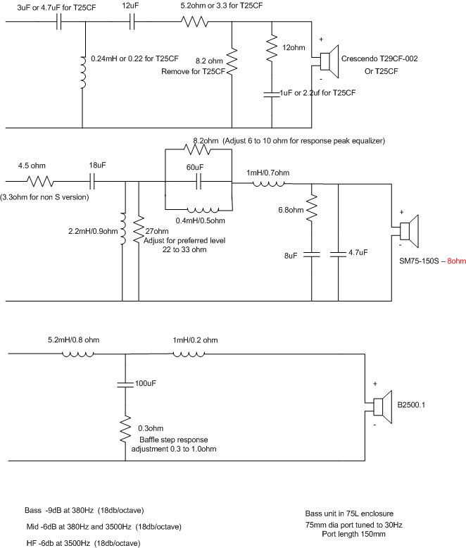

Spd,
Thanks so much! I would be interested in seeing the crosover you use with the B2500.1. I'm leaning towards that driver now. I like punchy bass, although the RV3143 sure has a look that garners oohs and aahhhs from those who have never seen it before. I guess the only other consideration, especially since the crossover is fairly low would be a 15" driver.
Hi
Sorry I attached the wrong version of my crossover design for the RV3143. See attachment for latest.
For the B2500 I only have a design which uses two bass drivers per channel. (2x 8 ohm drivers in parallel). Note: I also recommend that with either Volt drivers that the enclosure should be 60% filled with wadding.

ATC mid/Volt B2500.1 crossover
Hi
This is my crossover design for the SM75-150S and Volt B2500.1
I have not tested it with the non S version of the ATC but I have included component changes which should provide the necessary sensitivity adjustment. In my view the B2500 gives the best results compared to the RV3143. The bass goes lower and has far more control and clarity. Combined with the ATC the results are amazing.
Hi
