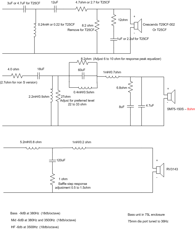

I have only used upto 4th order passive filters with these drivers, although the best sounding solution seemed to be 3rd order. The main problem was more to do with equalising the ATC unit and baffle step correction. The ATC is fairly easy to integrate with the HF unit. (I've used both SEAS and Morel tweeters). Bass driver integration is more difficult. The crossover points were:-
Bass LP -9dB at 380Hz (Allowing for baffle step)
Mid HP -6dB at 380Hz
Mid LP -6dB at 3500Hz
HF HP -6dB at 3500Hz
All filters -18dB/octave acoustic and all drive units connected in phase.
Note: The ATC requires equalisation as there is a response peak at around 1kHz

Spd,
Would you be willing to share your eq at 1khz for the 75-150?
I have a 3 way with Raven r1 / 75-150 / volt 3143 and I notice an edge in that 1k range. I don't think it is very high Q but sticks out in relation to the incredible smoothness of the ATC over the rest of it's range. Do you use a zoebel on either the ATC or your Volt LF? Thanks
Crossover Volt/ATC/SEAS
Hi
I have attached the crossover I use for the volt RV3143 and ATC 75-150S. I strongly recommend that the ATC unit be crossed over at 380Hz for best sound, however, this requires equalisation to remove a response peak at around 1kHz. For higher crossover points equalisation is usually not necessary but you won't be getting the best out of the ATC so don't do it. I have also indicated which components can be adjusted for fine tuning. The bass filter also allows for baffle step adjustment . The value shown (1 ohm) gives 3dB bass gain. (0.3 ohms is flat)
