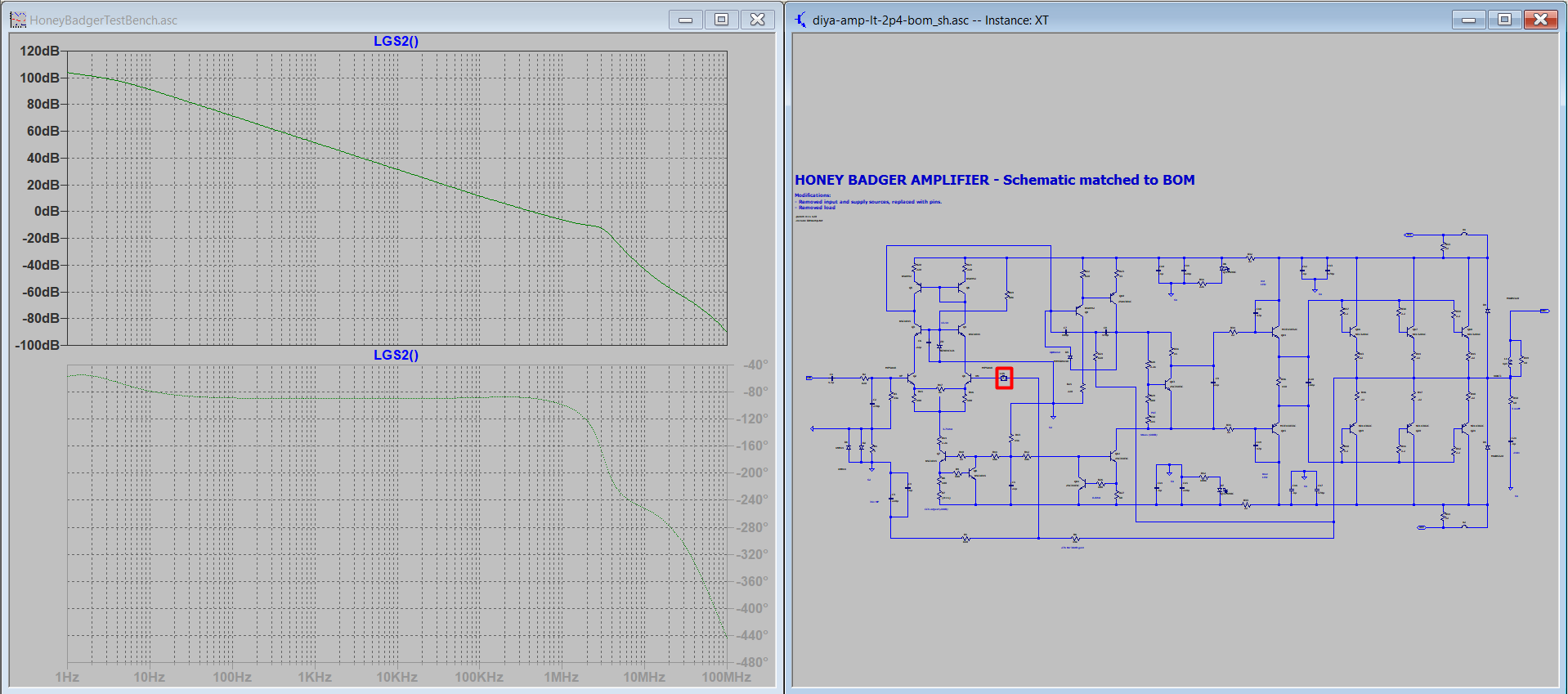

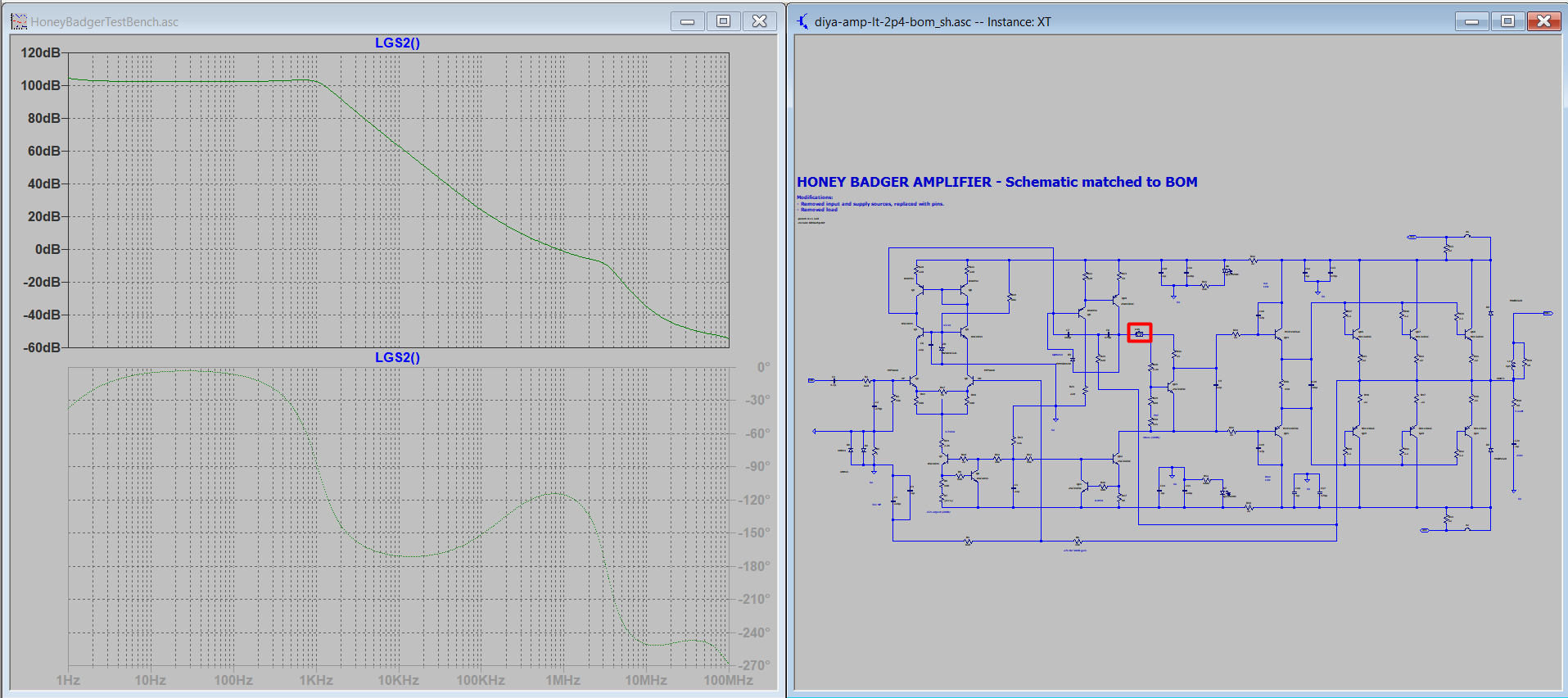

As promised in post #40, here is the simulation of my handwritten analysis...
I am using the HoneyBadger amp due to its popularity and its use of TMC compensation.

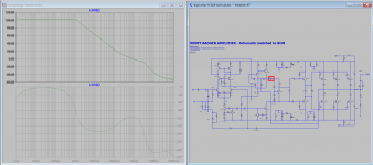

Screenshot_1: Shows the loop gain of the amplifier. The red square is the loop gain probe. As the handwritten analysis shows, it is single pole.
Screenshot_2: Shows the loop gain for OPS error voltage, what I call VE in the handwritten analysis. The red square is the loop gain probe. As the handwritten analysis shows, it is two pole.
With this, I have shown my analysis (handwritten doc also attached) and the simulation. I cannot show a 'lab result' since I do not own a HB amp nor the equipment to do the measurement (I don't own a network analyzer).

Can you show me a stand alone working TMC? I simulated that of dadod it is Tzzz.
I have seen absurd gadgets but this exceeds everything.
This is the circuit of your calculation.
I just simulated the HB amp, see post #41. Results agree with analysis.
I am unable to understand how someone pretending of engineering minded doesn't see the resistor and the capacitor are paralleled.
Iam trying very hard to accept 1+1=11
I have shown you in post #41 that '1'+'1' is indeed '11'.
(In many programming languages '+' is the concatenation operator, so '1'+'1' will give '11', where '1' is treated as a string and not a number due to the ' ' ... SQL is a good example).
With that, I am following my friend Dadod's footsteps and moving on to help others on other threads.
:wave: [Out of this thread]
The first graph is the good one , and thank you posting it. It shows one pole compensation falling 6db/octave before the undesired second pole starts at high frequencies, you finaly showed, TMS is a single pole. The second graph is done by breaking the feedback resistor, and you commit the same error as your friend dadod.
In your circuit ,the input current source flows it's current thru C1 because, voltage in, current out, element is very high impedance. By this you do not calculate the current ,If, as you do, it is the input , but the voltage that the input current developesby C1 + R//C2 along the feedback . There you could see the circuit if it has -Gm would be an integrator instead of an oscillator actually, but certainly not a two pole low pass.

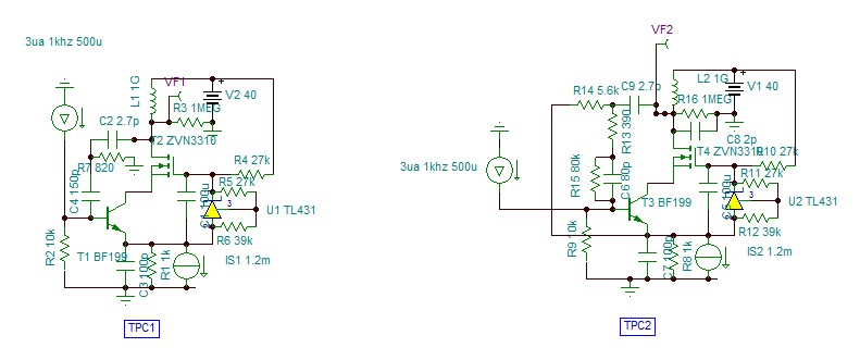

Summery

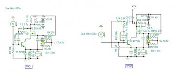

Analysis of different types of 2 pole compensation ,showed only the TPC , to be 2nd order bandwidth widener. The other types bear 2 pole title for other reasons. Dadod's OITPC , maybe, can provide a phase advance. I have in TPC2 resistor R13 does the same.
attachment.php
The TMC transitional Miller compensation is first order 6db/ octave. A Cherry compensation at low frequencies and Miller at High. The story doesn't tell us why not 100% Cherry ?If stability is a problem , a series resistor along the Cherry capacitor is enough.
The Cherry NDFL is not 2 pole compensation , but a 2 pole feedback. Only frequencies bellow 200khz are feedbacked from the output, by this the second pole of the output stage is eliminated from the feedback loop. TMIC is also a 2 pole feedback but more subtle technique.
