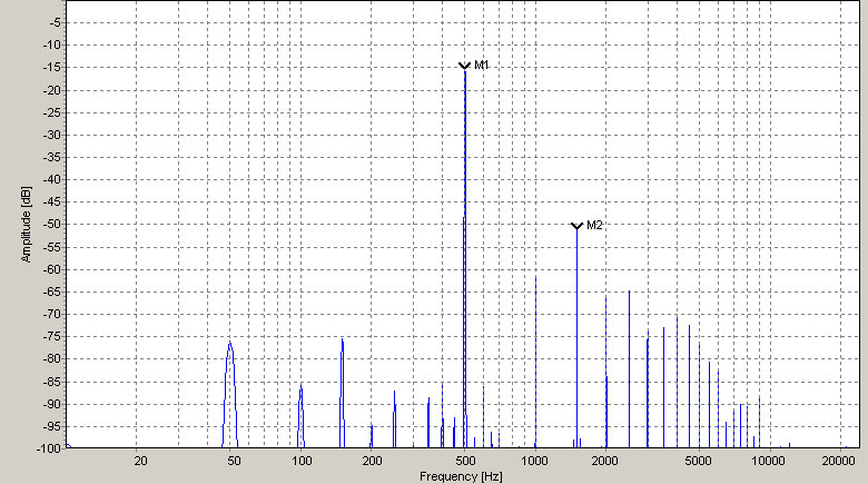

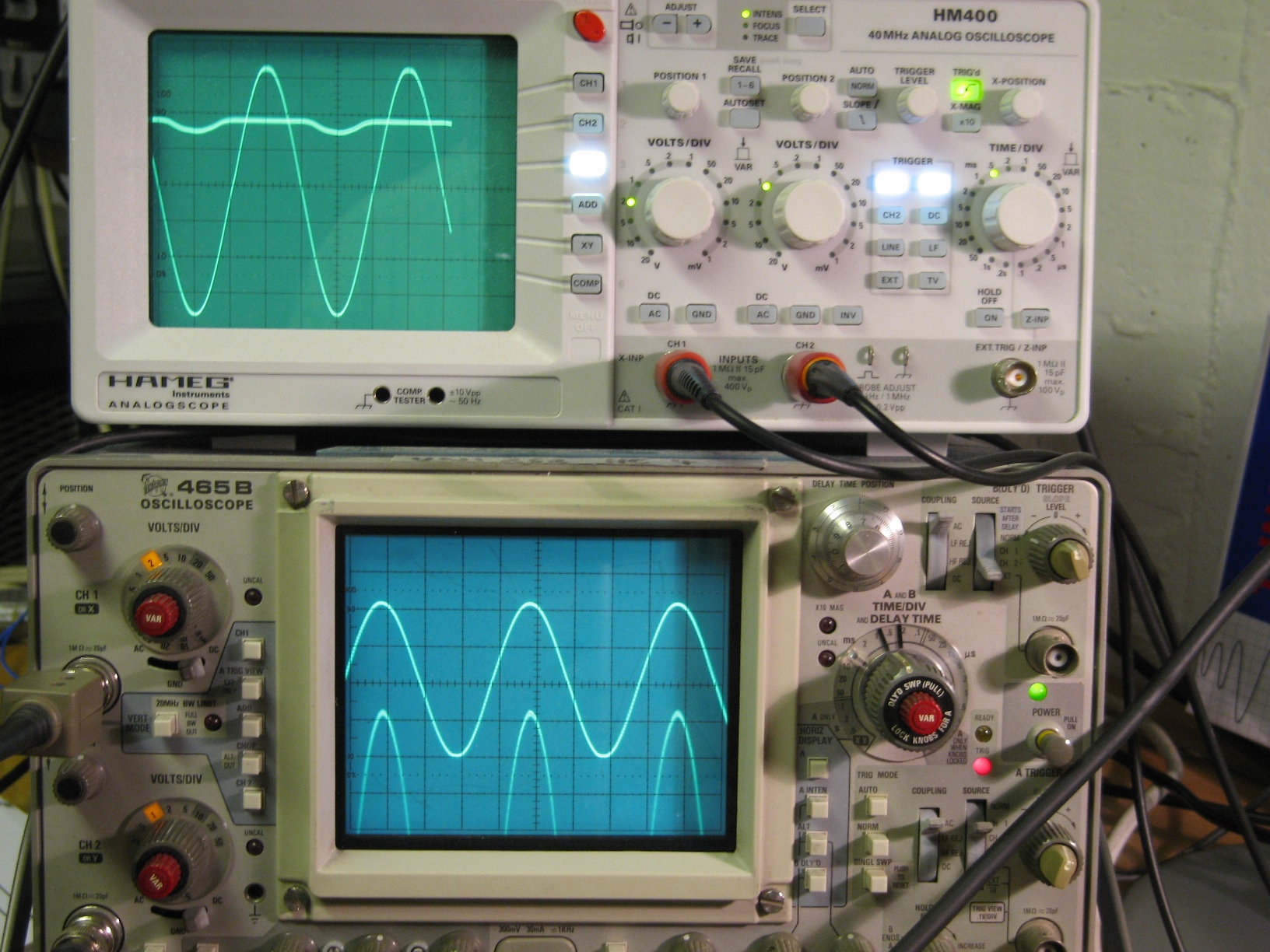

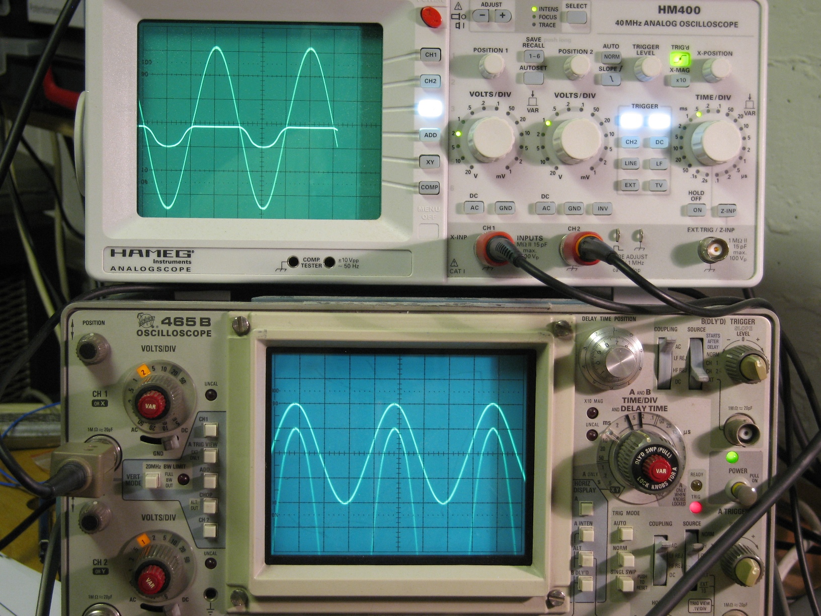

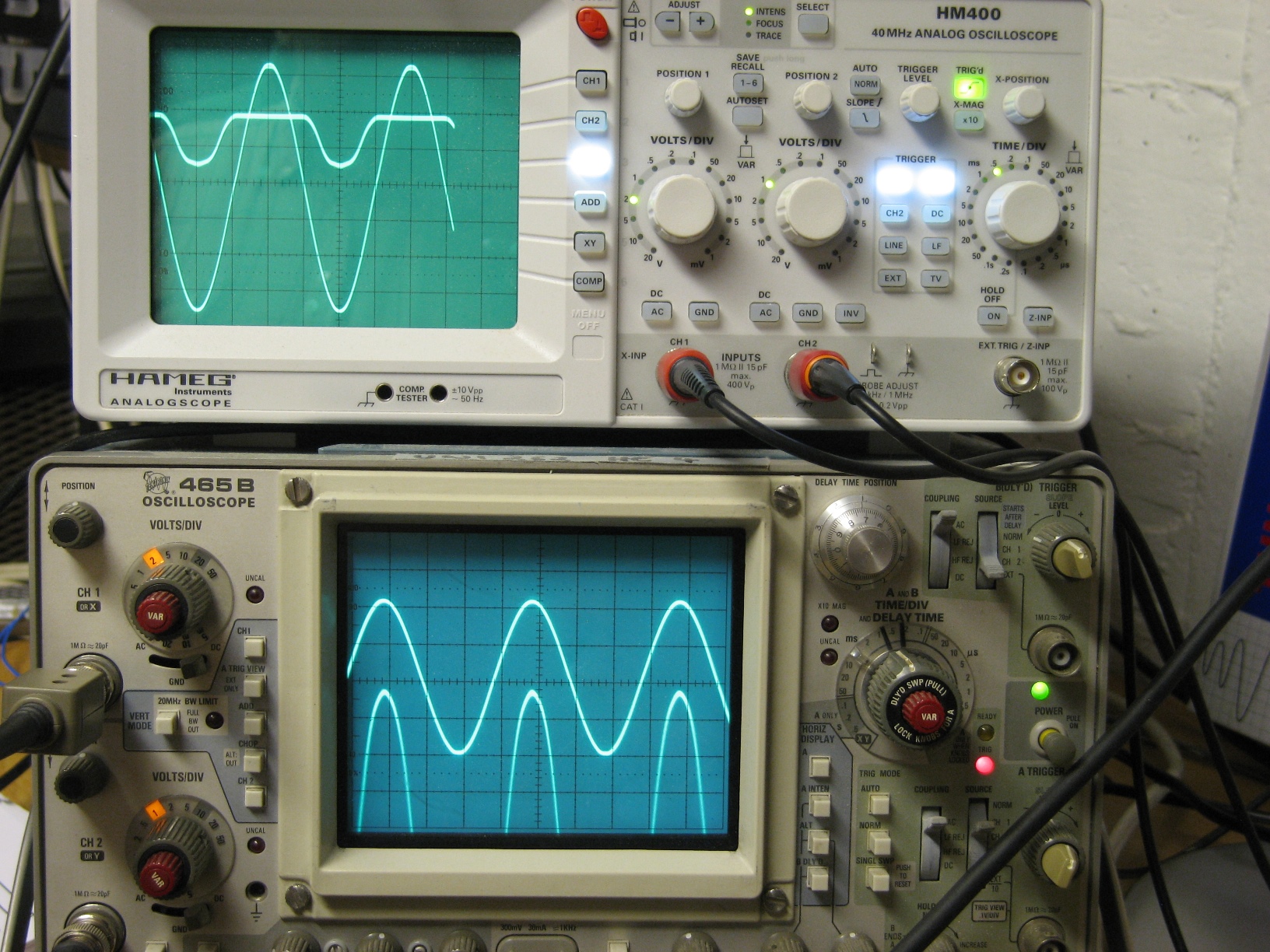

After some thinking how to proceed today I have done a comparison test with 3 different G2 configs, all with Raa=4K and Ik idle =40mA. I didnt go lower with Raa because I don't want to kill my tubes, especially the screens. If somebody else wants to test it with Raa=3K5, fine with me. All 3 configs are driven at the border of clipping.
case 1: Ub connection 800V, Ug2 connection 600V, Rg2=153 Ohm (1K//180Ohm)
case 2: Ub connection 800V, Ug2 connection 600V, Rg2=1K
case 3: Ub connection 800V, Ug2 connection 400V Rg2=1K
Attached are the 3 scope pictures, scaling and configuration are the same as in the first scope picture above.
We can see that the minimum plate voltage in all cases is about 80V. From my observation this behaviour will not change if we go to Raa=3K5.
To reach this minimum plate voltage we need at G1
case 1: -7V (AB1)
case 2: -3V (AB1)
case 3: +10V (AB2)
I personally prefer case 3 as it is much more safe regarding G2.

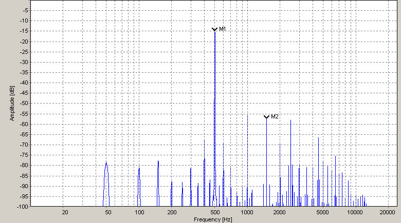

Attached you will find the screenshots of the analyser program for case 1 and case 3. I have calculated the THD up to K11, for case 1 its 1,4%, for case 3 its 1,5%.
Thats all for today.
Again, thanks for taking the time to test the limit of the tube. It appears that case 1 not only has lower THD than case 3, its 3HD is also a lot lower, so it may suggest that there are additional distortion generated with AB2 operation - the driver may be or could just be the tube... Anyway, with music instead of continuous sine-wave, case 1 may still be ok. Of course, I doubt anyone would build an amp this way without any safety margin... I still like your GU-50 design, lower cost and much more robust.
What is the max. output power with case 1: Ub connection 800V, Ug2 connection 600V, Rg2=153 Ohm (1K//180Ohm) ?
You're welcome!
It was just fun for me to test this tube. I have another Bass Amp with KT120 running 150W, one reason to start the test. One comment about powerstage in HIFI and Bassamp: Regarding frequency response and THD they are closely related.
I share your observation and comment about THD at AB2 operation. One root cause might be the change in operation of G1 when crossing from AB1 (G1 negative) to to AB2 with grid current.
I will do second test with SE config. I don't have so much experience in that area but lets see. It will take some weeks to create the bench.
Regarding GU50 (or FL152): personally its my first choice regarding reliabilty and stability ... and price.🙂

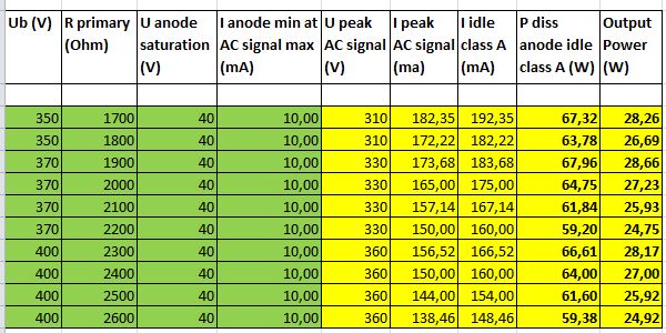

So, could someone give me an idea of what I might be able to get out of a KT-150 in a single-ended guitar amp application? My current project is using a KT-120 into a 2.5k load with 366V on the plate and 300 on G2, fixed bias, and I'm shooting for 22W. Would it be reasonable to shoot for 30 or maybe 35W with a KT150?
Thanks,
Joe
Thanks,
Joe
There is not too much detailed data available about the KT150. Based on my measurements it is an "extended" KT120. Here is a quick an dirty excel to roughly estimate the range of output power of a Class A SE. Input is Ub(V), Ra primary(Ohm), lowest voltage (V) of the anode when starting clipping and the remaining anode current (mA) at the positive AC signal peak. The calculation is based on a pure sine wave ignoring all nonlinearities. The output is the estimated output power, the resulting class A anode current and the anode power dissipation based on that current.
I have put in some configs.
Hans- Georg
Hans- Georg
I agree with the "extended" KT120 description, but I doubt it could swing as low as 40V in a real amp, so the output power is likely to be lower than those shown by es345. Other than its distinctive Gerkin look, a KT120 or even a KT88 would probably make more sense in a SE guitar amp.
