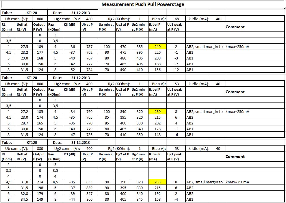

Caused by some agressive advertisement around the KT150 ("up to 300W out of a pair in PP") I have made a quick evaluation of that tube and compared it with the KT120.

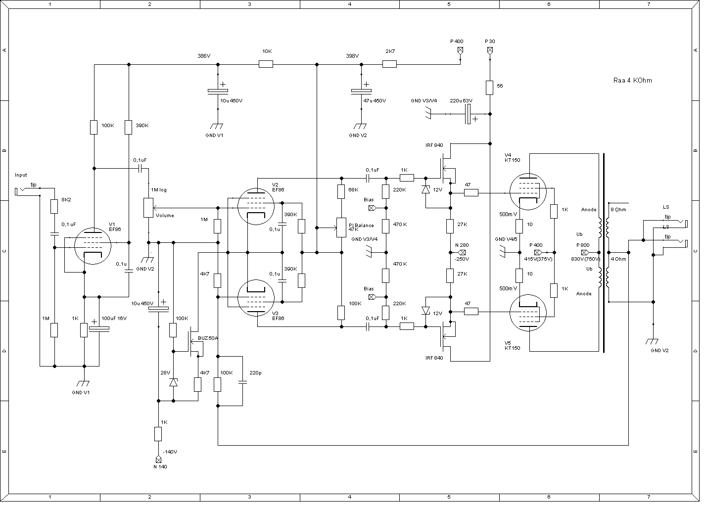

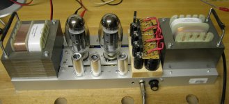

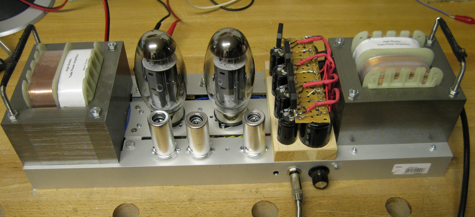

I have used may PP powerstage bench - picture and schematic below - able to drive AB1 and AB2. The OT (250W, 20Hz-20KHz , - 3db points) has Raa=4K and speaker output of 4 and 8 Ohm. Using the 4 OHm connection and a switchable high power load in steps of 0,5 Ohm - picture below - I am able to measure the max power before clipping starting e.g with Raa=3K up to Raa=8K in steps of 0,5K.

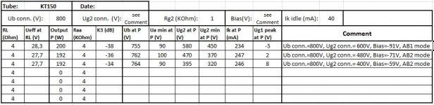

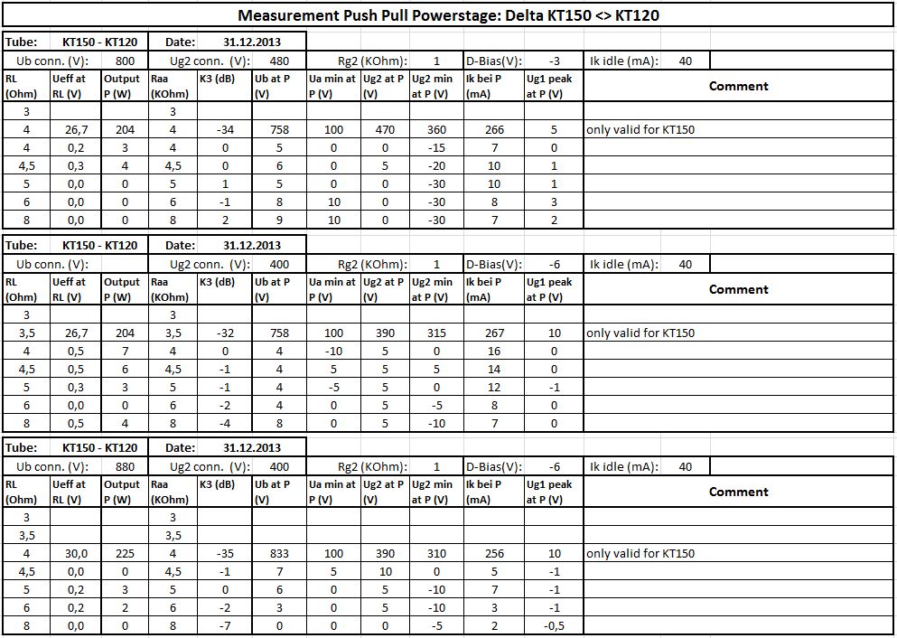

I have put the results into 3 tables: KT150,KT120 and the difference between the results.
Some remarks and explanations:
- The evaluation bench is not a state of the art design It is for evaluation purpose only and without protection elements inside.
As an example you can easily evaporate G1 if you want ...
- Ub connection: "nominal Voltage" at OT, in Idle higher , at full power lower due to SAG
- Ug2 connection: "nominal Voltage" at supply of Rg2, in Idle higher, at full power lower due to SAG
- screen resistor 1K separate for each tube
These topics have been measured at 500Hz
- output voltage at full power before clipping
- K3: signal Ratio of K3 (1500Hz) to K1 (500Hz) at full power
- Ub at full power
- Ua min: lowest plate voltage during sinus cycle at full power
- Ug2 at full power
- Ug2 min: lowest screen voltage during sinus cycle at full power
- Ik: average cathode current of one tube at full power
- Ug1 peak: the highest voltage at the control grid at full power

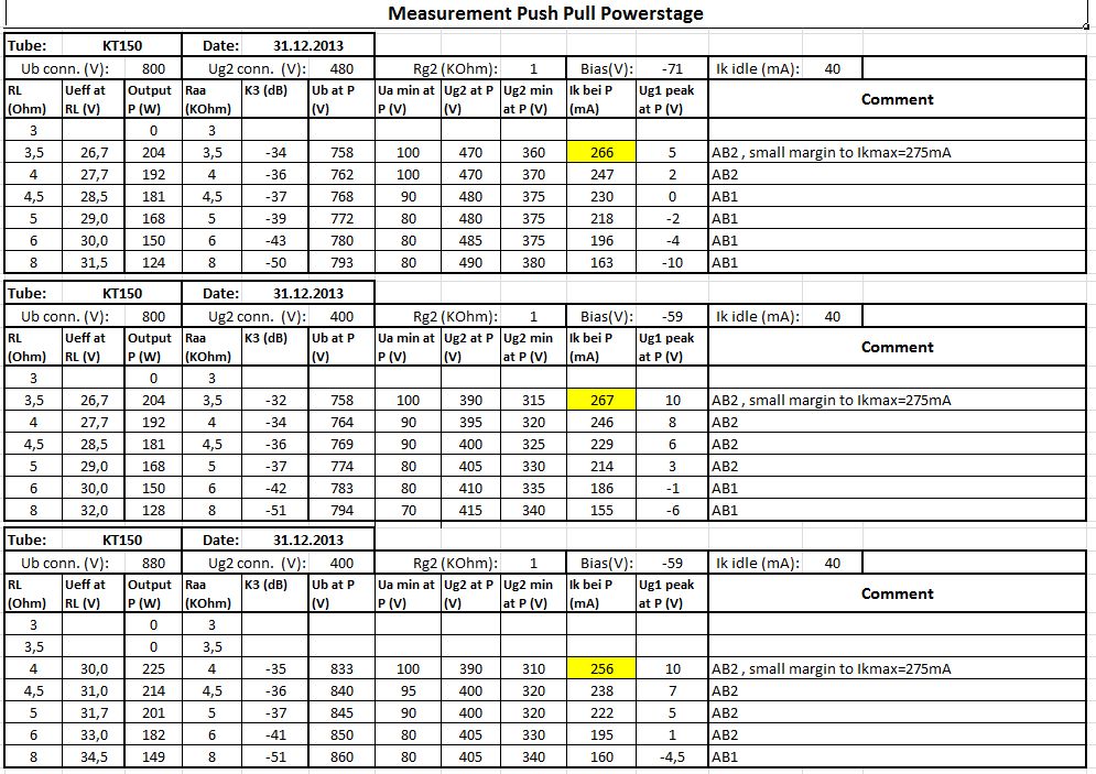

My observations up to now:
- from my experience a maximum power of 300W out of KT150 PP seems not to be reachable. 220W looks "ok". With an OT having very low DC resistance at the primary up to 250W might be reachable but without any margin.
- the difference between KT150 and KT120 is small which I have somewhat expected: same manufacturer, the tube is just a little bit "extended". The shown difference might even come from the variation in production.
- Due to the higher limit of Ik (275mA versus 250mA) for the KT150 2 more configs with higher output power are possible.
- the warm up time of the tube is about 2 min - very long compared to e.g. GU50
Thats all for the moment.

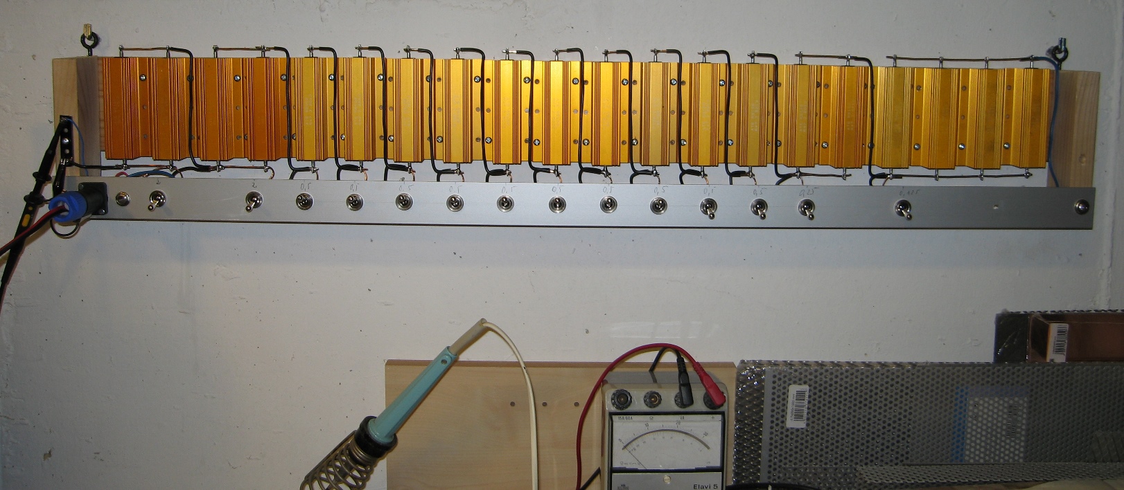

Love that resistor array. Wanted to build a similar thing, but in a R2R fashion, means a 1, 2, 4, 16, 32, 64, etc. resistor chain. You can constrcut any resistance with that.
Basically a good idea. But: You'd need BCD switches that are able to handle rather high currents. Not easy to find, especially in these days.

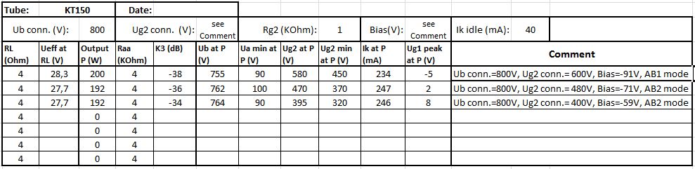

A couple of observations. The screen grid resistor ( 1k ) seems to be too big if maximum output power is a goal. The voltage drop across it is noticeable.
The screen voltage should be quite constant. Some 100 ohms will give essentially better result.
Secondly, the max. specified screen voltage is 650 V, but you have used only 480 V. This will also limit the max. power a lot.
The 650V g2 rating is likely just for the triode/UL operation.

As a summary what I have tried to say:
The test above does not fully describe the full potential of KT150, because there seems to be such limiting factors as too high screen grid resistor and possibly too low screen grid voltage.
When those will be eliminated and new tests done, then we could have valid test results.

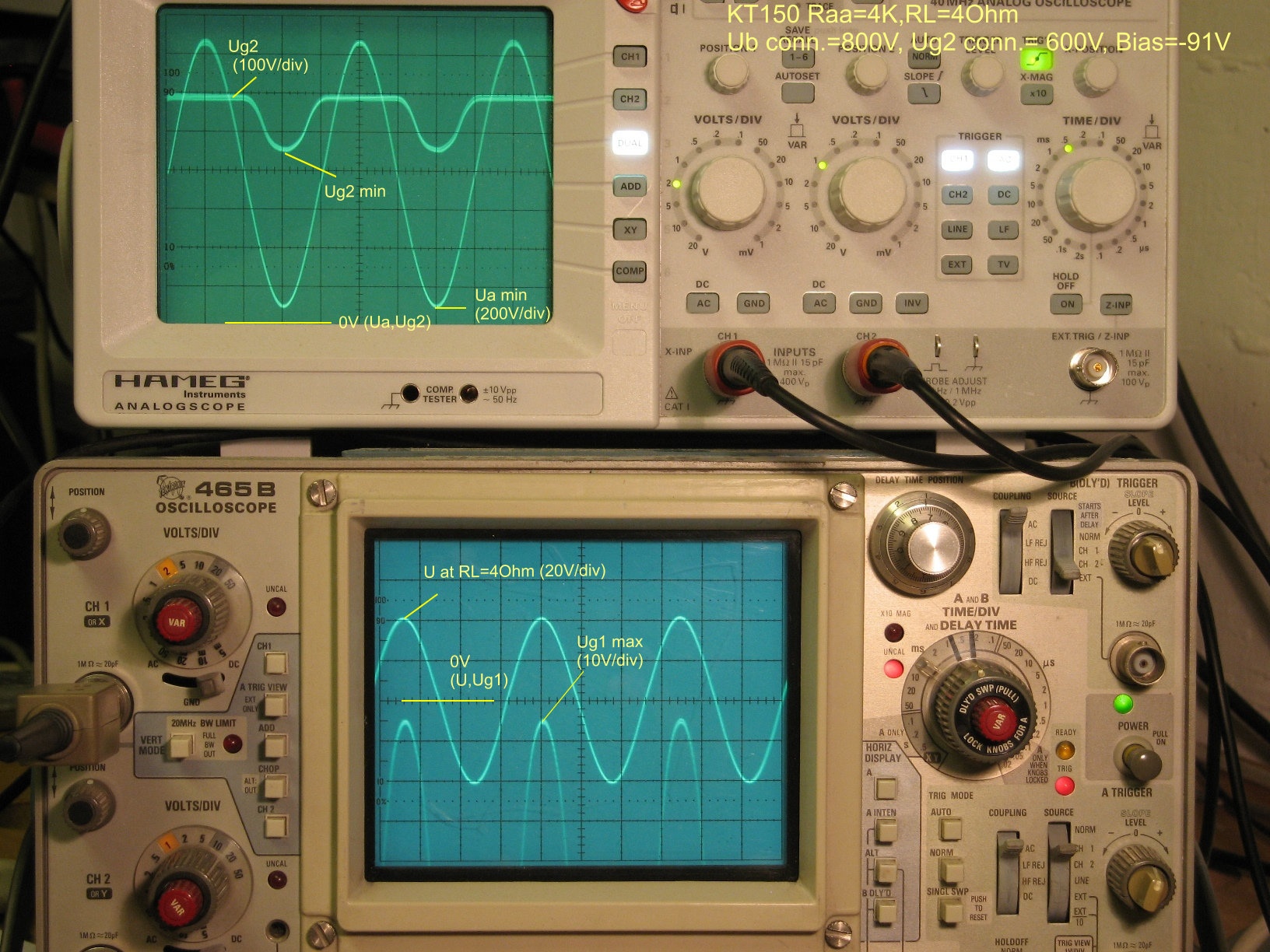

Some explanations and comments.
1. Dependency of the max output power from screen supply (g2)
In the scope picture attached you can see the definition of Ua min and Ug2 min. In the table attached you can see the output power with a Ug2 connection of 600V, 480V and 400V. The reachable output power is nearly the same, but the operation mode is shifting from AB1 to AB2 mode. If you don't allow AB2 at lower G2 supply then the maximum output power will decrease with lower G2 supply.
2. Rg2 = 1 KOhm.
Let us have a short estimation, not precise from model and mathematics but from my opinion good enough to estimate the G2 power dissipation for the case shown in the scope picture: Ug2 at 600V connection.
During inactive phase of the tube G2 current is 0 therefore the voltage at G2 is the same as the G2 supply at the other side of Rg2. During the active phase the G2 voltage is following a curve like a sinus. The average voltage at the Rg2 resistor is (Ug supply- Ug2 min)/2, this is the midpoint of the sinus. In the excel attached I have calculated the average power dissipation for the screen G2 supplied with with 600V, 480V and 400V.
The result is that the 600V config is overloading G2 at full power (15,7W) - which fits to the observation that the inside of the tube the colour is changing to red.
