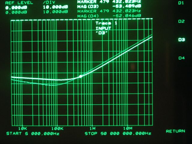

Look at this graph, it's not a quote, I can repeat it any time [the 1ohm ref line is at -28dB, the bottom of the curve at 100kHz is -57db for the simpler cap, that is 35mohm at 100kHz, and will rise to 1 ohm at 11MHz!!! all this at 50V rated voltage.
Other than 1ohm at 3kHz..
Ciao, George

Hi HiFi- That big low esr cap is performing the way you think only in your dreams and in the marketing people's special world. A vector impedance meter or HF bridge tells all, and inductance gets you way before 100kHz. Here are a couple things that will help, but IMO nothing is as useful as measurements.

Oops, forgot that maybe one should registrate to see the pics.. Though it definitely worth the pain..🙂
Here it is, a different meas., same cap, this time from this same forum:
http://www.diyaudio.com/forums/showthread.php?postid=549338#post549338
or the pic re-attached:
Anxiously awaiting my return email from the registration, but the pic helps until then. Can you give me the details of the instrument and set-up for the test?
