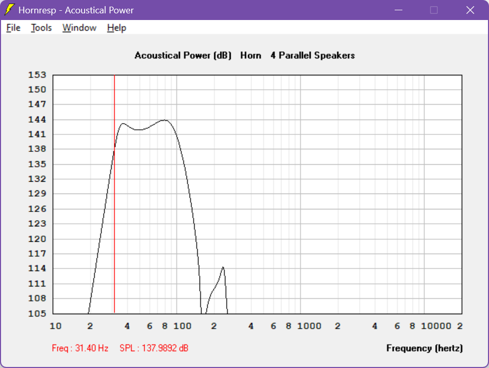

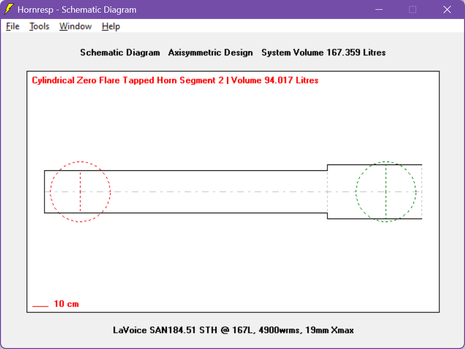

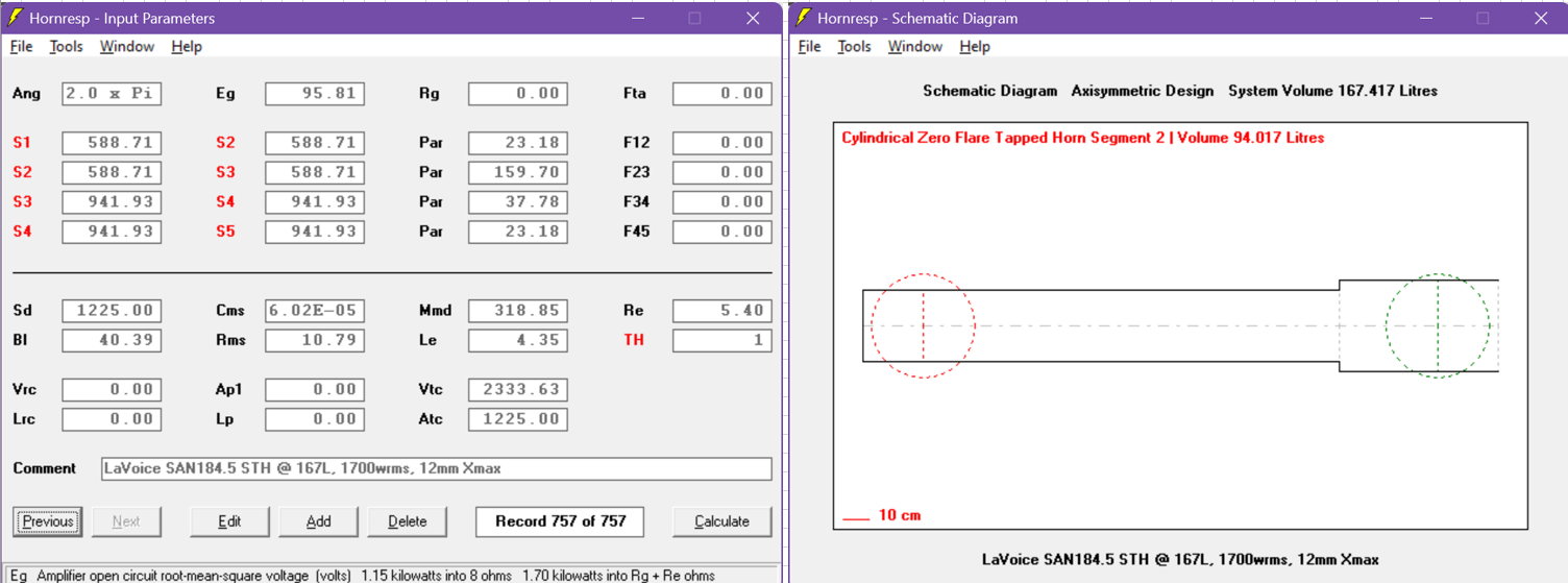

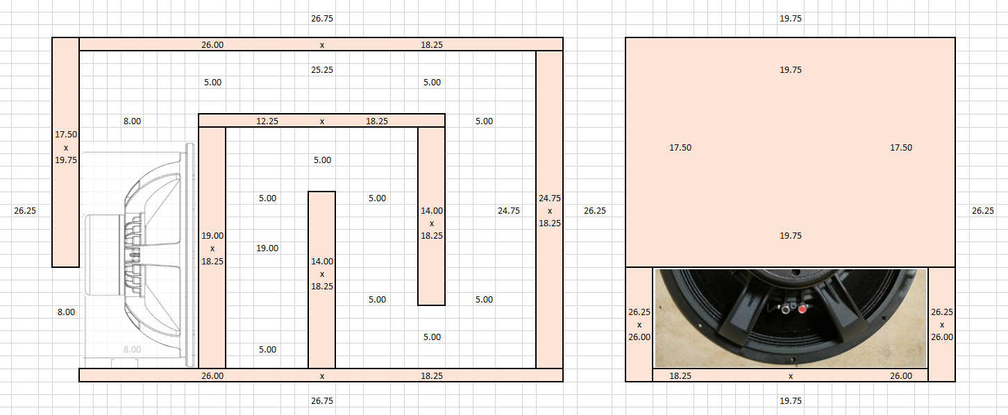

You might be right about the driver fitting. In trying to do a quick model, I only thought about the 6.61" driver mounting depth and not the total driver height. In a 4 segment TH, S3 probably needs to be 16" x 6" and S5 needs to be 16" x 8" to fit the whole driver height. Let me play with the model.
Well, that's one way of doing things. Although it is nasty, it gets temptingly close. I could argue for and against, but it would yield no good outcomes. The question is how to motivate oneself to try that, and do all the measurements of power compression and such.

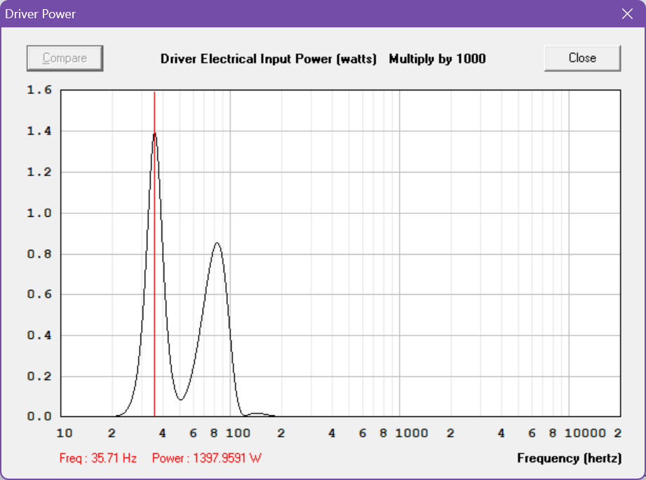

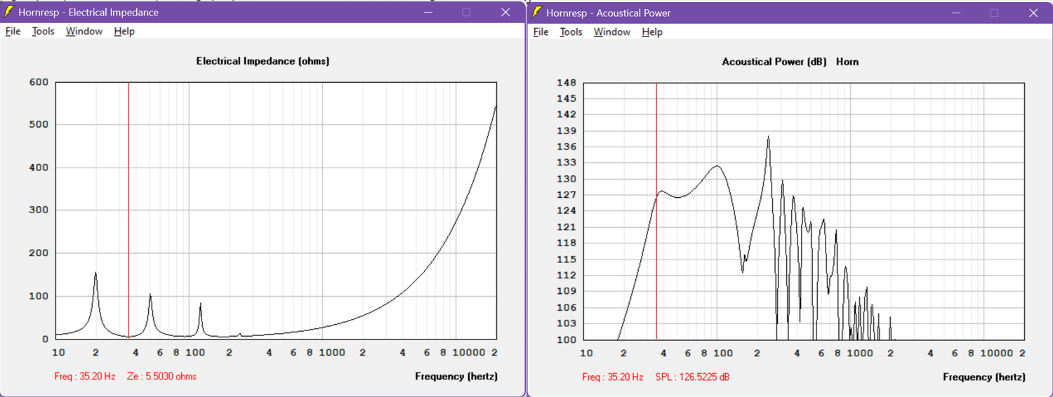

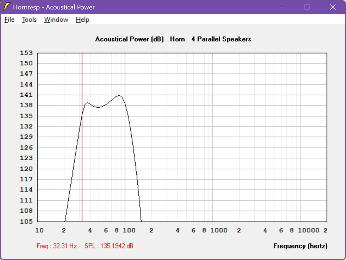

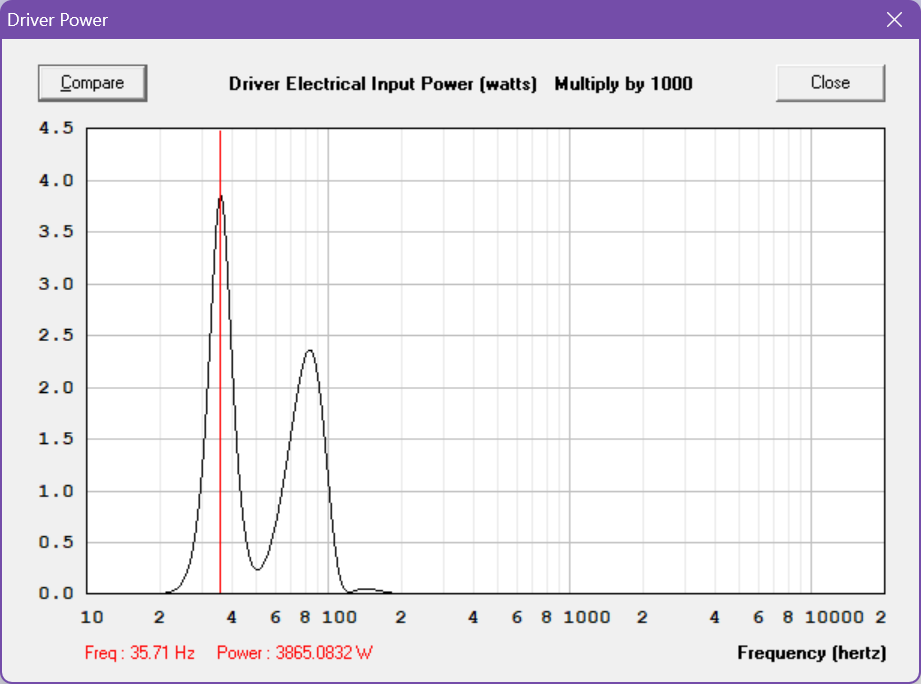

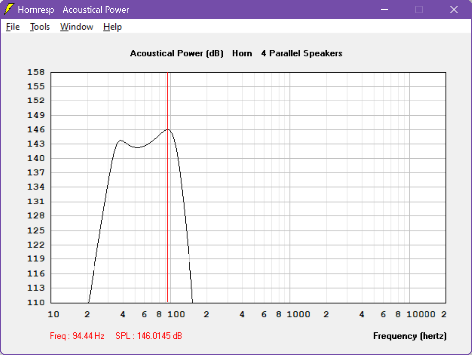

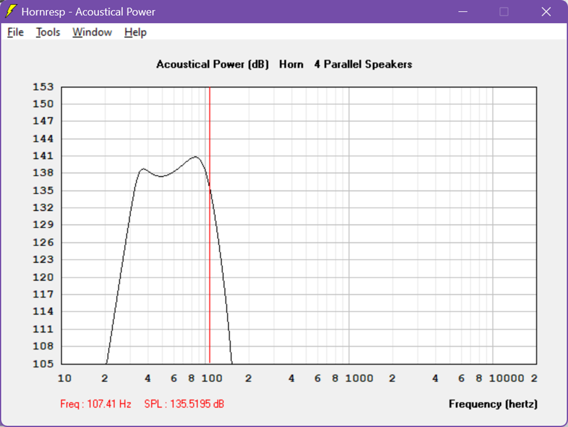

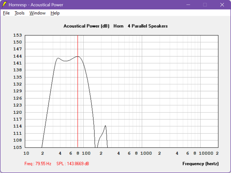

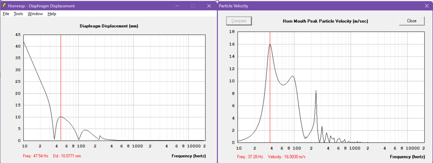

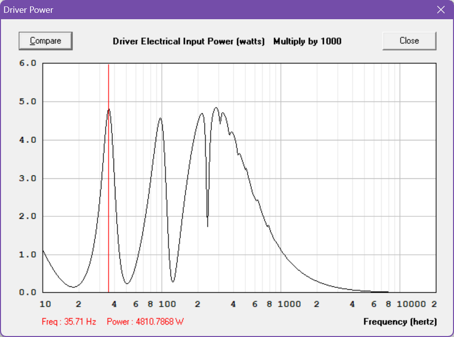

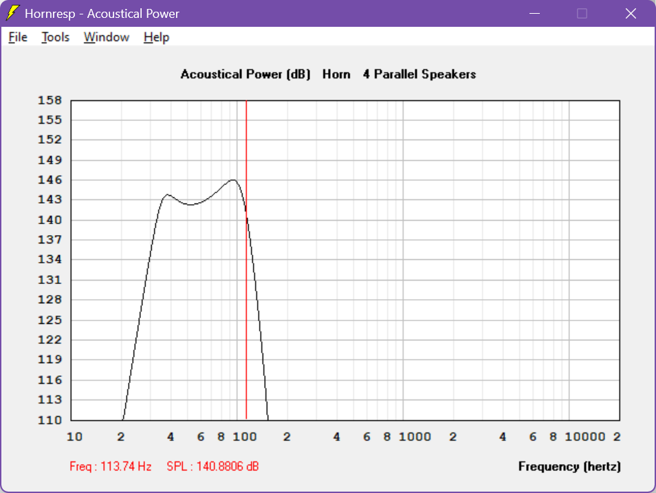

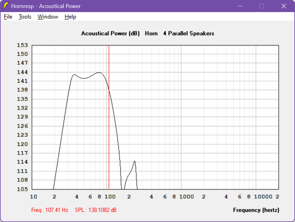

That's basically two dB gain in SPL, but I don't know how would it fare power compression wise. Can you share power input plot too?

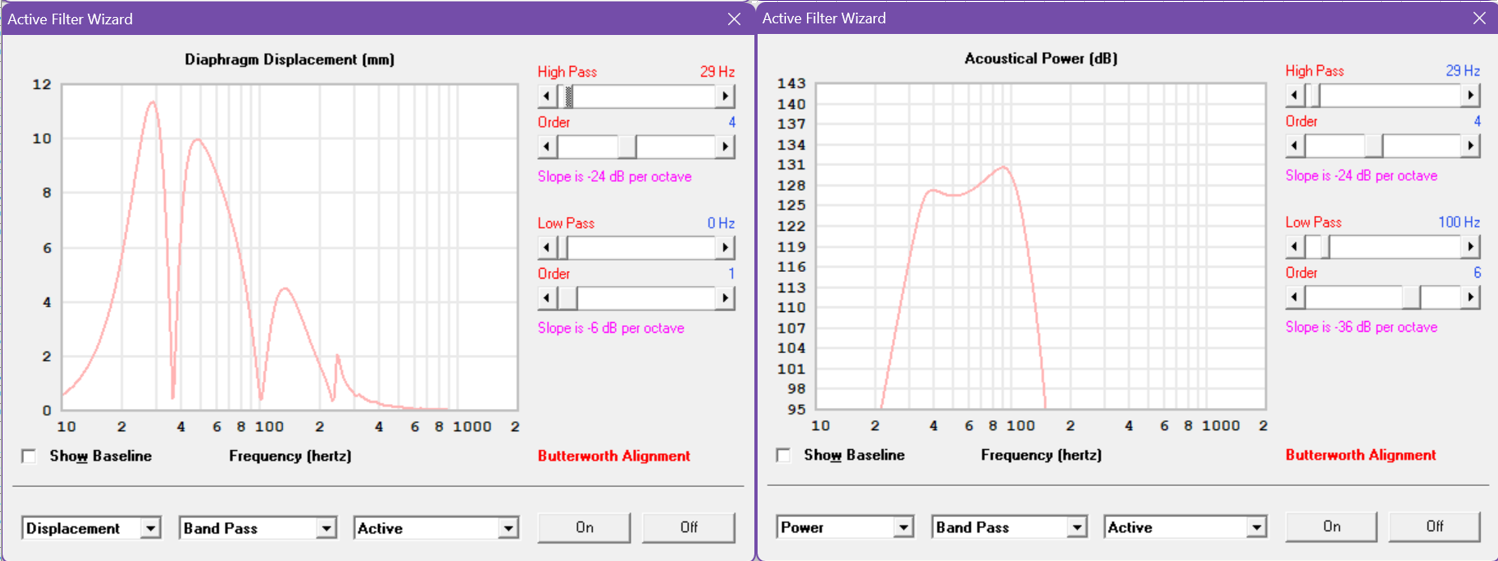

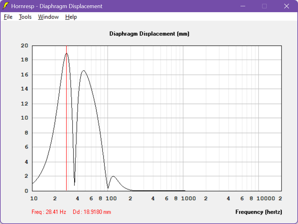

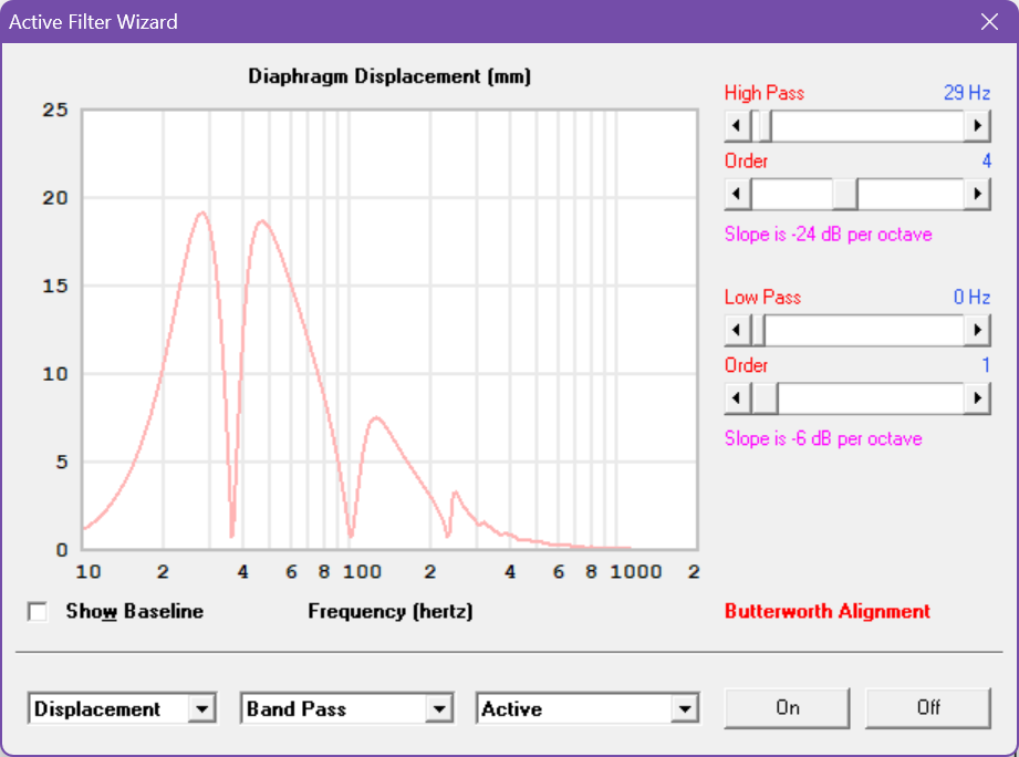

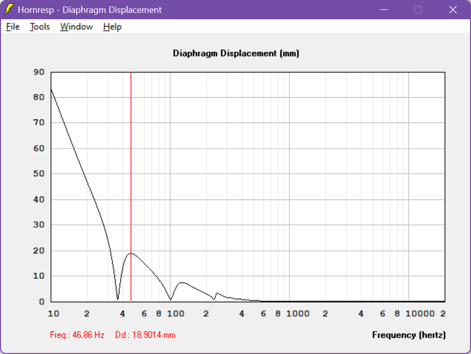

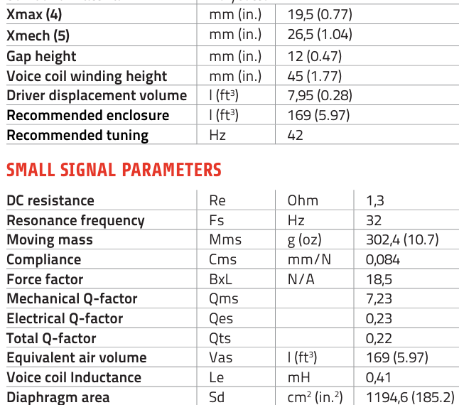

Also, I am now excursion limited by the baseline speaker. Once we put the same power but Xmax 19mm+ one (existing) in my design, it might even out, while sitting in the 10% smaller box.
"These are hard battles" for the one last dB in a simulation. It needs so much work to get to know the truth, aaahhh.
Where are you getting the 19mm Xmax from?

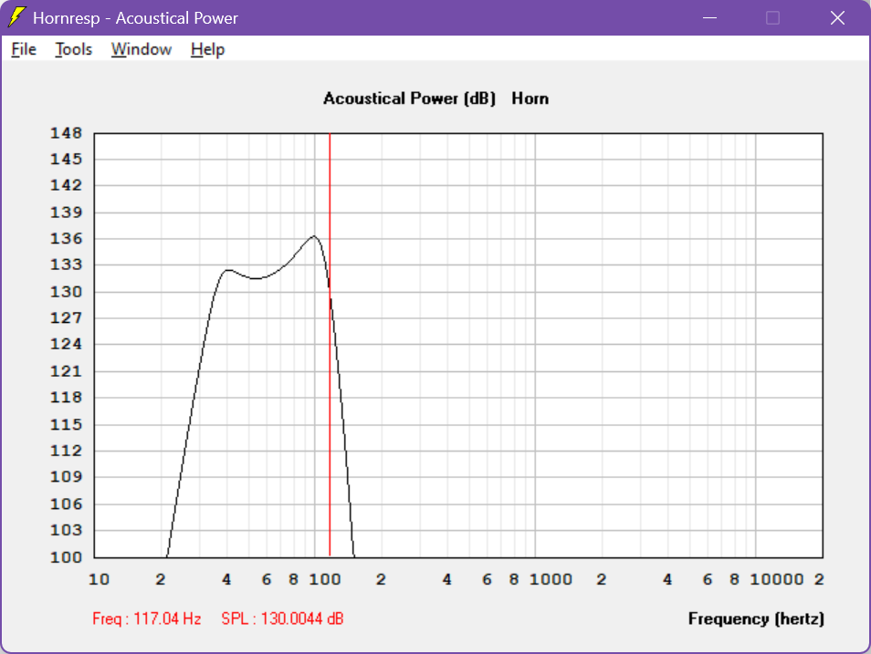

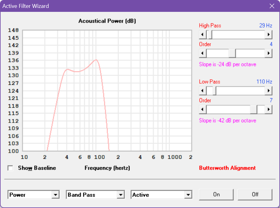

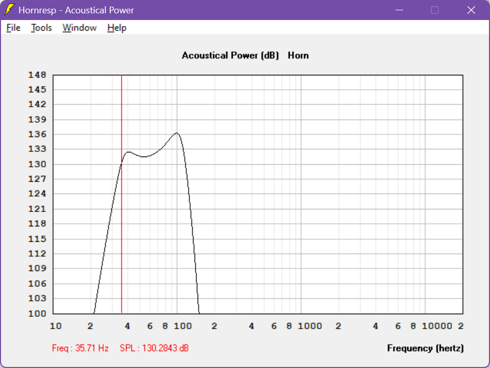

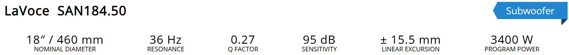

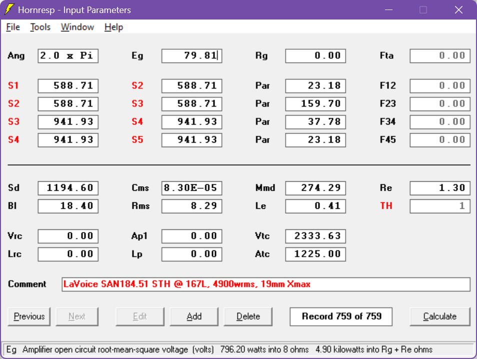

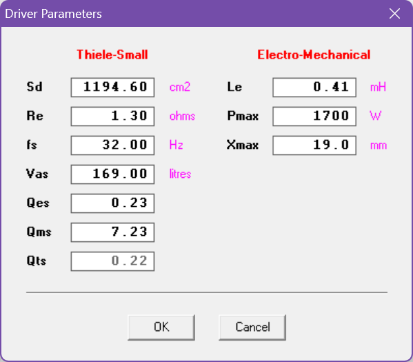

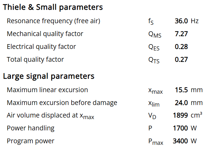

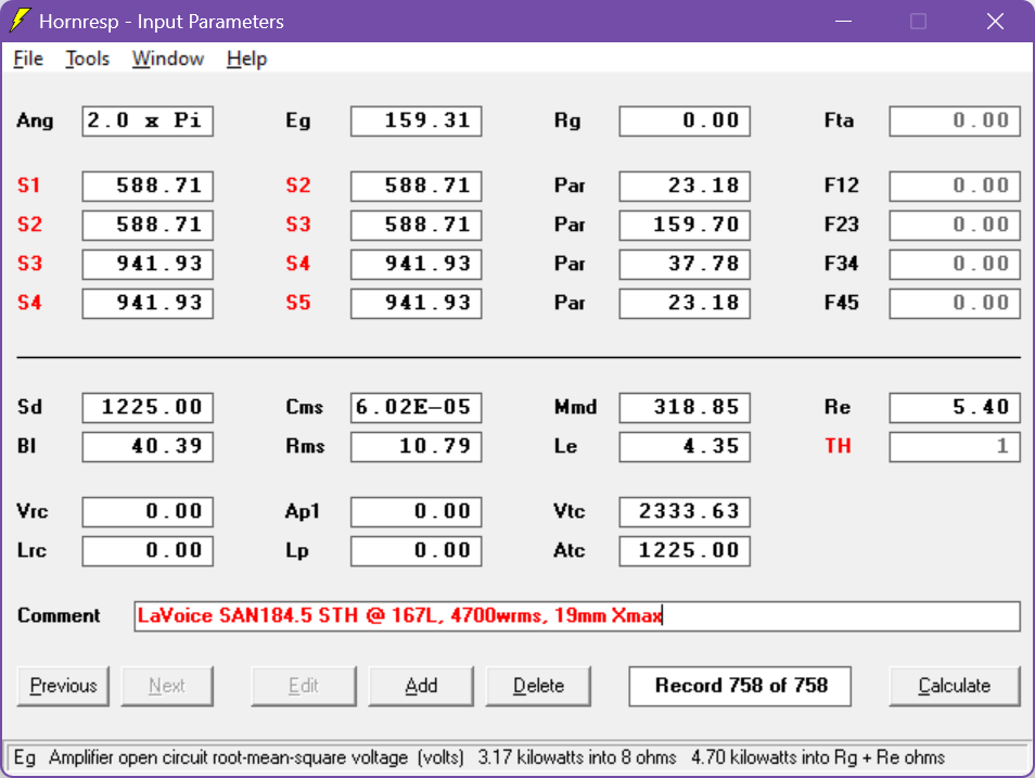

SAN184.51. Same power input, 5/10% weaker motor depending on how you classify it, and 19,5mm of Xmax. That would almost solve my design problem, but I decided to wait with something else that might pop up. Not sure what.
https://en.toutlehautparleur.com/media/catalog/product/datasheet/lavoce/SAN184.51-2.pdf

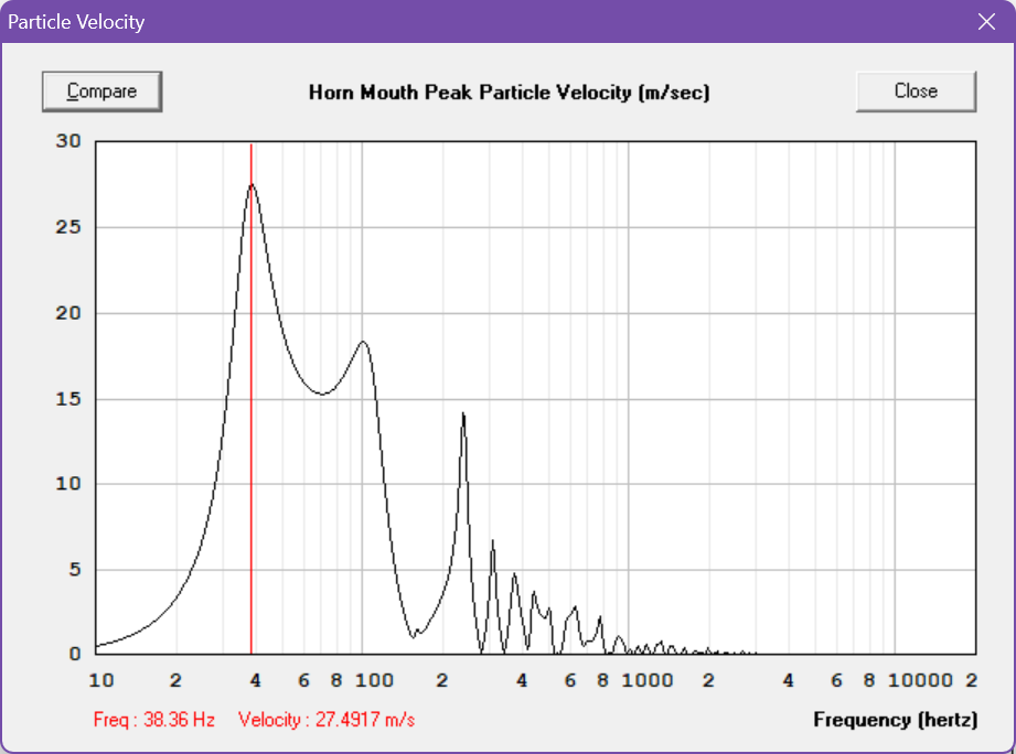

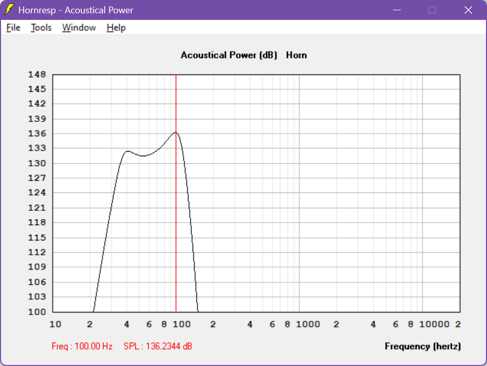

Yes, that´s where the design would fail my needs and scope. but not in the bassreflex one. In heavy duty use giving it nearly 4kW in bass and 2kW in high range of the bass would make that speaker smoke in under two minutes. I think it is toe to toe. I would be inclined to test another design, but it stacks up. Bigger box volume, unfavourable impedance, magnet out for audible noises, magnet blocked by front wall, speaker mounting, front wall durability issues. That´s quite too much.Here is the 19mm Xmax model.
Yeah, that wouldn´t fly. 🙂
All kinds of compressions through the roof, speaker almost instant toast. It was meant as an aid for my design limitations solution. For TH, it will probably do nothing. And it has weaker motor, so maybe 184.50IP would be better choice, I don´t know. But all these are hard to feed.

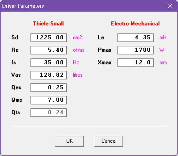

Money is somewhat a constraint, but not totally. IPAL is as guilty of low Xvar as any other driver. Would need full IPAL solution, and I am not going that way with proprietary (and loud) HW (meaning working noises).
The LaVoce SAN184.51 is much closer. Still feeding is somewhat difficult and it has weaker motor.

Not really. Or rather Back To Earth. Probably 3-4dB more output where it matters to me, and 3-4dB less where it "doesn't". The point is little more steady output and more linearized output (by 6-8dB in total), while conventional designs go for peak SPL at the cost of sustainability in time.
Not apples to apples, mine should be tad smaller and lighter.
