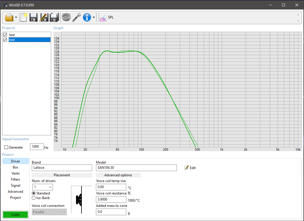

If you insist on building reflexes, do it. But think about what i said about overheating and compression. The lavoce actually sims better (in WinISD at least) than that expensive 18sound i think, and would be a good candidate to try. That is true. But you will need a huge port for that to keep the air velocity low enough, so your cabinet will end up arround 250L in total anyway.
This is a quick sim of both in a 200L ported at 4kW with filters like you probally should use (8th order hpf at 20Hz and 4th order LPF at 100Hz). The thick line is the Lavoce.

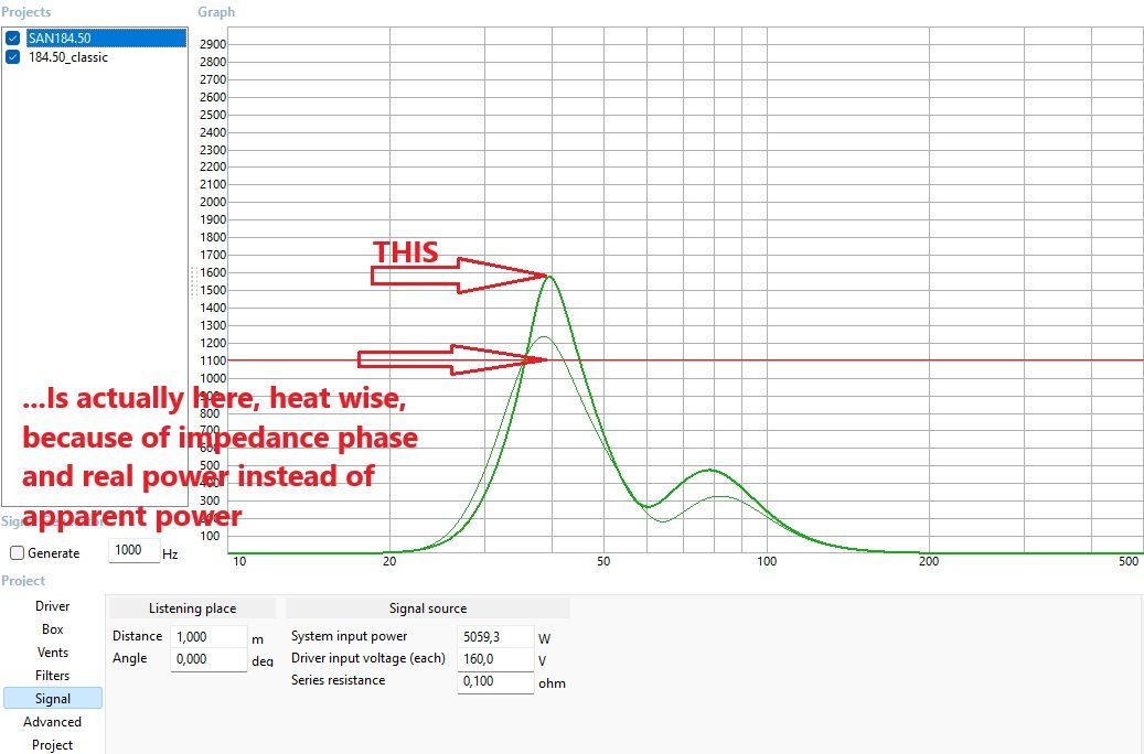

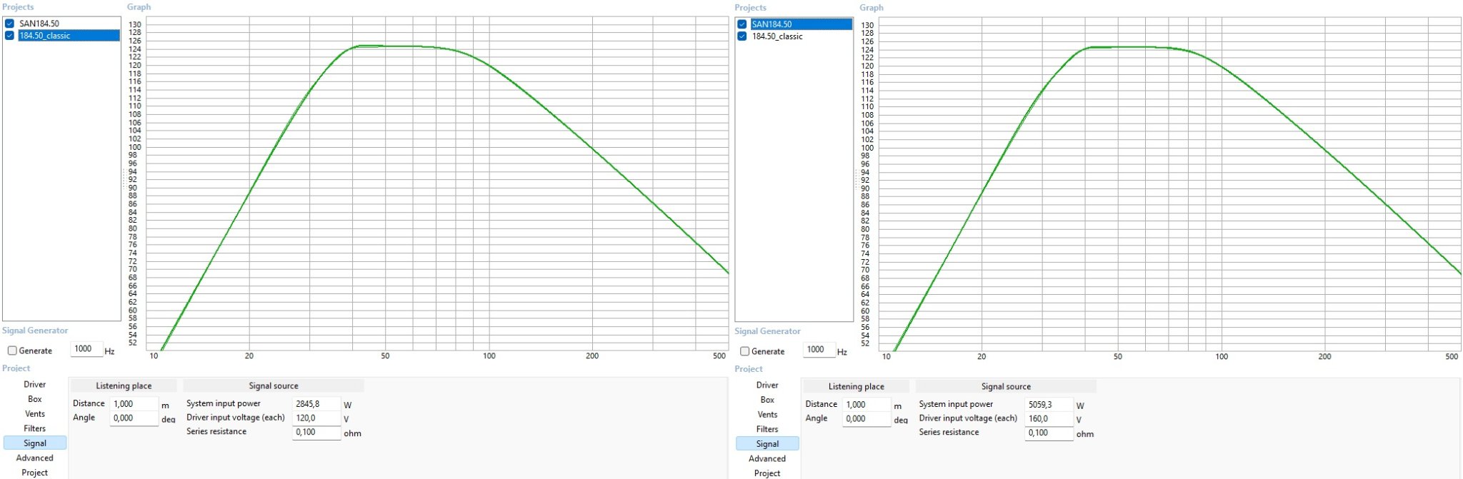

@waxx

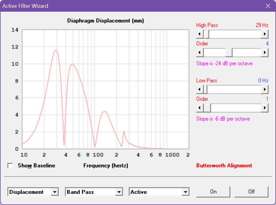

Here:
Look what wattage the WinISD proposes it to feed. Even without EQ, it is very unreliable piece of data. One cannot take this into account while developing any kind of serous box.
The classic design is 92l@39Hz ported box. The proposed unconventional is 29Hz tuning with sooner cutoff. The goal is compact, you simply cannot run from this and say 200l box is better. It is, DOH, but then two 92l boxes will walk over the single 200l box and outplay anything it was thinking it was doing....
Now, cone excursion:
There are ways and angle of views to look at it indeed.
The matter of fact is, that my design with such tuning is, that at high power frequencies, it moves much more, and cools down much better. You don´t want to feed 1200,1500,2000W into speaker that is barely moving. That will not work out.
Now you can counter with higher distortion. And you would be right. But it is still better than driver burned down, and I was specifically testing and buying speaker with long stroke and liner suspension, that will work admirably there. If we took for example the original B&C Speakers 18DS115 with Xvar of 14mm and suspension compliance halving at about 12.5mm, it would end up bad. Not with this one! But you cannot simulate that or read it from datasheet.
Now you might argue that the classic design could be fed more, because it has excursion to spare. Well, good luck with burning that thing down when the DJ hits that 40Hz note for 5 minutes straight.
Now, power! This is funny one!
↑ Not so for the classic design with 0°phase angle at 39Hz....
The WinISD shows apparent power. That is Volts versus Amps. Volt-amperes, not Watts. But that does not make all the heat. Volts * amps * cosinus phase angle - Watts do. Once you account for that, you will realize that the unconventional design eats LESS power in the most demanding areas where most cooling happens. Yes, my design eats more between 60-100Hz, but Make it half for ANY music with 3dB dynamic range or more, and we are talking 150-200VA load on the driver. Peanuts compared to 1000+ in the bass range. We can afford to basically discart that.
And so that´s that. Different view on things, and I believe I am not wrong here.

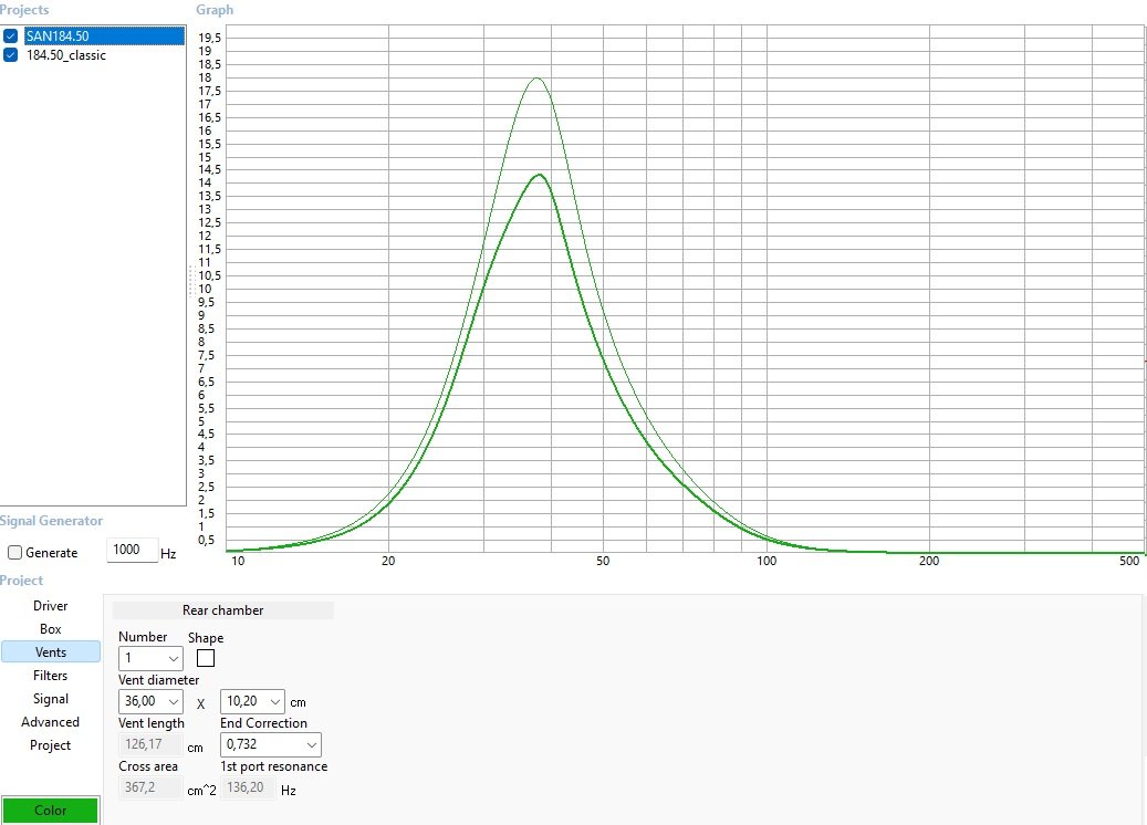

....And here is port velocities in roughly same port box volume:
With long rectangular port, all simulators are greatly overestimating. The box and the port is standing, and it is about 100cm long, properly tuned within 1Hz.
Now Let´s keep it the way the WinISD simulated. 14.3m/s versus 18m/s. Win for the unconventional design yet again.
Group delay, just in case, basically same within 35-500Hz.
The conventional design indeed has more maximum SPL. But in face of burning down, I have no use for it, or be bothered additionally by limiter pumping or fadeouts as it tries to save the speaker from inevitable. I´m sick of the strongly audible dynamic processing.

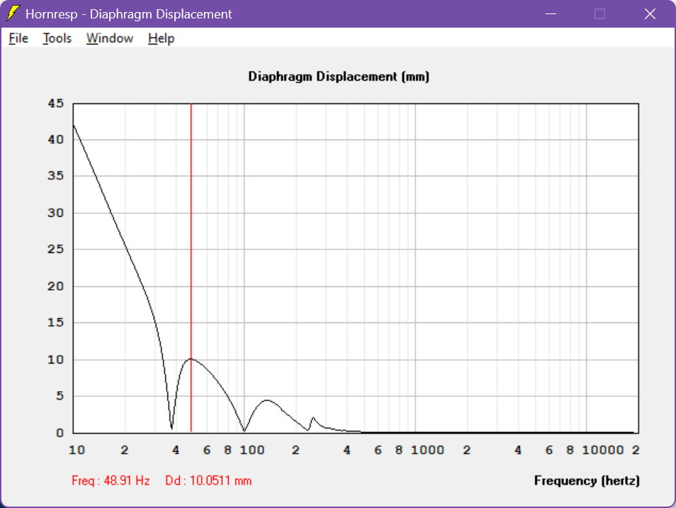

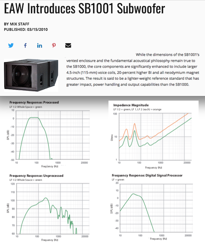

When the "new generation" of higher power/excursion/Bl neo drivers appeared around 2010, EAW used a similar approach, they lowered the Fb to 30Hz, loosing some low end sensitivity in the SB1001, but increasing power density while still using a "flat to 40Hz" processed target:See.... It is not that I insist on that or on anything. It is that after numerous measurements, tests, discussions and $$$$ spent ofon speakers, I got to this point. Not full conclusion, I am open to things, but it seems to me like it.
I prefer your design's shallower depth to the SB1001, though it's offset cone arrangement also being part of the port exit increases the internal volume/port volume slightly by comparison.
In case there was any doubt of what I meant by orienting the port vertically to increase heat transfer from the bottom to top, I meant like this:
That's interesting (and odd), will be looking forward to your impressions with high power...the San184.50 behaves somewhat against it too - during burn-in test, The Fs moved up, Impedance lowered. That thing stiffened when moved a lot.
Art
I wonder if they had the same reasoning and what led them to basically discontinue this approach. Though these 130+ and 140dB figures are sweet. I'm going to market these figures on mine too hehe...

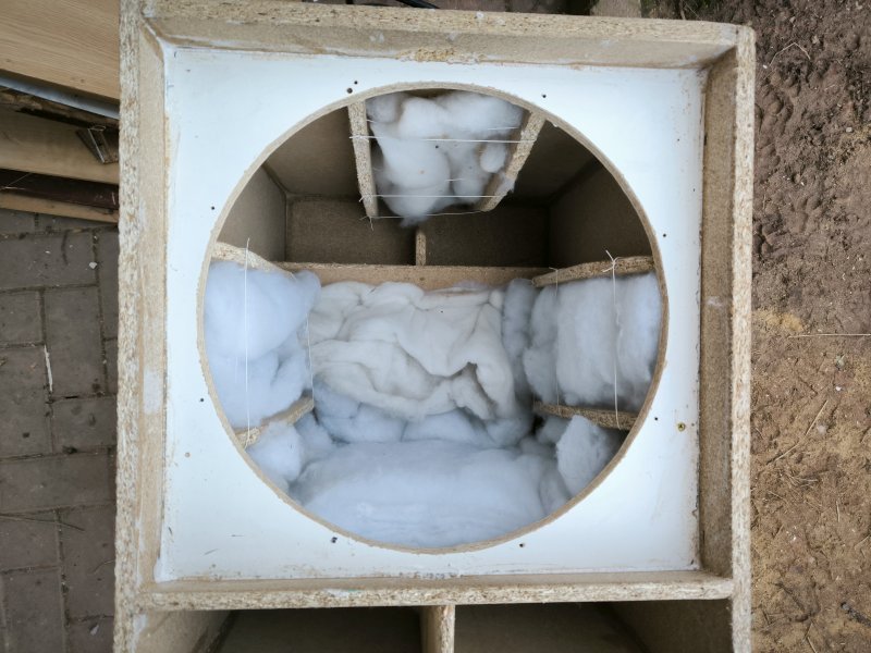

It appears that the test box is compact enough to fit two into the volume of the SB1001.
I understood what you mean regarding cooling, just didn't make the connection with the port dimensions-orientation. Yes, that's what I will do in order to secure better heat exchange with air.
I was thinking of design where the cone makes part of the port. I have even executed such thing before, and it does not work out favourably box volume wise.
Regarding the driver, I unfortunately was not able to replicate that behavior. Either it was some very weird Arta/Limp glitch, or it was part of the burn-in process, where the spider stiffened before it loosened again. I don't know. Now the drivers behave fairly as expected, although Fs is not going down much even after serious abuse.

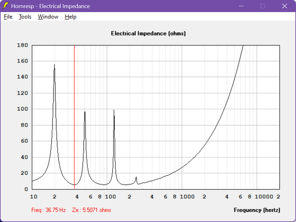

Also tested the warmed up speaker in the box, and the impedance peak leans into the bottom range. So it looks like I can keep it tuned tiny teeny higher for less excursion and keeping that peak where it is needed.
By the way, I found a Basstronic music/track, where 1 period bass signals are played in rapid succession. In slo-mo it looks like the speaker only has 1/2 period overshoot, the rest is heavily attenuated/damped. Not bad.

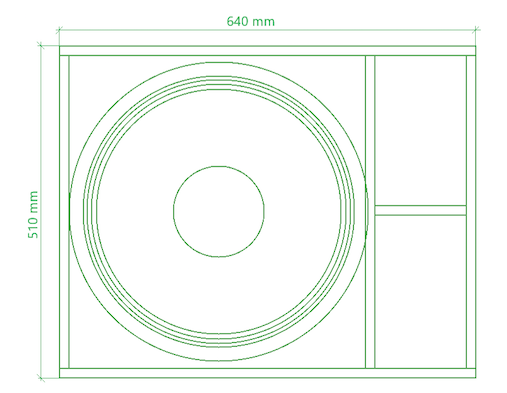

Objective in detail:
Box volume: Max ~210l / 7.4cu.ft brutto, ~92l / 3,25cu.ft net depending on the speaker.
Weight: ~34kg / 75lbs. Easy single person operation.
Frequency range: 40-80Hz flat, 35-110Hz -6dB.
SPL: 121dB/W/m+ according to Hornresp in halfspace.
This design could be made smaller, but A) for serious compromise B) If planned upgradability is dropped. More on that later.
Low power compression, low port compression.
In this case, tuning frequency will be 29Hz.
Drivers that qualify:
Generally these with displacement volume of 1,8l and more, and Bl²Re over 200:
That is, for example 18Sound 18NTLW5000 4Ohm version
LaVoce SAN184.50
All the IPALish drivers.

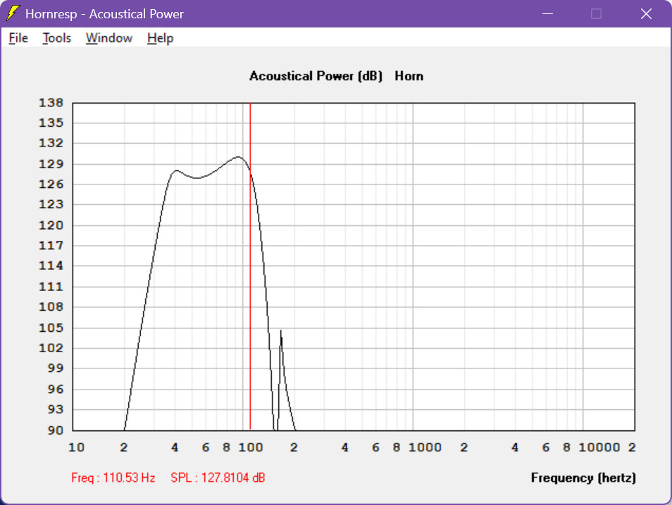

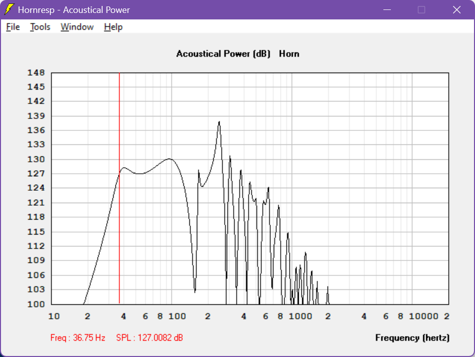

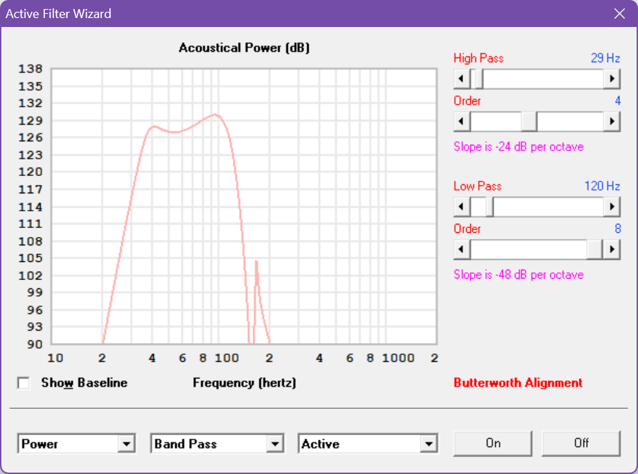

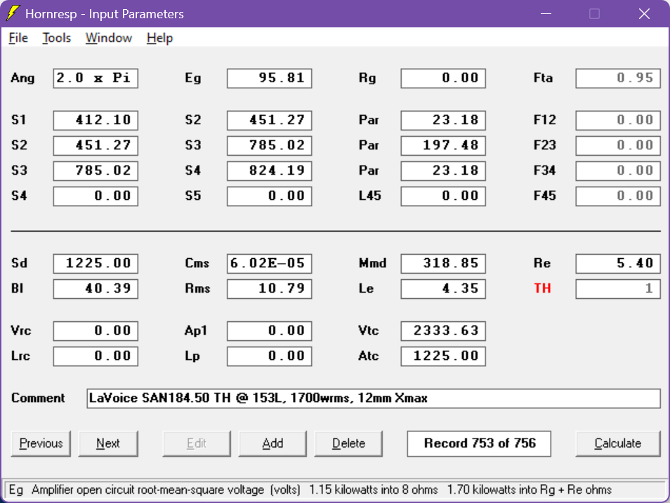

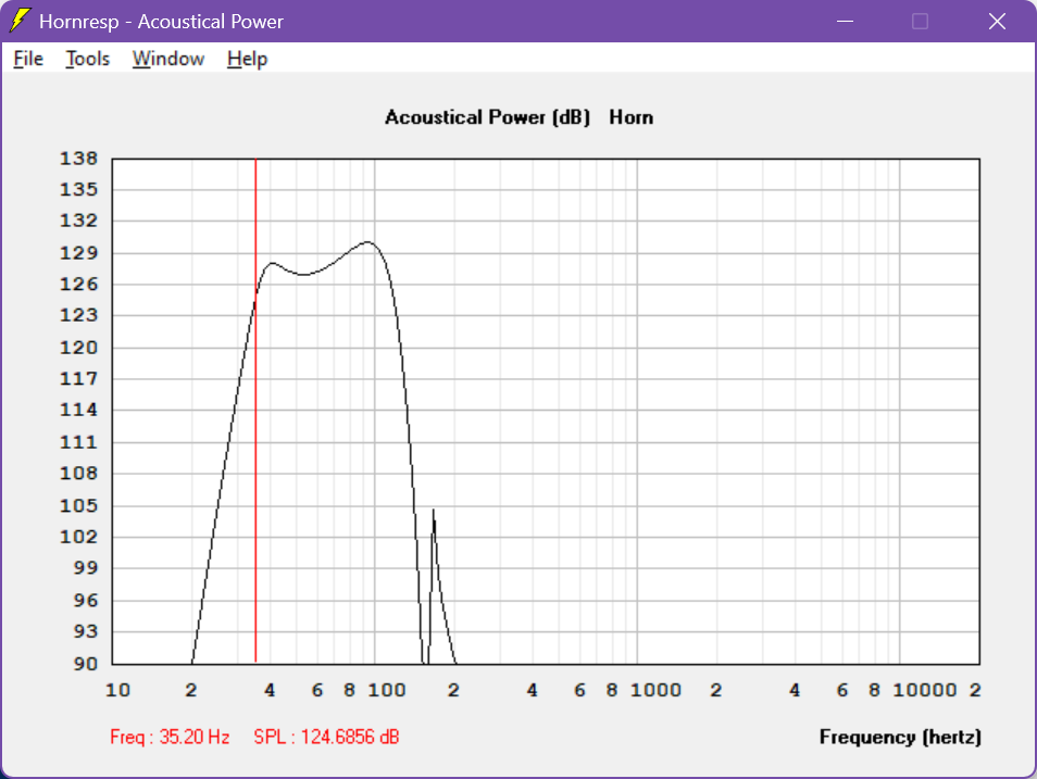

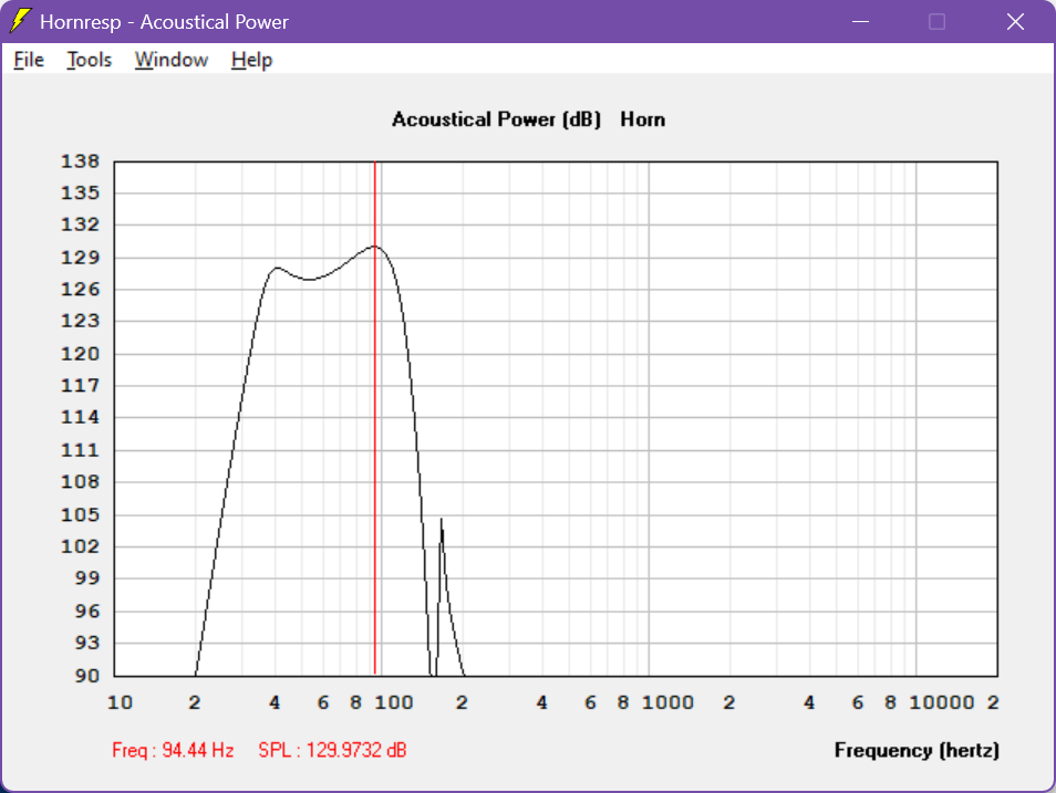

Quick model.

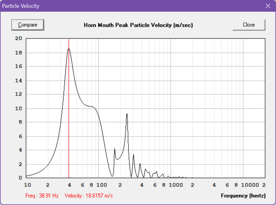

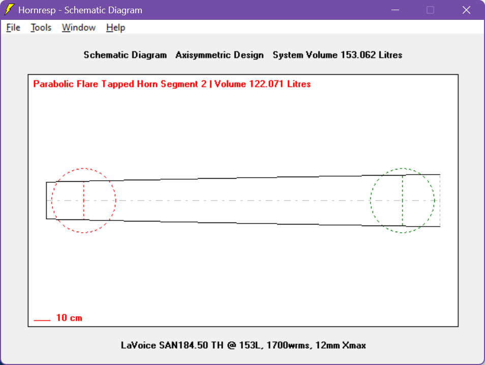

8ft TH (BP6S) = 26.25" high x 19.75" wide x 24.75" deep with 19.05mm (0.75in) wood.
The 18.62 m/s horn mouth peak particle velocity is k!ll!n' me tho'.
Avsforum.com guys are cool with <25 m/s with the Devastators (BP6P).
Diyaudio.com = <17 m/s.
Certainly, after measurements and final developments. But the original design posted is VERY close to the final. If ever, it might be 51x64x64cm, and very little change in the port profile. This is basically IT. But I will post the final design, no worries.any final schematic for the high power compact 18" sub ?
@BP1Fanatic :
I have hard time believing the TH will fit into that volume, but I might try to draw it. Yes, given the experience I am not cool with 25m/s either. There certainly will be high port losses that way, and that´s exactly what I am avoiding - almost all causes of power compression.
Again, for normal program content, many designs are better. Try that one tone bass note for 5 minut in such design that exactly fits into the impedance walley. There is no physical way for it to survive.
Such argument is hard to take on. I also never had a driver break on me, but that was because of careful management. I have seen drivers burnt in basically everything.I NEVER had a driver break in a bandpass enclosure. I had drivers die in direct radiator enclosures though.
