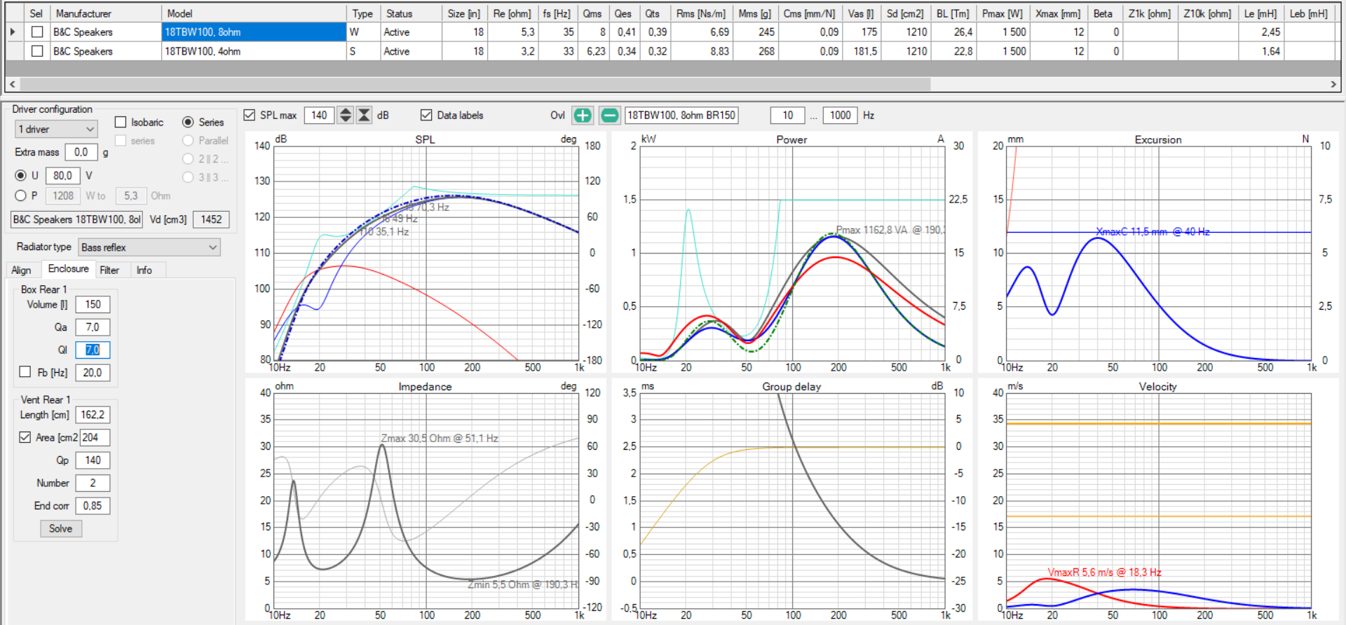

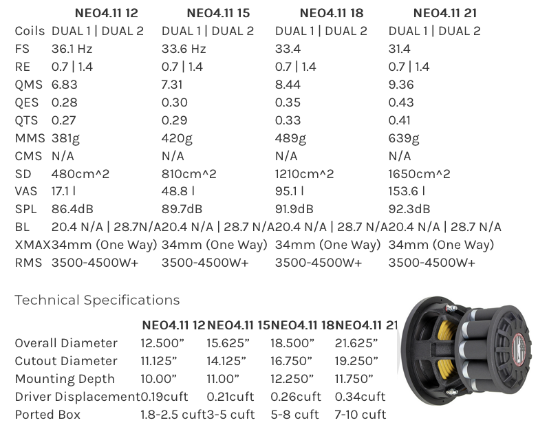

With today's high Xmax drivers, it seems like it might could match/best my long gone dual kit Danley Contrabass if they were fan/whatever cooled.
https://ficaraudio.com/neodymium/4-series/411/As mentioned, high displacement volume.
The Fi Car Audio NEO series looks like it could kill for output density.
The 60 pound weight is over what you want, but 34mm Xmax is way out of the "pro audio" limits.
Yes, there are existing speakers already, but no free lunch. 2x-3x higher price, weight, hard to feed in PA. You certainly could do that at a cost.
If I knew how to effectively feed 2Ohm speakers, I'd get the IPALish versions of LaVoce and be done with it. Feeding four 8Ohm or 4Ohm drivers can be as cheap as ~$1000. Two ohms, tough luck, much more than double. So overall for the system, you'd pay more than double for about 2.5dB gain in loudness. Doesn't make sense to me. But good find and good point!

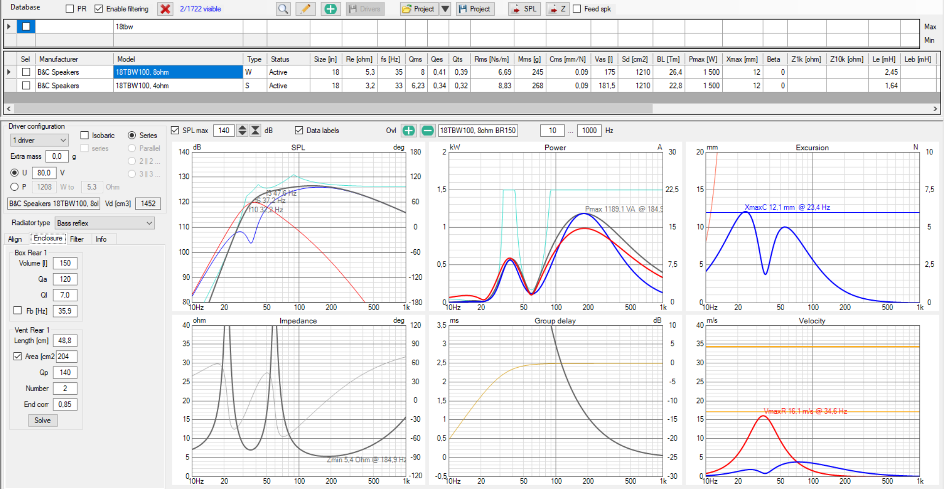

What you're essentially saying is the enclosure and driver needs to mostly be oprrating in some form of resonance over most its bandwidth. Running it this way keeps the amp from seeing the nominally lower driver impedance and therfore avoids heating the VC by keeping VC curent low at high drive voltages. That pretty much means sloppy, boomy, resonant bass from lack of cone control.
The right way to do it (which promotes better SQ) would be to raise the sensitivity of driver and enclosure via more efficient enclosure design. Hoffmans iron law works against this, so a small enclosure won't net much sensitivity if bandwidth and sensitivity is to be higher.
Why hasn't this supposedly been an issue before? It's the music itself placing the demand on the speakers. It just requires alot of power to generate high SPLs. There's no free lunch. Using resonance to achieve high SPL reliably for long periods of time is the only option. It will end up sounding awful and it has to do so, mainly because you need current to tightly control the cone motion. That can't be done with the enclosure running in resonance mode, as the amp can't command the driver properly without some corrective force. That needs current at a lower impedance, which means power and VC heating.
In order to have decent reliability at higher SPL and a small enclosure, more controlled excursion can help, but thats tricky to keep an eye on. It calls for specific enclosure tuning, which can work ok, but only if the driver is carefully dialed in and VCtemp is constantly being monitored. That has to be done through complicated DSP modeling. Feed forward correction doesn't really solve the issue, as it just pushes the driver harder if its EQed to go lower than the physical enclosure cutoff. This is just like the driver impedance being reduced, causing further VC heating.
Back in the day we used LF FLHs to generate high SPLs, but those require huge, heavy enclosures. You had to keep a close eye on the excursion and heating the VC from lack of airflow inside a relatively small rear chamber. Tapped horns came along and improved this, but made SQ deteriorate from the multiple resonances of the enclosure design itself. Some tapped horns sound pretty good, but not great. IMO its easier to use many smaller subs and DSP correction. The multi band limiting / compression, dynamic EQ, power derating and arraying of multiple smaller ported cabs will be the most effective way to generate high SPLs for a long time. It depends on the venue and engineer as to how well these tools can be utilized in order to keep SQ relatively decent.

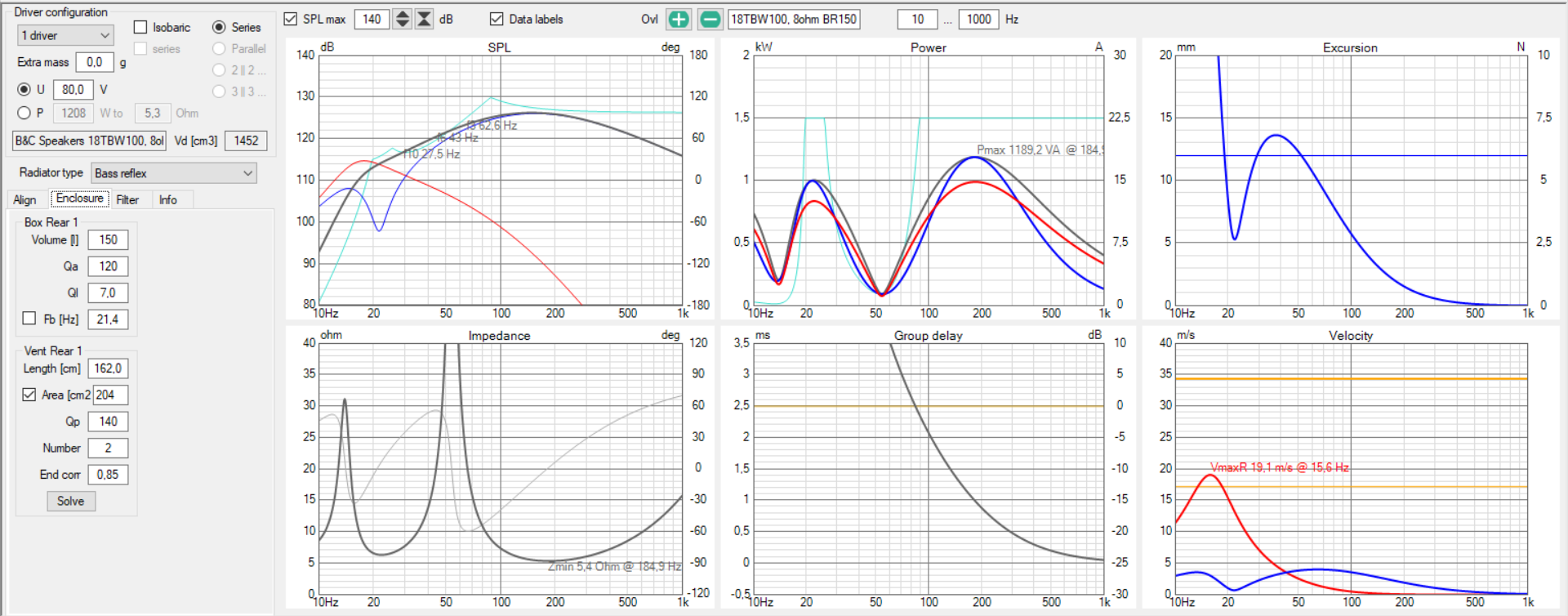

But I would love to get to the bottom of this.
The amp is holding the position of the speaker too, not letting it swing freely. Small box volume is not letting it swing freely, PA design with managed excursion and DC offset management in mind is not letting it swing freely, and the San184.50 behaves somewhat against it too - during burn-in test, The Fs moved up, Impedance lowered. That thing stiffened when moved a lot.
Before, I had combined net box volume of about 250l, two speaker motors to excite it and 4800Wpeak to feed it. Now, there is four motors, 360l of net volume, much more port area, 8000Wpeak to feed it. basically, I am doing everything possible at once, to not have to drive it that hard.
The ports are working, otherwise They would not deserve to be that big. They are adding to the SPL between 30-40Hz still, and even with the management, there will be 15m/s flow in these. It is just that these will be used fairly lightly.
But, I would love to know more arguments or more exact suggestions about how and where to look at it, what to measure and compare, etc.

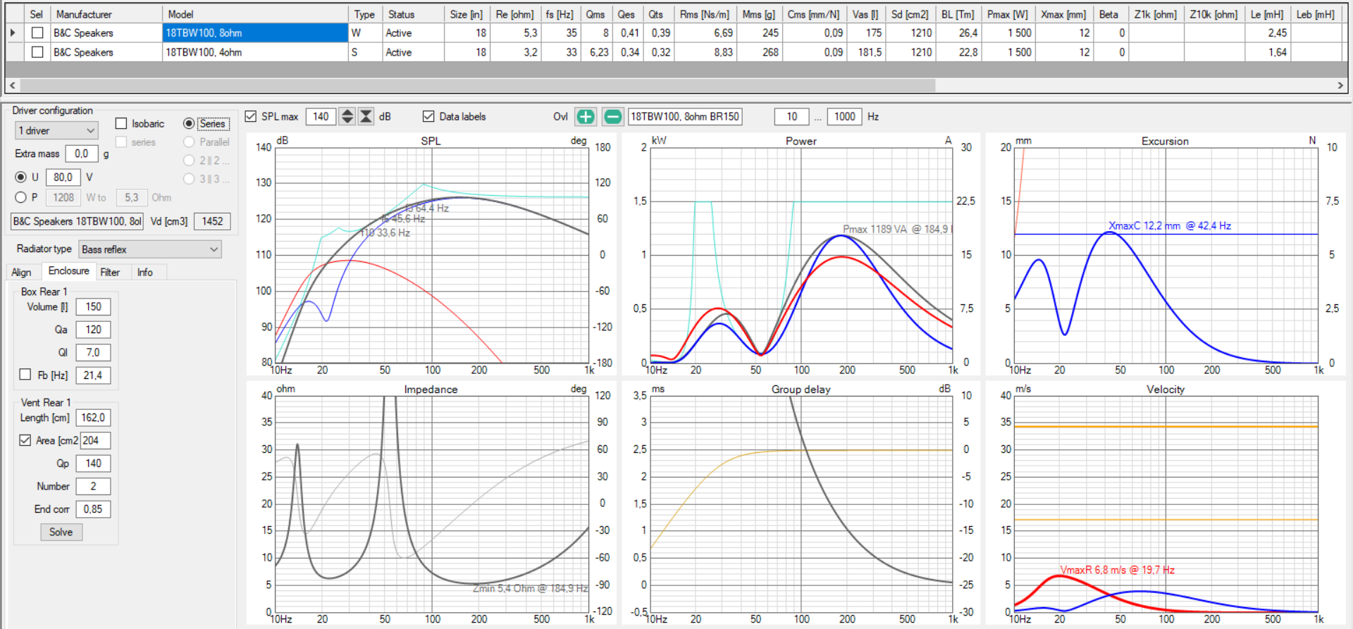

This angle of view is interesting and somewhat welcome for further investigation. Bevause it has merits. Well, any design has this impedance peak, This usually is not an objection though if someone tunes the port around lower frequency, but uses it there too. I mean this claim probably has no way to be taken on in any usable way yet. Needs more refining. It would mean other systems would be sloppy as well. By the way, the 21DS115 was used this way, and the sound was lovely and hard. The (MS-sound) guy who heard it with both 21DS115s and RCF LF21N551s, develops and sells gear, took the enclosures from me and purchased new 21DS115s for himself in order to have this sound again. It is not all just crapolla. Knowing how the RCF double 21"s sound (very sloppy), I can just argue it is unfounded claim in this young formWhat you're essentially saying is the enclosure and driver needs to mostly be oprrating in some form of resonance over most its bandwidth. Running it this way keeps the amp from seeing the nominally lower driver impedance and therfore avoids heating the VC by keeping VC curent low at high drive voltages. That pretty much means sloppy, boomy, resonant bass from lack of cone control.
Sure. Absolutely. Not an option though. We are sacrificing sensitivity, half way efficiency and almost everything for SPL density and low crest factor signal handling. I did not say it is universally better solution. Well aware of that. The distortion rises because volume displacement in smaller enclosure causes more pressure difference in the box, thus greater nonlinearity, and the avalanche of bad parameters could keep going forever. The point is, that no system in such size will play this loud and hard. One could get 15" for such volume, that would feel good in that volume, but it would simply not play better.The right way to do it (which promotes better SQ) would be to raise the sensitivity of driver and enclosure via more efficient enclosure design. Hoffmans iron law works against this, so a small enclosure won't net much sensitivity if bandwidth and sensitivity is to be higher.
In a way, I am doing that too. This rig will basically be just for myself, and some gigs where things don´t matter. In home circumstances, I will welcome the usability down to 25Hz with this low tuning.The multi band limiting / compression, dynamic EQ, power derating and arraying of multiple smaller ported cabs will be the most effective way to generate high SPLs for a long time. It depends on the venue and engineer as to how well these tools can be utilized in order to keep SQ relatively decent.

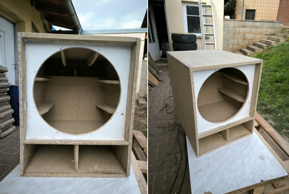

Test box is up.
Wet though... One day to become mountable and measurable, another day to cure/harden.
Whew, the woofer fit in within last milimeter. don´t know where I lost 5mm in my box measurements.
Not sure where to gain possible 25mm in height in order to allow fitting the 19" RCFs. It´ll probably go the other way. Stealing dear milimeters everywhere to stay most compact with 18"s.

Well, I could not wait to at least mount the beast. With average to low padding, the box tuning is 29.5Hz. I guess I missed the design by ~1Hz, because I thought it will be under 29Hz with padding. Hornresp is way off... That´s okay, some milimeters will be shaved off of the port area in final design anyways.

Good points. I believe it is not that straight forward. If you excite a port, it has one strong and about two decaying periods before it stops. And the cone can do nothing about it, because it is basically stopped anyways. Only saving grace is that noone knows how the bass is supposed to sound, so it sounds fairly natural.
For the cone resonance, on top of what I mentioned, I believe the amp has some hold of the driver even at resonance frequency. I wonder how do I get to the explanation of that, but I think so. It is DCR bound.
When I knock on the speaker right in the currently build design, the sound is "DOH, DOH, DOH". When it wired to the powered amplifier, the sound is TOK TOK TOK. Clearly braking whatever resonance it has. Does it debunk my first paragraph? I don´t know, I think it is speaker issue here, not port issue.
^ Yeah electrical damping, the driver backEMF makes current which opposes the movement at the drivers resonance. Above resonance it doesn't oppose due to mass being accelerated delaying it 90deg. You hear the resonance when you knock and the amp is not connected, because electrical damping is missing. You can make electrical damping just by shorting the driver cables, so without an amp, and repeat the knock test with same results as with amp connected.
@profiguy thanks for the follow up! I see your perspective, it's fine although some of the explanation is backwards 🙂
Hmm, I'm not at simulator right now, but i think you could exchange port output SPL by reducing efficiency of the port<>driver resonance by adding damping material inside the box. This would increase cone movement and reduce current at the tuning frequency helping with the thermal management some. Also helps dampen some driver resonance above the port tuning to protect from over excursion a bit. This seems silly at first but perhaps is useful in your application. Anyone have vituixcad open?🙂
Hypothesis is the system would transition toward kinda closed box response with more damping added inside the box, but with some overall cooling ability as it's bass reflex still. The expense is reduced efficiency at least lowest lows, but these you highpass anyway which is why I think this might be useful if you need reduce heating further. Looking at impedance plot the two peaks would reduce and low point between get bit higher. Or perhaps it's more heat for same output? 🤔I' ll try to simulate tomorrow, I must get some sleep now. Good night everyone!

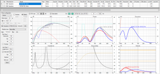

Cool it's exactly what happens with impedance plot, although it's not useful as power is increased at the drivers resonance. High pass filter would already cut the power from the tuning frequency. Anyway, fun stuff 🙂
A woofer I had open in the simulator tuned to very low in relatively small box, power minimum around 50hz and max at ~22Hz
2nd order Highpass filter at ~30Hz cuts the power in half with only ~1db output reduction at 40Hz, assuming pass band is something like 40Hz up.
This happens if empty box is adjusted to "heavy stuffing" dropping Qa from 120 to 7. Efficiency drops so output drops. Power draw at the tuning frequency drops eyeballing about 25% while power draw increases about 50% on the driver resonance, so perhaps it's a silly trade-off even for this application 😀
Here with more conventional tuning, eyeballing 3db more output at 40Hz, with not much more power draw. Had to adjust HP bit to keep excursion within xmax below tuning.
But making this experiment I think I get the twist, Crashpc box is tuned for very specific genre in a way, to be able to exchange the ~3db drop in max output that is lost due to very low tuning, to prevent the >6db power compression and destroyed drivers, making it worthwhile. Otherwise more conventional tuning would give mucho more output.
There is a reason why scoops are still popular for those genres. the backloaded horn with a compression chambre helps a lot to have the strong bass without smoking the amp and driver when done right. The only boxes i know that can do similar are tapped horns and tranflex cabinets. Both use the driver with the magnet out to cool the magnet more.
