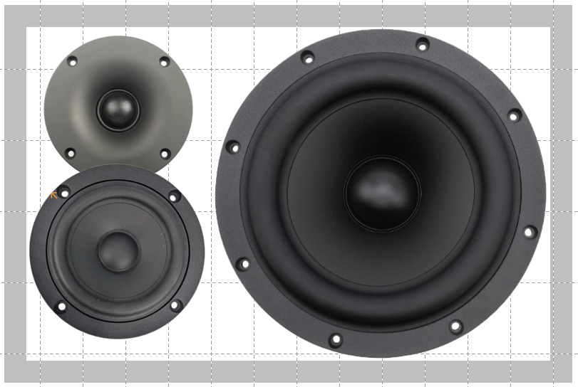

Compact 3-way monitor (horizontal orientation)
together with a abt 12cm midrange and abt 5-6cm tweeter (typical tweeters with 10-13cm plate would not fit).
If you're restricted to 20cm, I strongly suggest a coax driver for mid and high. The Sica 5" comes to mind. It's all in one: built-in waveguide, thus controlled high dispersion, two units in one and budget wise very attractive (be sure to log in on TLHP). But there are others of course.
As for the bass driver: A RSS210 or SB23 are quite OK for this. Since you're going active, correcting for small enclosures is a piece of cake.

This mock-up would be 27x40cm overall (assuming 15mm walls)
all drivers SB Acoustics: 26mmWG tweeter, 12cm mid and 8in small VAS woofer.
If I use smaller tweeter and woofer, I can get to about 22x36cm, but I can find no small tweeters with waveguides.

As far as I see it's a rather big and deep WG resulting in steady increasing directivity with frequency.
Not sure if it was not more intended for bigger 2-way midwoofers.
But I am happy to be corrected!
See here: https://heissmann-acoustics.de/en/test-wg148r-noferro-900/
You address a valid point. Alexander ‘himself’ advocates the combination with 5-7” midwoofers. The WG148 isn’t as deep as the Monacor WG300 though.
Another option is a homebrew or custom printed 4” Augerpro WG. These aren’t that big either, 8,7cm high if I’m right. All this although I still think of coax…
