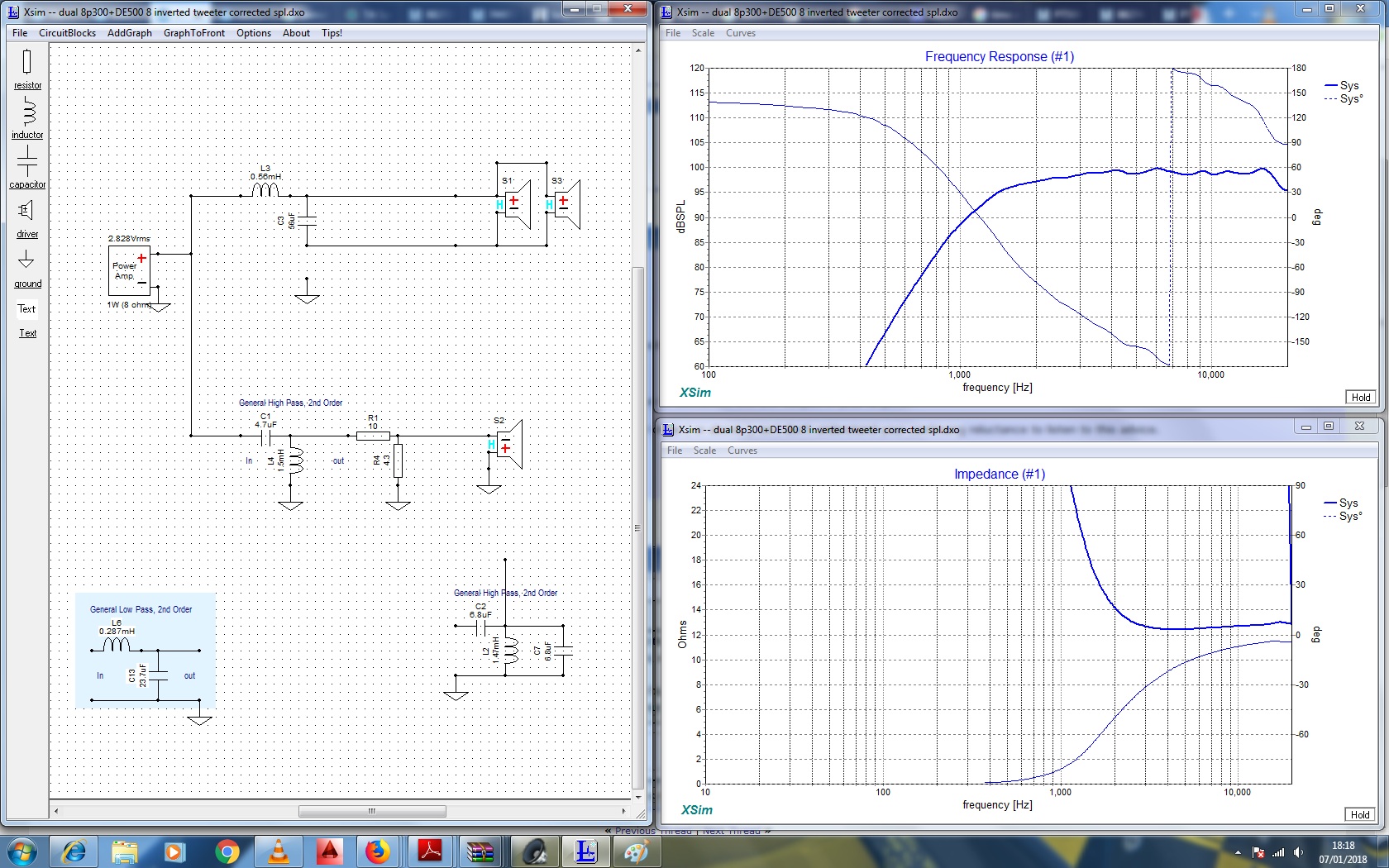

Why do you keep bringing back C4 into your schematics ?
Without a series resistor connected between C4 and ground, it doesn't qualify ( electrically ) as a bona-fide Zobel ( impedance equalizer ) which is the title of this thread.
I can see that you don't understand how a Zobel works.
( Functionally ), a lone capacitor across the driver load ( no resistor ) will only serve to destabilize the UHF output of your amplifier.
You've now been told a few times to keep the working impedance of your sims to 4 ohms ( or above ), so I don't understand your continuing reluctance to listen to this advice.

I learnt the lesson.
In fact, you, and other members, said at the first posts of this thread that using a parallel resistor should flatten impedance peaks, so no need for a zobel here.
Attacked the screenshot with no zobel, so you see impedance is constant after xover point with the current config.
I put C4 directly to ground, to pad down the top end, but didn´t knew this practice could damage my amp, so thanks for your tip here.
Removed C4 since I dont want to hurt my amp.
Thanks!
Thanks!

To reduce top-end ( anywhere in a circuit ) the normal practice is to use a series inductor/coil.
- Circuit impedance will typically start to rise above the coil's Fc point ( this is generally considered to be more desirable/safer than lowering the impedance ) .
One can parallel a resistor ( even a variable resistor ) to tailor how much attenuation ( out of a maximum 6db per octave ) one obtains.
It can be done, it's just the way you did it.I put C4 directly to ground, to pad down the top end,
Impedance compensation for dome tweeters is usually done at resonance with a series RLC in parallel with the driver. The top end doesn't usually need to be compensated. Amplifiers are usually treated just outside their feedback loop so you should be able to leave it alone.
I think I got it.
Not necessary the RLC this time. I get good impedance graphs for both the cd and the woofers.
Just will order several resistor values to play with the voltage divider, to pad down the cd. Forgot the wrong cap idea...
Thanks for your advices!
