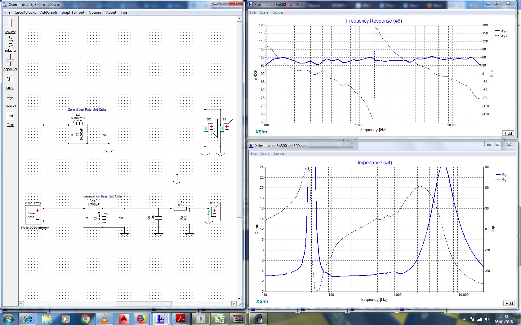

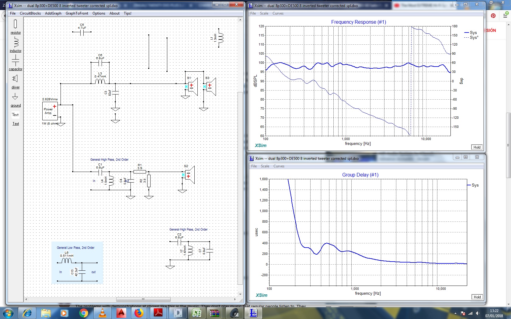

After some hours I got the attached schematic. I have almost all components for those values.
Please, let me know if it seems like a reasonable xover circuit for those drivers.
It is reasonable. The impedance at 10Hz and lower doesn't count, your speakers can't reproduce anything there anyway and the minimum in the reproduction range is at 3,5 Ohm. That's completely normal (15% under the rated impedance, which would be 3,4 Ohm) for a 4 Ohm speaker. A stable amp is recommended though. 😉 Using the drivers in serial can be very critical because of the power distribution at tolerances and has to be avoided if possible.
I think there are only drawbacks using the woofers in series.
Lower spl and I dont have a big amp to move them this way.
Also, in series, the crossover components will be bigger and the system will be more sensitive to component tolerances.
As Icg says, running them un parallel would make almost 4ohm impedance. A bit hot for my amp anyway... Will have to put a bigger heatsink.
Refarding the xover. I dont know if its a good idea to drop the highs. My room will make a boost un the bass, thats why I think it would be worst.
I'll play a bit more with the simulation and come back.
Thanks a lot for your help.

As long as you are happy designing your hipass for an 8 ohm impedance > you could always use a variable Lpad to dial in the preferred horn level.
The schematic ( that you posted above ) forces a 15.5 ohm "working impedance" onto the horn circuit ( which is fine ).
This higher working impedance ( 15R > horn only ) rewards you ( compared to an 8 ohm circuit ) by allowing the use of smaller capacitors ( for the same Fc ) but punishes you by making you buy larger coils ( to arrive at the same Fc ).
- Choose your poison here ( I mostly prefer to save cost in the area of coils/inductors though many times I like to work with 10R to 12R horn circuits ).

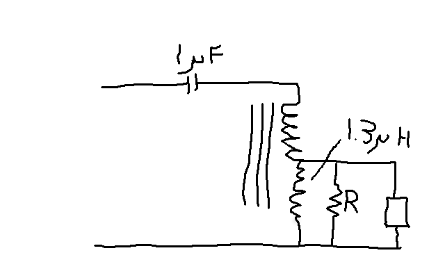

I wanted to explain a method I mentioned earlier but I got a bit busy. Altec may be the first company to use this sort of pad.
I am assuming 10 DB padding and 1400 HZ, 8 ohm high pass for this example.
Two disadvantages of the L pad are:
lower dampening factor when adding series resistance. Compression drivers do not sound the same when you have too much series resistance. Attacks seem to be a bit blunt.
Additional power dissipated inside the cabinet or at least in the crossover.
For the choke, I use powdered ferrite torroid cores usually stolen from computer power supplies. You want a permiability of about 2-5 for the core. They are fairly easy to hand wind.
Without a pad, the values for L are 1.29 millihenry and C 10 microfarad.
10 DB power loss is .316 voltage.
I wind the torroid for 1.29 millihenry first. In this case after the center tap I would use smaller wire with 3.16 times the turns needed for 1.29 millihenry.
10db power loss results in 10X impedance so the top of the choke would appear as 80 ohms.
I get to reduce the capacitor by a factor of 10. This is helpful with lower frequency crossovers.
Now back to the original problem of impedance compensation.
I can add some series resistance to the driver.
If I add 8 ohms, I want .645 millihenry initially and 2 microfarads.

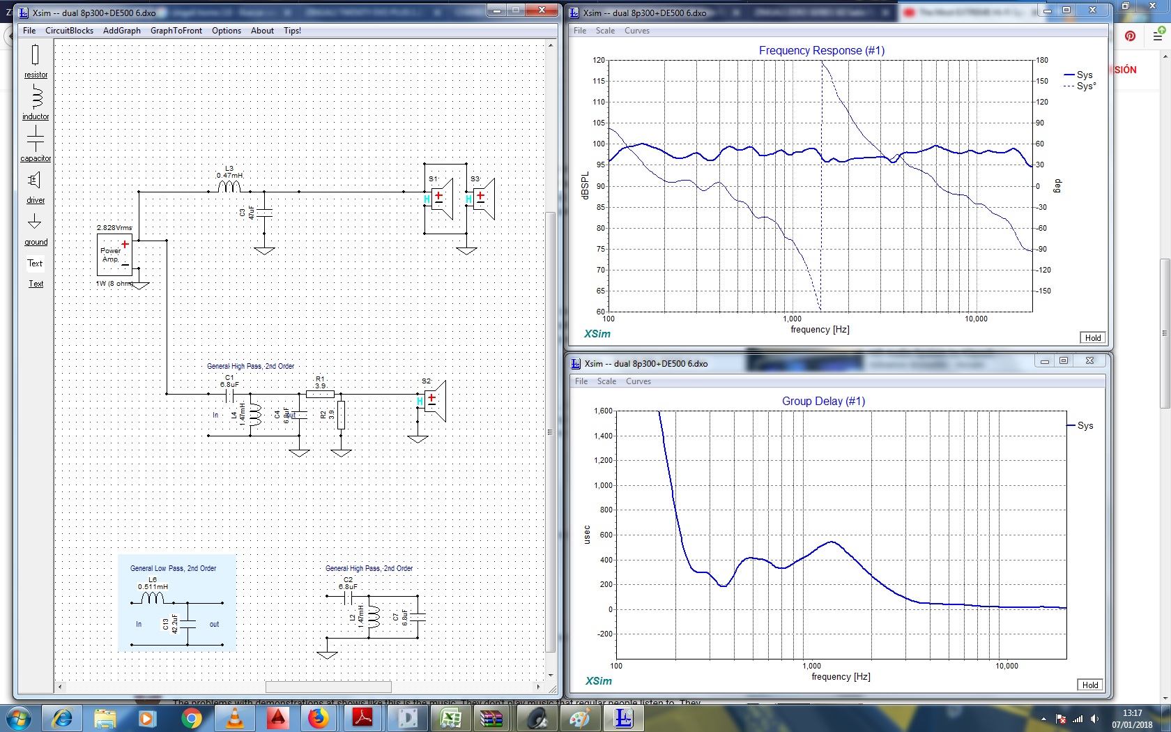

Earl, thanks a lot for the files. Its very useful to see the behaviour of each filter. I like it.
I tried other xover designs for my drivers and I get flat freq responses using different xover points for the driver (around 1kHz) and for the tweeter (around 1,6kHz).
I wonder if its a common practice or if I should avoid using different xover points.

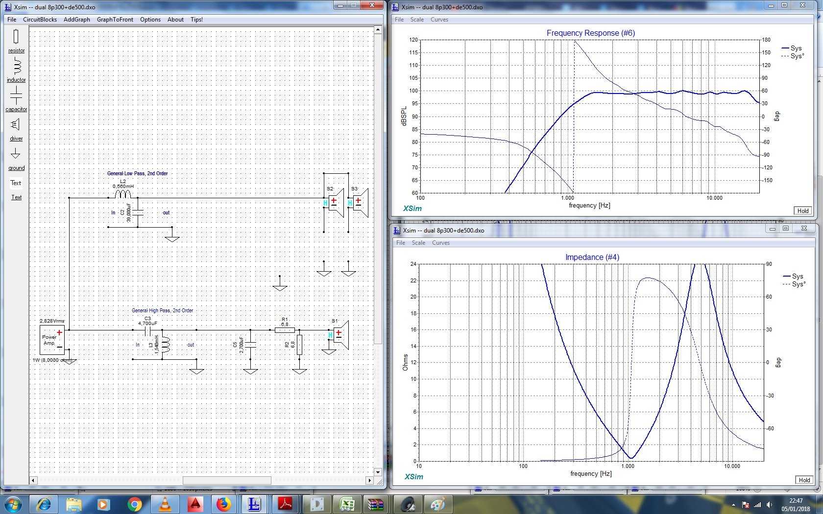

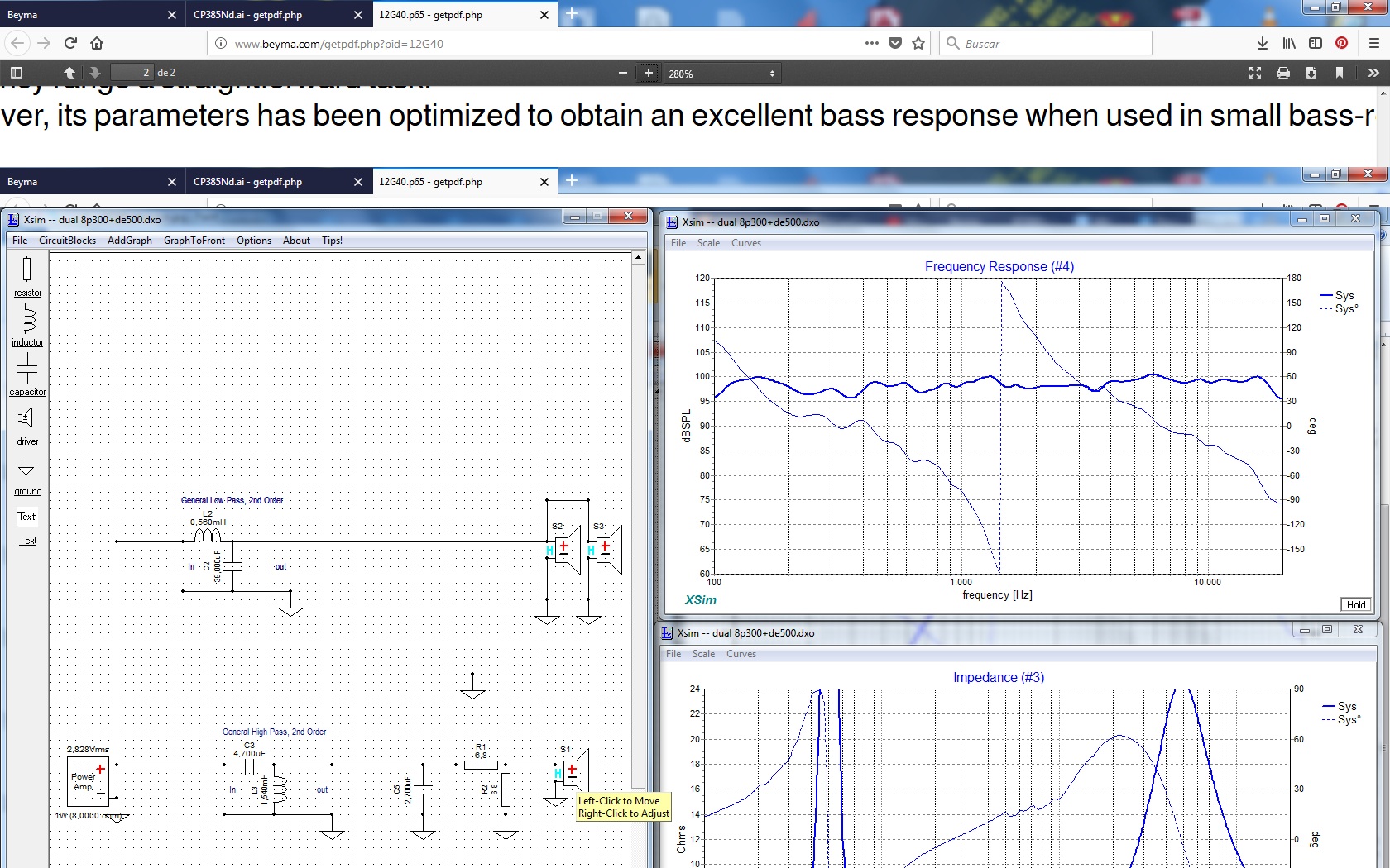

well, another afternoon playing with xsim (is more fun than PS4)

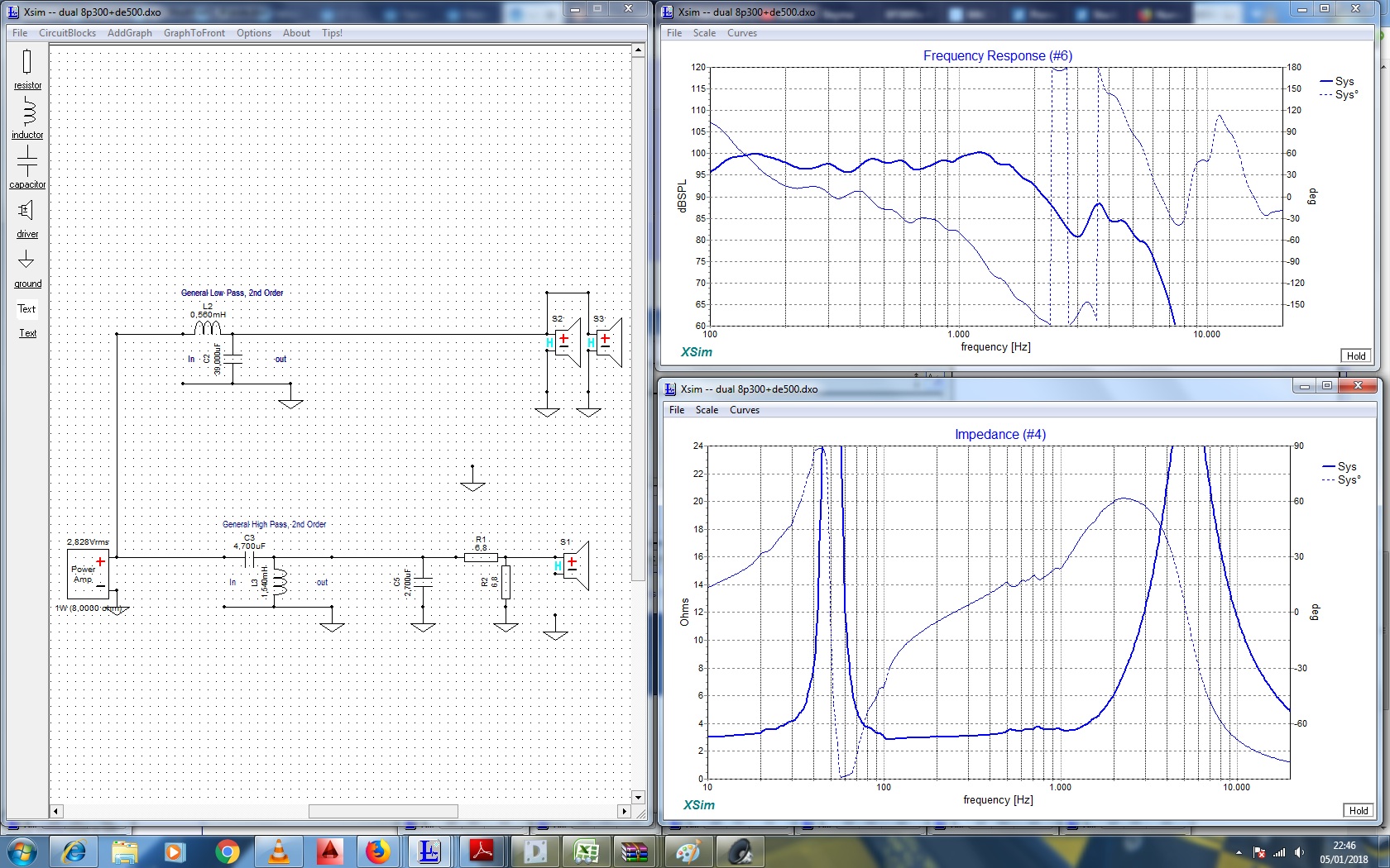

Got the right manufacturer response graph for the woofers. The one I used before were imported from Vituixcad, and was smooth, so it was easy to get a flat response.
With the right manufacturers file, things got worse, since it has a response peak at around 3,8kHz.
Earl, I played with the xovers you sent me, but could not get good graphs, so I went back to simpler, noob ones.
I got a flat graph when combined, but the impedance curve for the comp driver is not flat. If I remove C5 I get a flat impedance but I have to increase series resistor to pad highs.
Also, with the new zma and frd files, I have to put a huge capacitor for the driver xover. I can put smaller ones in parallel, but Im not sure what is less harmful for sound.
Now Im stuck and need your advice.
Guys, could you take a look at the graphs?
Thanks for your help

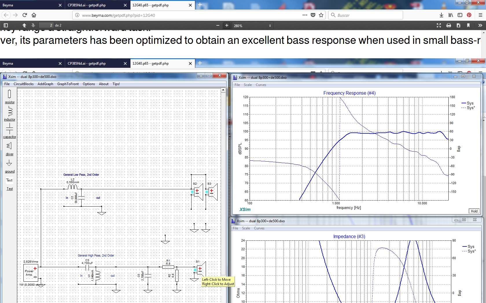

sorry, the screenshots were not complete.
Don't let any of your impedance's dip below 4 ohms ( unless you have amps that are stable into 2 ohms ).
The following is particularly disturbing.
Probably more than 10dB. Are you measuring?The DE500 are 107db so I think i'll have to pad them, but not sure yet how much.
A series capacitor can do much to help and not much to hurt. IMO, don't be afraid and fix your crossover so you understand where to take the response, then you can change your parts/method to anything you want.Maybe Im wrong but a series capacitor will hurt.
You haven't decided if flat response is good or not. What horn will you use and will you listen off axis?I get flat freq responses
You should match your directivity to the woofer and this will set your crossover point. Also, it is not bad to have a lower crossover.I wonder if its a common practice or if I should avoid using different xover points.
Hi again,
Earl, at the last impedance graph, I forgot to remove ground from the lp filter thats why it dropped below 2 ohms. After removed, it shows a dropping impedance from xover point that ends at around 2ohms at 20kHz.
Allen, I have not measured since I have not built the box yet, so I don´t know if a flat response will work or if it will make it sound too bright... don´t know.
Anyway, I´ll take your advice, and buy several resistor and cap values to fine tune it and then, choose the less harmful method to pad the cd.
The cd horn will be made in a CNC lathe, but not decided which curve and tune for it. I have to study it.
I know its not a very technical method, but I could make different ones and choose the best sounding. (mdf is cheap, and lathing is fun)
The problem is that 8" drivers have not too much depth and I have to make a short horn to keep time alignment.
...and, back to the xover, been playing some more with xsim.
This time I tried to keep group delay as low as possible and realised that inverting cd polarity improved it.
Attached graphs. Let me know what xover schematic should work better.
Thanks again for your help
