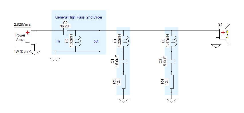

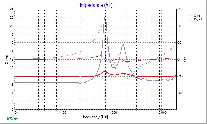

This sounded fun, so I did a little more work. First, I used Virtuix's SPL trace (under Tools) to copy an image of the driver's impedance. I'm not sure if it is exactly your driver, but it seems close. Imported that into XSim, and then used the "Circuit Blocks" menu to add a pair of notch filters. You can see the difference between the original, and filtered here:
attachment.php

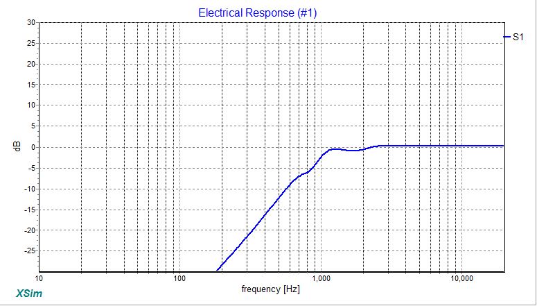

Lastly, I added a 1kHz, 2nd order high pass filter so I could examine the filter's electrical response, which is now pretty close to ideal:
attachment.php
The final schematic is below:
attachment.php
BTW, this is also a very good example of why simulation is a good idea. Depending on exactly where your HP filter is, and the Q, one or both of these impedance notch filters may become unnecessary, saving you some dough! Further, if we had been tempted to add an actual Zobel for the impedance rice at the top octave, the simulation shows that with this choice of HP filter there's really no need at all.

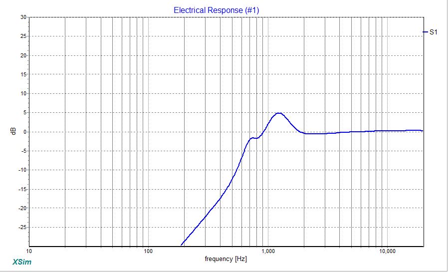

I almost forgot, here is a picture of the Electrical response without the notch filters:
attachment.php
While it does look bad, your choice in HP filter could eliminate one or both of those notch filters. I am pretty sure the first one with the 4mH coil is pretty optional. Save yourself some dough! 🙂

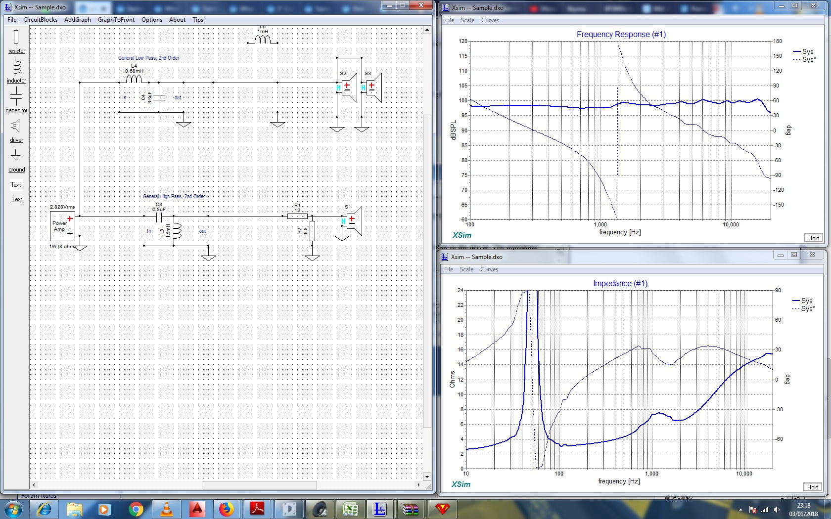

Meh, I did even better. 🙂 I'll just upload the whole thing so you can play with it.
The magnitude of impedance in the humps is now less than 1 Ohm, but again, your wallet uber alles! 🙂 Make sure the notch filters actually matter to you at the end of the day.

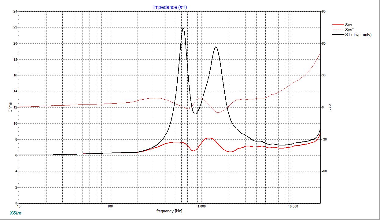

Usually the resistive padding ( necessary to match a compression driver to a direct radiating woofer ) smooths the impedance spikes into very benign bumps ( therefore; additional impedance compensations designed to flatten them out, become un-necessary ).
attachment.php
Seen above is the effect of an Altec style, 10db "T-Pad" .

Drummer, I don't know enough atout T-Pads, but I do remember what EarlK is talking about, that is worth researching before my notch filters, certainly cheaper! You should examine the filter function for any idea before implementing.
Make sure you evaluate the wattage at each resistor too. XSim has a chart for that.

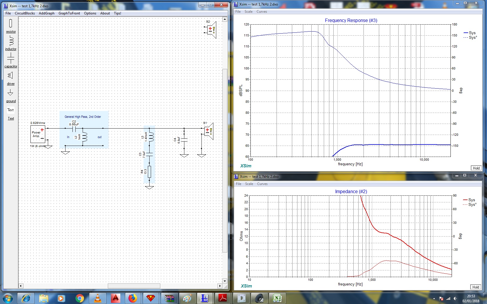

Been playing with the simulation you sent me. Man, this is addictive!
As you suggested, removed the first notch filter, and increased the cutoff freq for the hpf to 1,7kHz.
Added a bypass capacitor to pad down the driver and it seems pretty good. What do you think?
Now I have to figure out how to add the FRDs/ZMAs for the woofers.
Thanks again for your help.
Remember what you were told by others, it may not be needed to design these networks at all. First start with a high pass and padding resistors, then observe if there is anything wrong with FR in the impedance peaks regions and if there really is, then consider to include some.
A - Lojzek is 100% correct.
B - If we are just playing, the cap is a bad idea for two reasons:
1 - If you notice the transfer function wtihout it, the response is flat, so no reason to flatten the impedance.
2 - Notice the minimum impedance has now dropped to nearly 2 Ohms! If you were trying to get a flat impedance, you have gone too far the opposite direction. 🙂
Remove your high pass filter, and examine the impedance again and the problem will become more obvious. This is why Zobel's have a resistor in series.
Best,
E
Put another way, the main purpose of any impedance compensating network is not a flat impedance, but well-behaved electrical transfer function once the filters are in place. They help the high pass or low-pass filters work ideally.
If you didn't have high pass/low pass filters and worked exclusively with solid state amps, then this work is unnecessary. Indeed, active speakers don't bother with this at all.
The secondary purpose, and it is a big cheat, is to nudge driver phase a little bit. 🙂

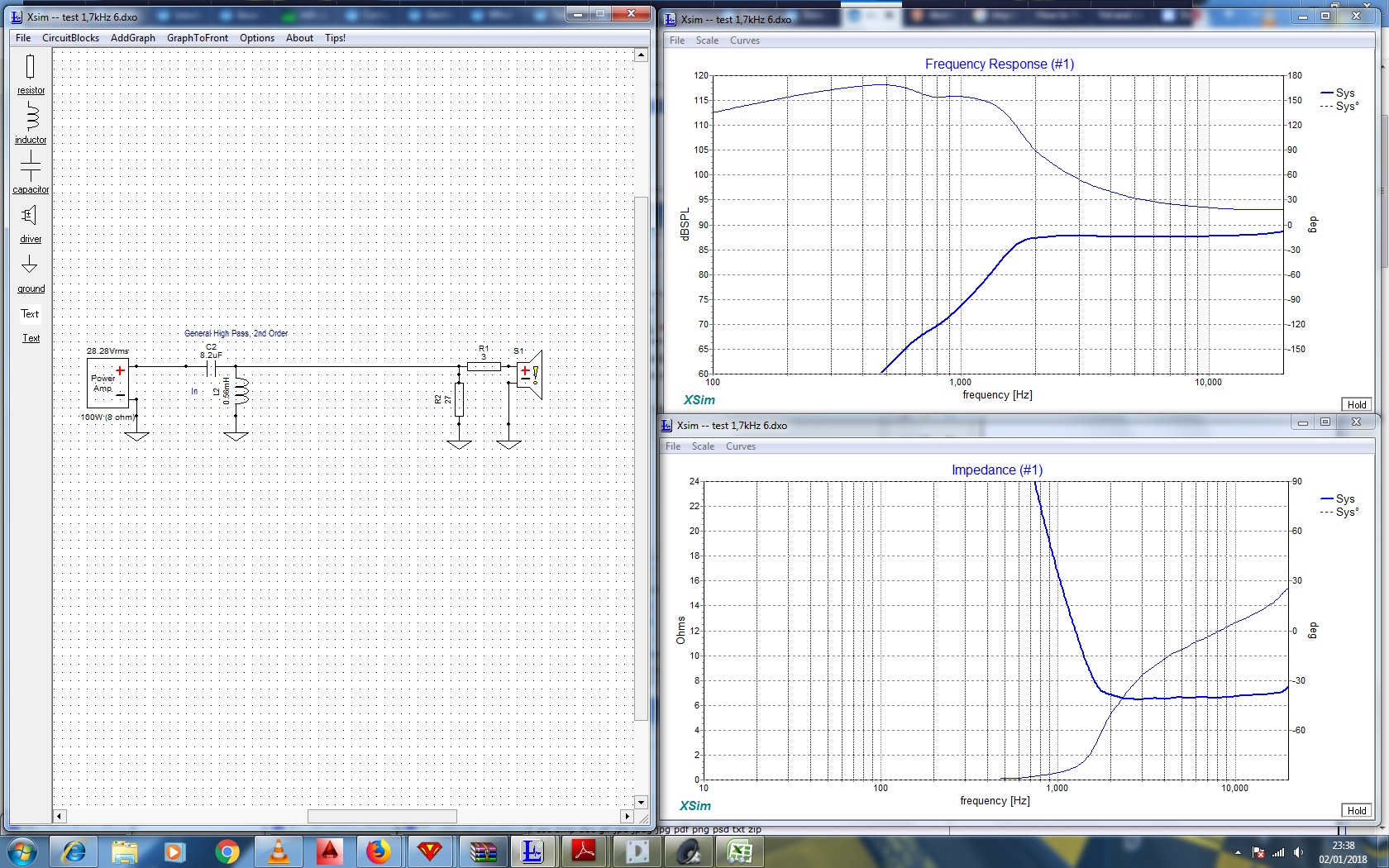

Erik, you´re right, there is not a flat impedance curve with the bypass cap, but I thought it could work since the freq response graph showed it flat with no peaks.
Anyway tried what Icg, Earl and Lojzek said. An L pad made the humps disappear.
The problem is that I dont know yet how much padding I´ll need and playing with the resistors values changes the whole circuit.
This xover is simpler and can use smaller coils for the same crossover freq but wont the resistors affect sound? I have read somewhere that padding resistors made some drivers to sound dull.
This is the schematic I got now.
Thanks again!

Yep. Please keep in mind this is all purely electrical until you add the driver's actual FR! 🙂
One thing to notice is the rise in output at the top octave. This is caused by the rising inductance in the coil. Well, take a look at the driver. The natural top octave is supressed, so you actually WANT the impedance to rise, and get a boost there. It won't fully make up for it, but this is a case where the Zobel is actually counter productive.
