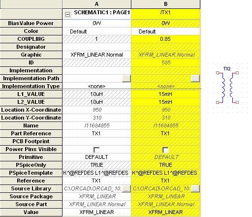

a common mode choke can be modeled simply as 2 mutually coupled inductors each of inductance say L. When they are wired with the correct polarity, the mutual inductance will "cancel out" the total of each self inductance ( M = 2*L), thus for differential currents total apparent inductance = 0, and for common mode currents total apparent inductance = 2 * L.

For a typical CML you want less than 0.9999999 coupling.
The coupling number sets how much common mode vs. differential mode inductance will result. Most "catalog" CML's have intentionally poor coupling so that they have significant differential mode inductance.
I think a number between 0.80 and 0.90 should suffice for most CML's. If you have a datasheet you can calculate it.
The other option is to model it as four inductors: two coupled with 100% coupling, and two uncoupled. The uncoupled pair are the differential mode inductance, the coupled pair is the common mode.

I've faced some difficulties to creat the SPice model with the relvant drawing (Spice part).
I've found the XFRM_LINEAR part (see attachment) which is a transformer build by 2 inductors with coupling factor (=mutual inductance?).
It will work as CMC for defrential mode simulations? How can I test/verify it?
