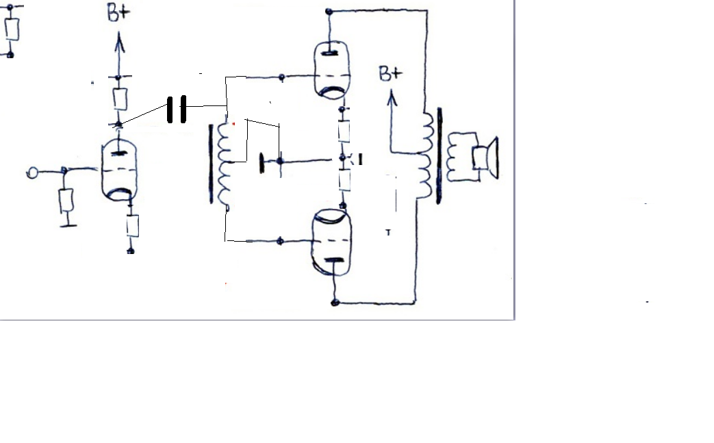

So, I’ve been thinking of something like this, nothing new, with slight additions to the schematics you can find in Internet:
The appropriate for the project tubes: 6EA7 / 6EM7, the Novars 6KY8A, 6LR8, 6GF7A, the Compactrons 6LU8, 6T9 and Pentodes 6AD10, 6T10, 6AL11, 6J10, 6Z10, otherwise the separate driver tubes.
With double pentodes the UL could be implemented on both stages.
Per the calculations for e.g. 6KY8A & 6AD10 the B+ would be 320-350V with 850-900 Ohm center-tapped cathode choke’s full resistance for the output stage.
Want to discuss 3 things:
- Due to low current of driver stage - would the common cathode choke be more beneficial?
- Should the driver stage be rather powered from B+ ?
- The interstage transformer’s secondaries - couple times I saw them connected rather straight to cathodes (red arrows). The thing is that with center-tapped choke the potential between cathodes can reach very high (in some source mentioned 170Vpp in case of KT-88 pair).
Your opinions welcomed.
Very quickly: compute the gain.
If that 2nd stage cathode choke does anything at all, it eliminates all grid-plate gain in that stage.
Yes, the MacIntosh "looks-like" this, but the cathode winding is coupled with plate winding to load.
I'm also wondering about the gain of the 1st stage, windings coupled back to OT. Should be easy to estimate. Me, I'm for bed.

You want the highest impedance sitting under the cathodes of a LTP for best performance. A choke is going to fall well short of what a CCS can do! (You can use a tube for the CCS too)
In your output stage, the choke's presence there will be a disaster for frequency response (more so than it would be for the driver), since you'll have different unbypassed AC impedance depending on frequency, therefore some variable local NFB, and consequently wonky frequency response.

I thought about driver stage gain. Let's put it this way: what if instead of cathode chokes there are R or R+C. Do I get it any better with chokes? Well, not as good as with CCS, but from the purist's point of view (no silicone blasphemy in the Amp!!) this should go "kosher" ))

Unless I have misunderstood you, this CT choke will do the opposite of what you need. A PP OPT cancels DC magnetisation and applies a signal on one side in antiphase on the other side. For an LTP tail you want a signal on one side applied in phase on the other side. You could arrange a transfomer to do this, but then DC would add rather than cancel.
A choke is likely to provide worse performance than a CCS (narrower bandwidth, higher distortion, hum pickup). It will be bigger and heavier and more expensive. In what sense is this good engineering?
