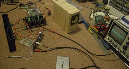

My focus is increasingly on the P101 bass amp at the moment. In fact I hope to complete the unit within a week or two (dependant on getting the metal panels).
Got one channel running now fully off of the proper supply (+/-42V). Other one just needs bolting to the heatsink hopefully, worked fine on test supply.
Can't really fault the sound with the test speaker, noticeably better than other amps I've used even with that quite basic speaker. Certainly should be successful as bass amplification, producing much more controlled bass than I've heard from the little speaker before; but then I knew it would be since I have one running my TL sub.

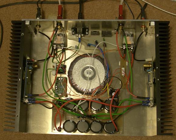

Thought I'd best post an update. The P101 amp is not completely completed 😉 , but in a working state.
It is running at +/-42V DC rails so should generate 80WPC. The transformer is 330VA. Filtering is 4x4700uF per rail. P33 project is used as speaker protection along with some relays rated at 30A 28VDC. Heatsinks are 0.4c/w per amp. Mains is switched remotely via the smaller relay on the mains inlet board (saves switching on the 3 eventual amps manually 😱 ).

Sounds good so far, very dynamic and good tight bass. Abolutely silent too, even with ear pressed to speaker. Need to do some higher power tests, want to feel those heatsinks get warm 😉 . Could probably do with some cable ties before its finished.

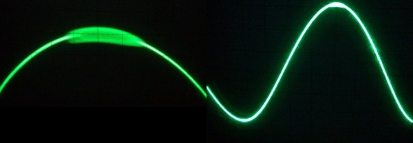

Been running power tests into 8ohm resistive dummy load, 56W RMS. Both channels work pretty much flawlessly. There is a (hopefully) minor issue though with some possible oscillation. I attach the waveforms, left is zoomed in on the bad part and right is overall how it appears. 500Hz sinewave is the source. It varies, this is at worst, it can be virtually invisable (took me some time to notice it). Otherwise, the heatsinks just get warm and the transistor packages are quite warm (can keep finger on them indefinately), so no worries there.

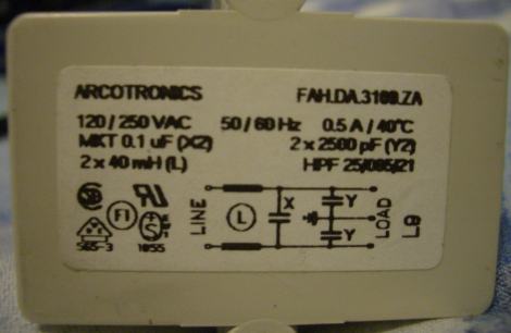

I seriously doubt it would, but could a mains filter like pictured help with this problem? I think it is more for getting rid of high frequency noise but could the twin capacitors to earth help "balance" the feed? Looking at it it says 0.5A rating too, and I could be taking 1A so perhaps it can't be used anyway, though I'm not sure how something like that has a current rating.
