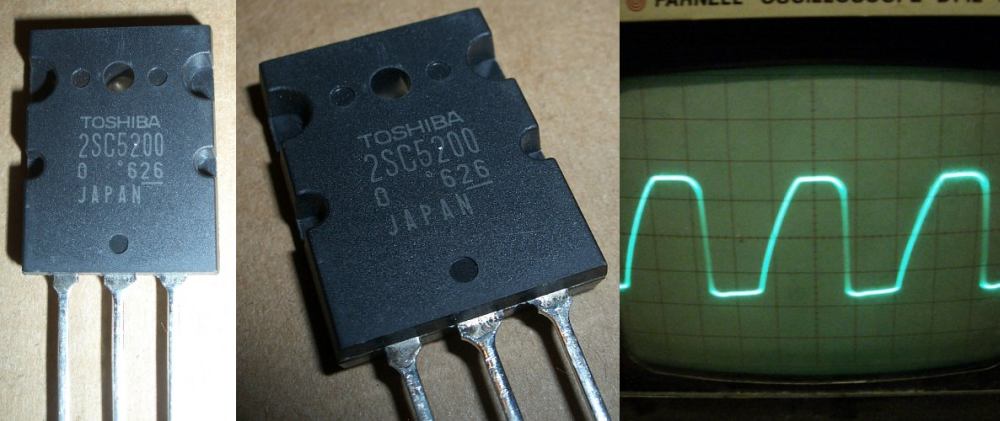

Thanks for your reply 🙂
I checked the output on the scope. It is around 14.3Khz oscillation at full amplitude. Other interesting points are that the oscillation starts as soon as the bias "cascades". Idling at around 0.03A, that small movement of the dial suddenly ups the bias to over an amp and the oscillation starts; it may even be the other way round with the oscillation triggering the sudden bias increase?
Tried earthing the sink, it had little effect, perhaps changing the frequency of oscillation marginally 🙁
It may come to changing these output devices, pity the MJL21194 is so expensive. Apparently the 2N3773 also works and is cheaper, but is also TO3 which makes mounting more difficult; by the time I have aluminium angle it may cost the same.
I attach pictures of an output device and the scope trace (set at 20uS, 10V)

Yes, it is very likely that the starting oscillation triggers the bias up.
From the photo, the Toshiba at least look like genuine, no obvious fake.
~14khz is way too low frequency to expect from an oscillating amp, check all soldering, all devices for correct polarity, resistors/caps to have correct value. There is something very wrong...

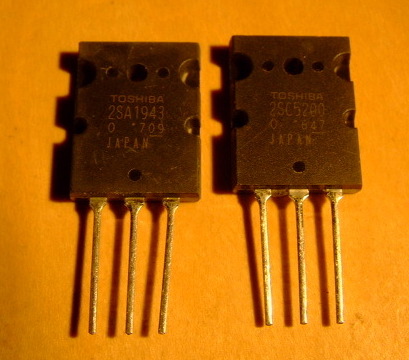

MikeB said:From the photo, the Toshiba at least look like genuine, no obvious fake.
At a second look, comparing with other devices, you see that the printing on yours uses the wrong font...
Sorry, they are very likely to be fakes. Does someone have an up to date picture of ROHS-Toshibas?
Mike

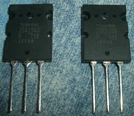

my Toshibas are not printed. I think they have used a laser to leave a very feint trace that is difficult to read until the light is at just the right angle.
The 4 indents in the sides are for clamping the backplate into the moulding machine. The clamps always leave part of the backplate showing where the plastic is prevented from flowing under the clamps.

Pink's left most device shows the bare backplate where the clamps were during moulding.

Yes, i am also missing the metal shining through in Dr.EMs parts in these clamps/holes. Also, the printing is too readable.

Thanks for the responses. Now I know what to look for I understand what you mean. Interestingly I compared them to my 2SA1943s from the same supplier and the metal shows much clearer. I show a photo of this comparison.
The 2SC5200s do also have a marking in this area, it looked like a very thin layer of plastic and so I scratched it off with a knife and it revealed shiny metal underneath. Would a fake still do this?
The writing shows up much clearer under the flash (at angles at least). In normal light it is only readable in certain positions (pretty much anywhere so long as light is not reflecting straight off of it). hfE is around 60 on most devices, oddly around 80 on 1 of the 6.

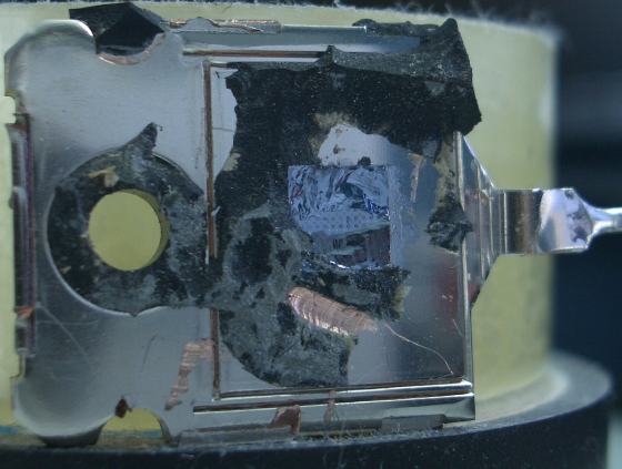

I had to try and settle this so I cracked one open. Unfortunately I don't have a Dremel or anything so a hammer and chisel were all I could use. It's in quite a state but you can kind of see the silicon die still.

That die looks pretty much like the real thing.... you must have some other issues... did you design your own PCB, or are you useing an existing board?

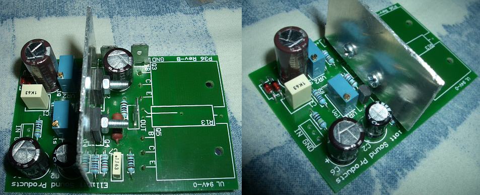

Hmm, I'm using the Rev-B board from Rod. It's so simple and neat that I just can't see any possibilty for problems. The only thing is I have left the input "open", not shorted or with a source connected, but that shouldn't be a problem? I've tested every part, even capacitors, and checked every solder joint (by measuring continuity further down the track). I've removed any flux which could cause a problem. Here is a photo of the PCB.

I think a photo of how the boards are placed realitive to the heatsink may also be usefull... I had some issues too, where the board was fastened over the heatsink but with only enough clearance to avoid shorts... I guess it was a capacitive effect... lifting the same boards to about 1cm from the sinks cured the affliction...

The boards soldered joints have a clearance of under 1cm from the heatsink due to the thickness of the output packages, but the board is designed with this mounting scheme so I can't imagine it causing any trouble? None of the joints are spiky or stick far up from the board.
