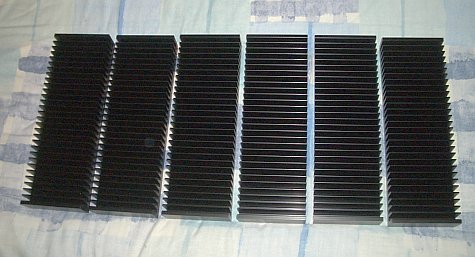

First will be the DoZ amp. I can use 2SC5200 as the output devices right? This is my plan anyhow, with 35V supplies.
Among other bits I have the heatsinks already. The class-A amp calls for fairly large units and there was a price break at 5 on the 0.4c/w ones, so I've ordered 6 with which I can do all the amps. Oversized for the symasym and P101 (at 80W, 42v) but hey they can never be too big right. Also gives the amps similar (identical) appearance with these sinks forming the chassis sides. Found a local supplier of aluminium for the top and bottom too, 4mm planned thickness.

Cheers, got them from Farnell:
http://uk.farnell.com/jsp/search/productdetail.jsp?sku=1211720
Reading the description you'd expect plain unfinished aluminium, I know I did. The anodized black is nicer though, shame the other panels won't be matching. Fronts will probably be plywood to save them looking too plain/industrial overall.
