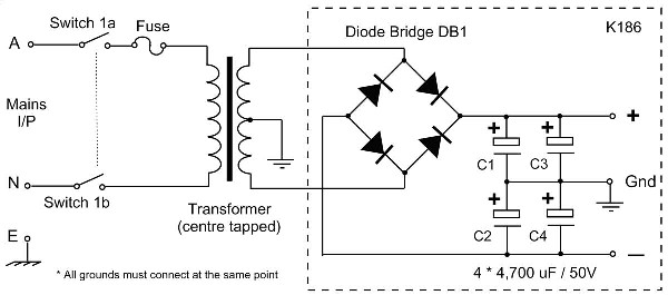

Lm4780 repurposed power transformer
Peter,

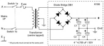

I am about to construct one of your wonderful kits and could use some advice please. I have a power transformer from an old Sugden P51 (~50 watt/ch) class AB power amplifier that I would like to use along with the chassis. The dual LM4780 kit power supplies seems to want a transformer with 2 secondary windings (|_| + |_|). The Sugden transformer has dual secondary windings with center taps (|_|_| + |_|_|). The voltage reading across the secondary winding is 60 volts AC and half that for the center tap. I was thinking of using 1 power supply circuit/board to drive 2 LM4780 circuits/boards in bridged mode, using the 2 x 60 volt secondary windings.
The Sugden power supply made use of 4 capacitors with the center tap as ground.
Can you suggest the best power supply design based on the transformer?
My thanks in advance
Peter,
Your 60Vac centre tapped transformer is equivalent to 30-0-30Vac.
That is considered too high for all the National Chipamps that are limited to less than or equal to +-42Vdc supplies when signal is present.
The highest one can use is probably 230:28-0-28Vac used on a 220Vac mains supply, or
230:26-0-26Vac used on a 240Vac mains supply.
Your Sugden may be rated for 120/240Vac and that will help slightly. Does it have multiple primary taps?
You really need to measure and predict the worst case maximum voltage you will get from your proposed PSU, BEFORE you connect capacitors and/or chipamp.

Andrew,
Thank you for responding so quickly to my question. My house hold line voltage in Canada is 120 volt at 60 hz. The Sugden transformer has multiple primary taps; 0, 110,120, 220, 230 & 240.
Are you suggesting perhaps using the 110 volt primary to drop the secondary voltage to < 30 volts?
Ron
Ron
NO !
Use the higher of the two 110/120Vac taps.
This will slightly lower the output voltage.
But you must measure your transformer to find out the worst case highest PSU voltage.

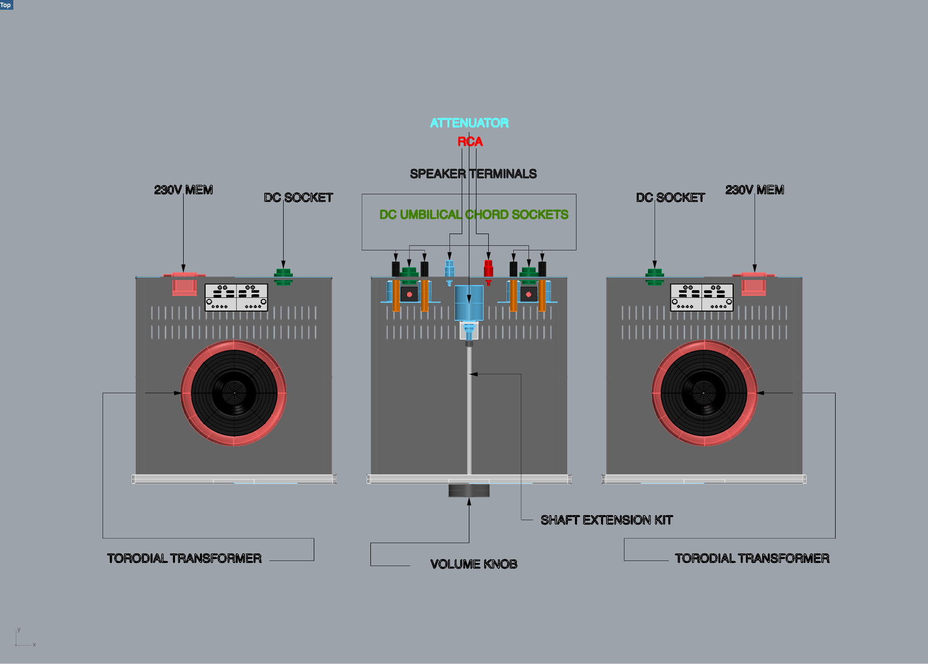

I have not yet finished my Audiosector kit.
I´m sorry for not posting sooner, but my project has been at a standstill since I last posted.
UPDATES:
I.
I have now three different larger chassis. 230X230 mm ( height = 80mm )
Two; for each power supply.
One for the amplifier.
They all have the same dimensions
See attached jpeg file named LAST DIGITAL SKETCH.
II.
I have now also a shaft extension kit for my DACT stereo attenuator that I will install in this amp.
THIS MEANS:
That I have all parts needed for this build.
FURTHER QUESTIONS:

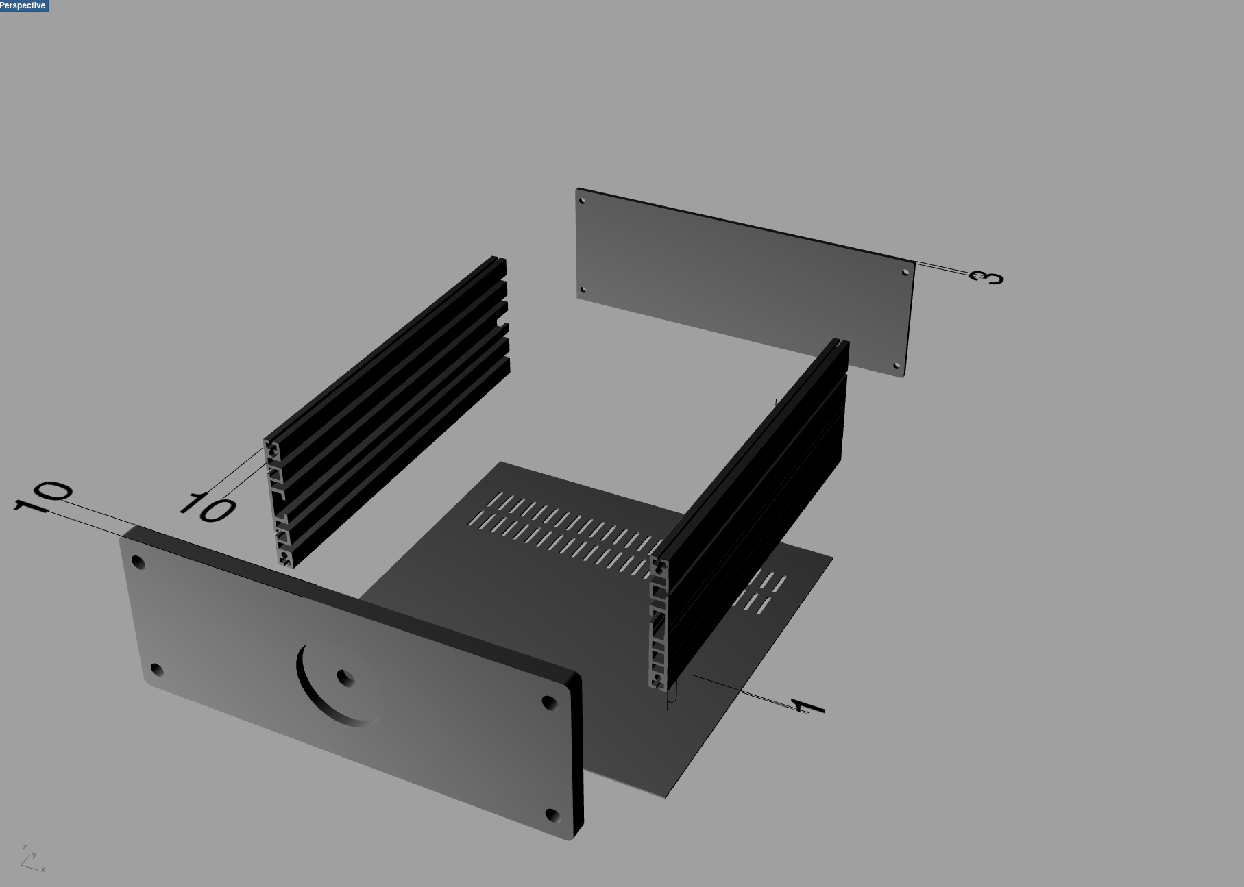

My new chassis has the following thickness dimensions :
two sidepanels ( heatsinks ) = 10mm.
frontplate =10mm.
backplate = 3mm.
and
top and bottom panel = 1mm.
See attached jpeg file named THICKNESS OF CHASSIS
Will the main chassis; where the amp boards will be installed ; work well in transferring heat from the LM3875 chipset?
PS: I will keep you posted on this further build to be certain I get this right first time around ;-)

Hey Endre,
How about installing a nice big heat sink in the chassis? Looks like you have plenty of room in there!
Tim
Tim

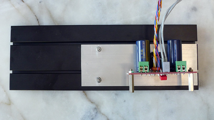

the front panel will be able to spread the heat out better than any of the thin panels.
I had the same problem with the same hifi2000 case and LM3875..
I add a plate of alu (4mm)..
Phil.
