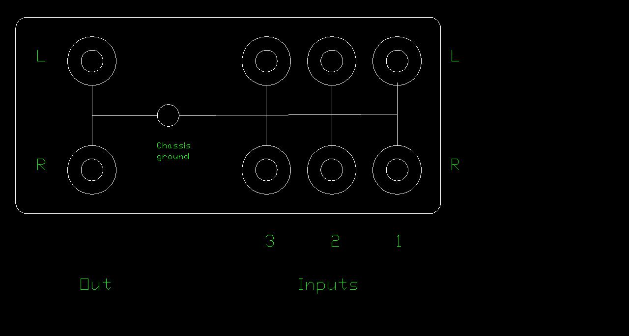

I am going to build an input selector. Attached you can find a drawing of the wiring I intend to use for the signal grounds (input and output).
Is this wiring correct or can I improve it in particular to reduce the risk of ground loops?

looks right
