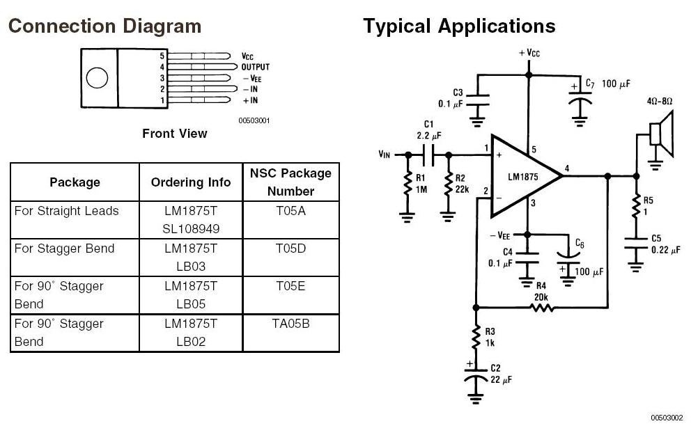

While the projects described so far were using printed boards, I would like to present now an elegant way to build an amp circuit without PCBs, using point to point wiring technique.
It so happens that I recently received an order for LM1875 amp, which I never tried before, so there was not other way as going p2p.
The amp circuit as presented in National's datasheet:

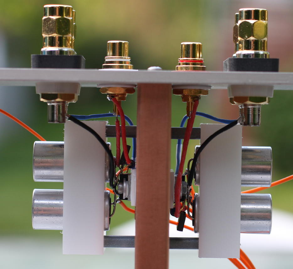

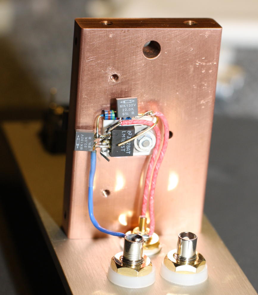

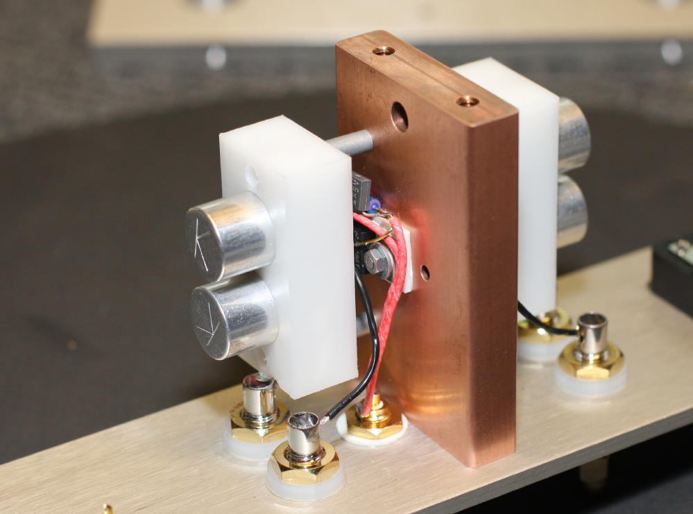

I'm using my standard chassis and start with mounting the chip to copper heatsink. The chip case is not insulated, so isolation pad is required as well plastic washers under the mounting screw (an aluminum oxide pad was used here).
I also install 3 famous resistors: 22K for input shunt and feedback and 1.5K gain setting Riken. The customer asked for lower gain that's why I didn't use 680R as usually.
You can also see input wires coming from RCA socket (23awg silver wire from DH Labs) and speaker output wire (19awg Kimber TCSS)

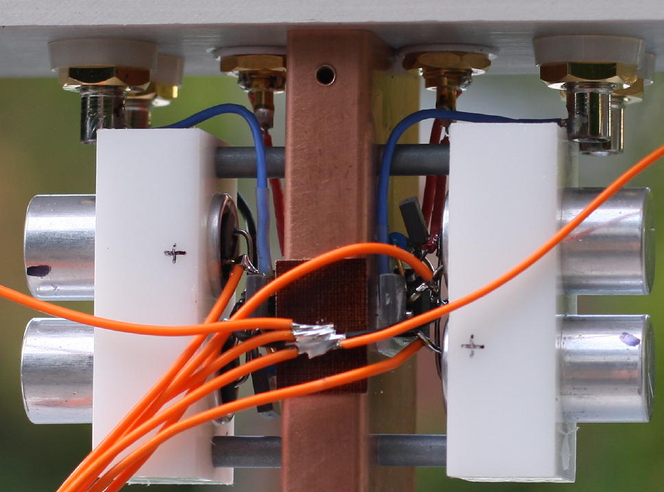

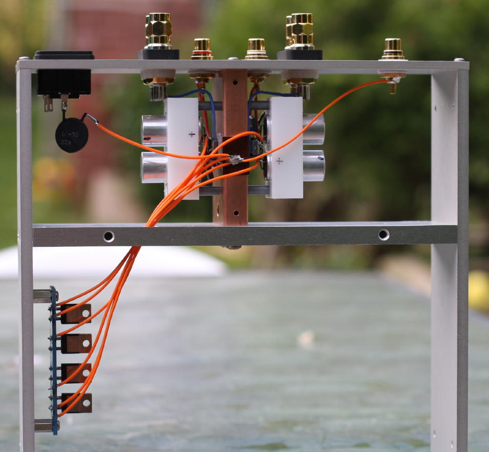

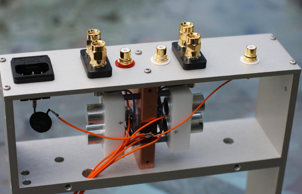

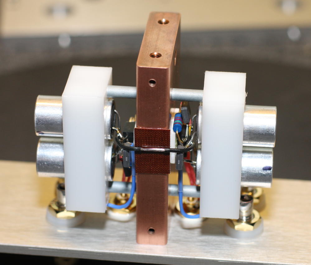

The power wires from rectifier board are directly connected to cap pins (2 for V+ and 2 for V-), the ground wires from rectifier board connect to common star ground point at the center of previously mentioned (black) wire.
From here, the common ground point is connected through thermistor (CL-60) to Earth ground pin on power entry module (chassis is not grounded yet, awaiting installation of bottom panel), the additional RCA is used to connect external devices to amp's star ground (customer's special request)

Peter Daniel said:
From here, the common ground point is connected through thermistor (CL-60) to Earth ground pin on power entry module (chassis is not grounded yet, awaiting installation of bottom panel), the additional RCA is used to connect external devices to amp's star ground (customer's special request) [/B]
Hi Peter
Could you please tell me more about this thermistor and how you connect it? I experience a rather loud "thump" in my speaker when I shut off other components before I shut off the amp. I suppose this thermistor is ment to help on this problem?
Best wishes
Jan Ove
