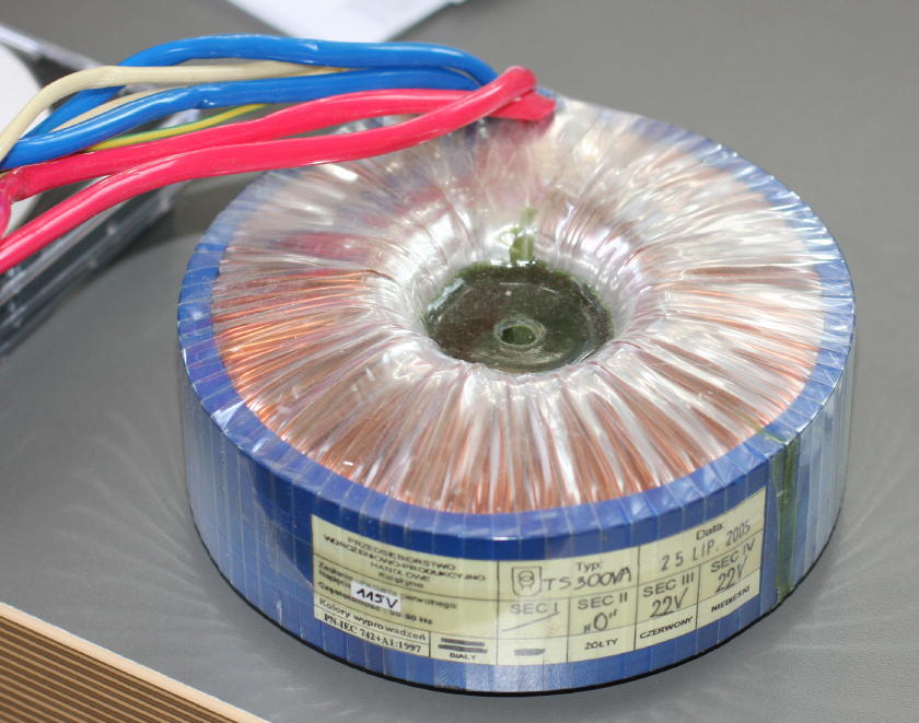

samoloko said:It Is not encapsulated
All transformers I got from them were encapsulated.
As to amplimo, they used to be related, but I'm not sure if it's still the case.
I thought that these transformers are Impregnated
and the encaplsulated are like this http://toroidy.pl/Obrazki/kubek.JPG
