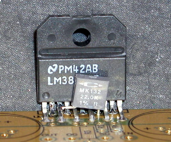

Rnfb premium kit question.
Hello all,
This question is for anyone who has built Peter's premium 3875 kit.
It seems there are multiple options to mount the Rnfb resistor on the board. I can place the caddock in the spot marked "Rf" on the pcb or it seems I can mount one leg on the tiny hole by pin eight and solder the other leg to pin 3.
What is the preferred method?
Thanks!
Hello all,
Thanks!
