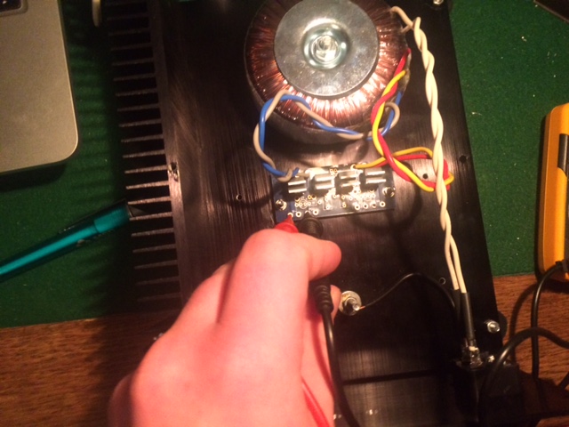

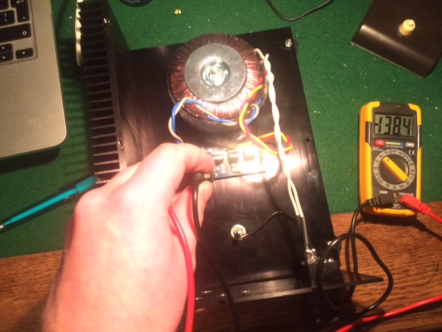

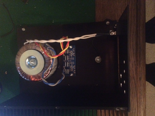

Sorry, creepy hand pics will have to do. I connected everything as per page 26 in the manual, and measuring as pointed out a few pages below that with the con lead on the PG side and the red one on the V (- or +). Thanks in advance.

I'm beginning to doubt my sanity here - AC 1 and AC 2 both give a figure of around 154-155-ish. I don't think that's supposed to happen...
I've had that problem a while ago with another project.
It seems that i had both the secondaries crosswired and that gave some very strange readings.....
Take a new ac measurement between the two secondaries, perhaps they made a mistake with colourcoding the secondaries.
If your DMM is only suitable for less than 300Vac, then check your probes.

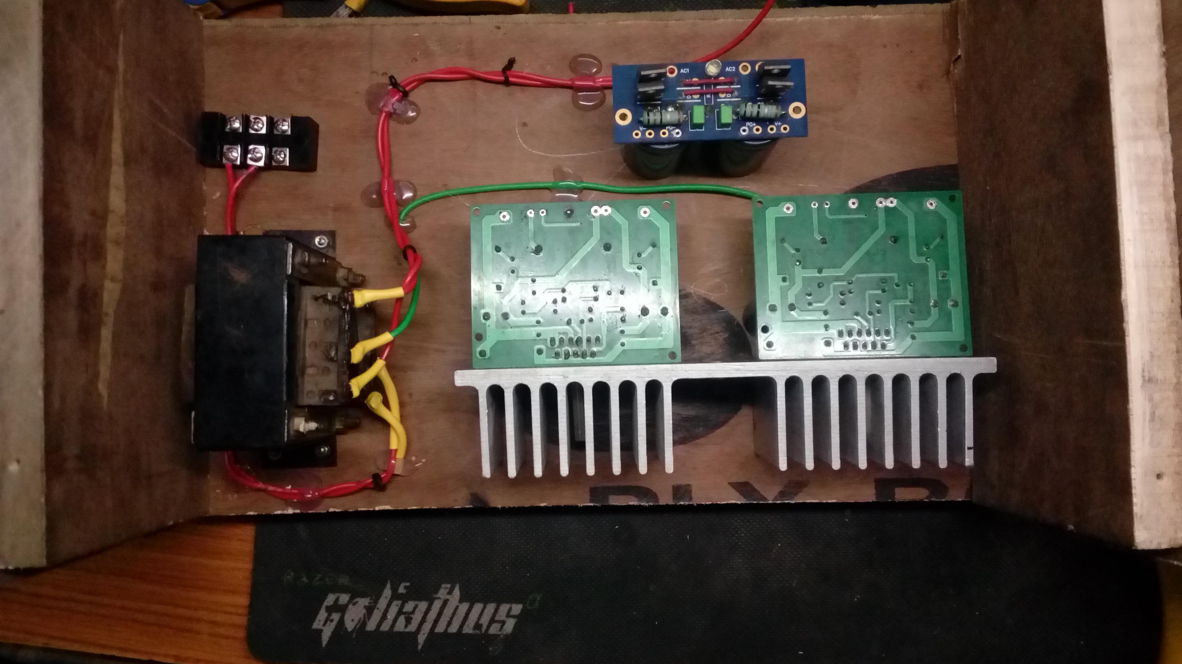

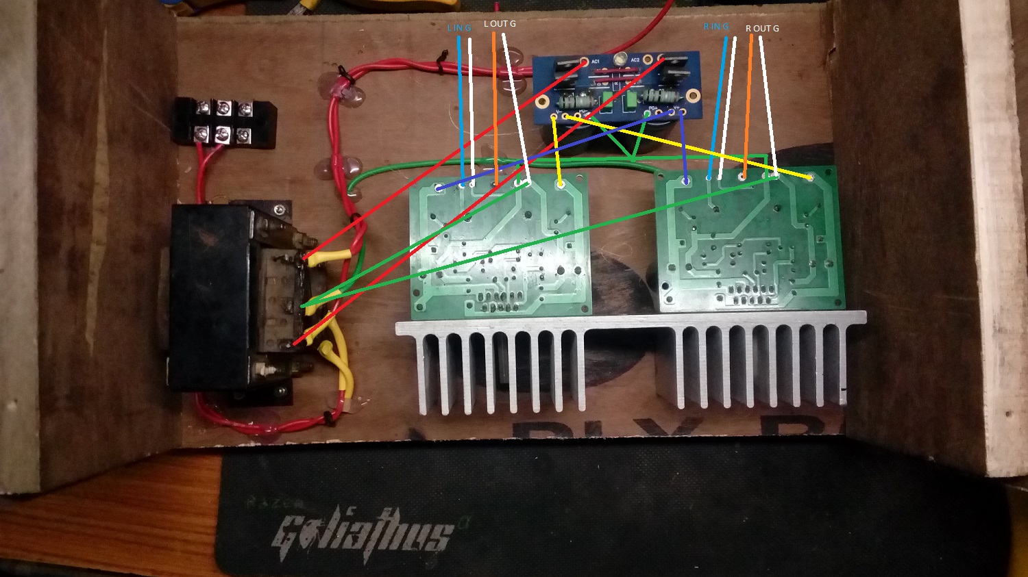

Is this is how all the wiring should be done ?
Please excuse shoddy MS Paint job ;)
despite quoting the text of my advice you are again asking for my opinion, so I'll repeat my opinion
use a twisted triplet from transformer to rectifier and from rectifier to smoothing capacitors and from smoothing capacitors to amplifier.
AND keep the loop areas small. That means no single wires trailing randomly across the enclosure.

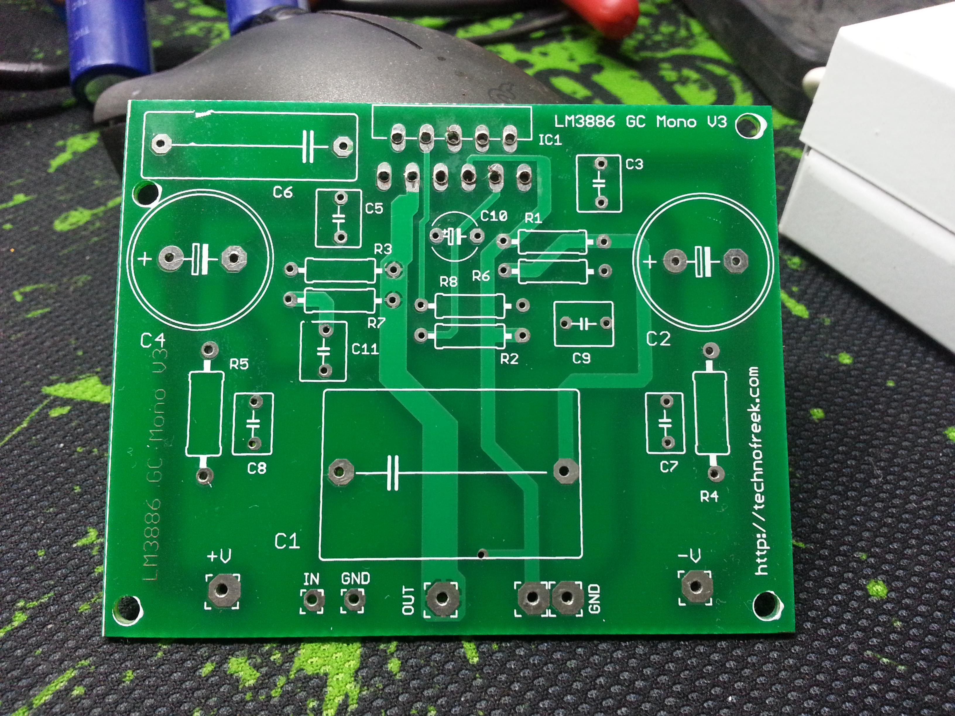

Is that an audio sector PCB?
It states "technofreek.com"
I think you are in the wrong section.
