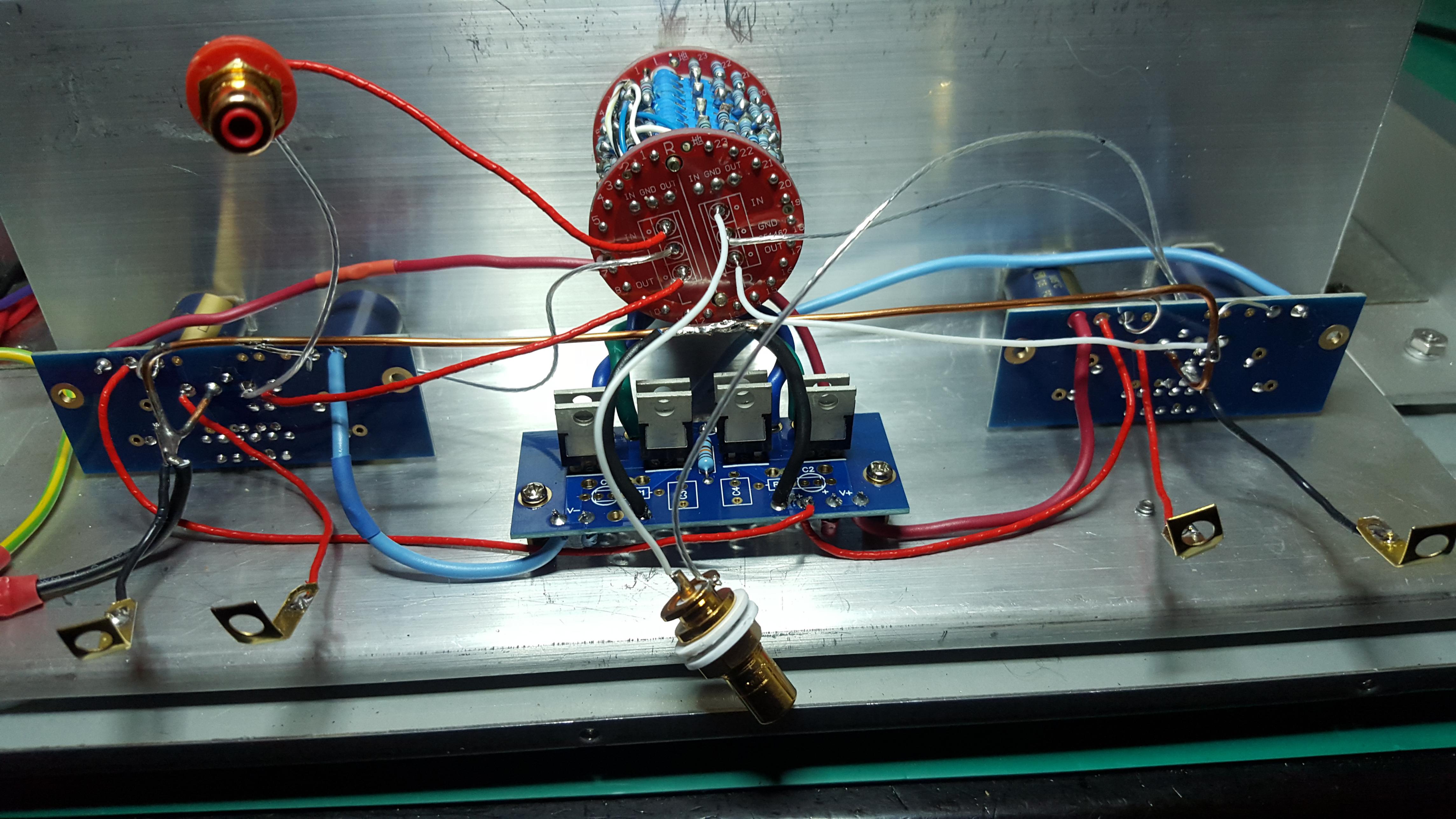

I am now almost ready to fire this thing up. Ive got a quick grounding question, i havnt put the chassis earth on the amps yet but its regarding input ground to the boards. Its going to be a single input system for now, this will feed my LDR which has one tiny screw clamp for a common return so i have joined them together as you can see at the top of the pic. Thats all fine, the rca's at the bottom are outputs to my plate amps, as with the ldr the DCB1 only has one common input/output return and I am splitting the signal to the 3875's. My plan is to run the DCB1 3 output wires to the lower RCA's then run links to the GC's, so SG for both boards will be soldered to that copper link between the output RCA's. I dont see any other sensible way to do it and at the end of the day the returns always meet up somewhere but I thought it worth asking in case Im doing something that will result in noise, I could just suck it and see but I will sleep better asking the question first.

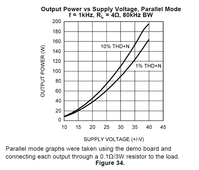

25-0-25 300va will be OK for parallel lm4780? i have 2 Kits from AudioSector and want to drive 8ohms speakers in parallel so will get something like 4ohms.... im looking more power. was using 3875 kits and now will
Hi, Ive been dragging this out for a long time,I am now almost ready to fire this thing up. Ive got a quick grounding question, i havnt put the chassis earth on the amps yet but its regarding input ground to the boards. Its going to be a single input system for now, this will feed my LDR which has one tiny screw clamp for a common return so i have joined them together as you can see at the top of the pic. Thats all fine, the rca's at the bottom are outputs to my plate amps, as with the ldr the DCB1 only has one common input/output return and I am splitting the signal to the 3875's. My plan is to run the DCB1 3 output wires to the lower RCA's then run links to the GC's, so SG for both boards will be soldered to that copper link between the output RCA's. I dont see any other sensible way to do it and at the end of the day the returns always meet up somewhere but I thought it worth asking in case Im doing something that will result in noise, I could just suck it and see but I will sleep better asking the question first.
The only sensible reply I can give you is that we will sleep better if you first do it and then ask questions 😉
In cases like that it's alwyas best to check datasheet. Page 14 shows a following graph; such transformer is acceptable and you'll be getting approx 140W with parallel config into 4 ohm load.
Thanks will get some improvement using 2 transformers instead one? i found 2 transfformers with 23-0-23 300VA at home 🙂
