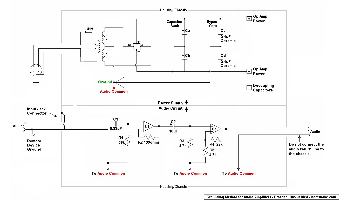

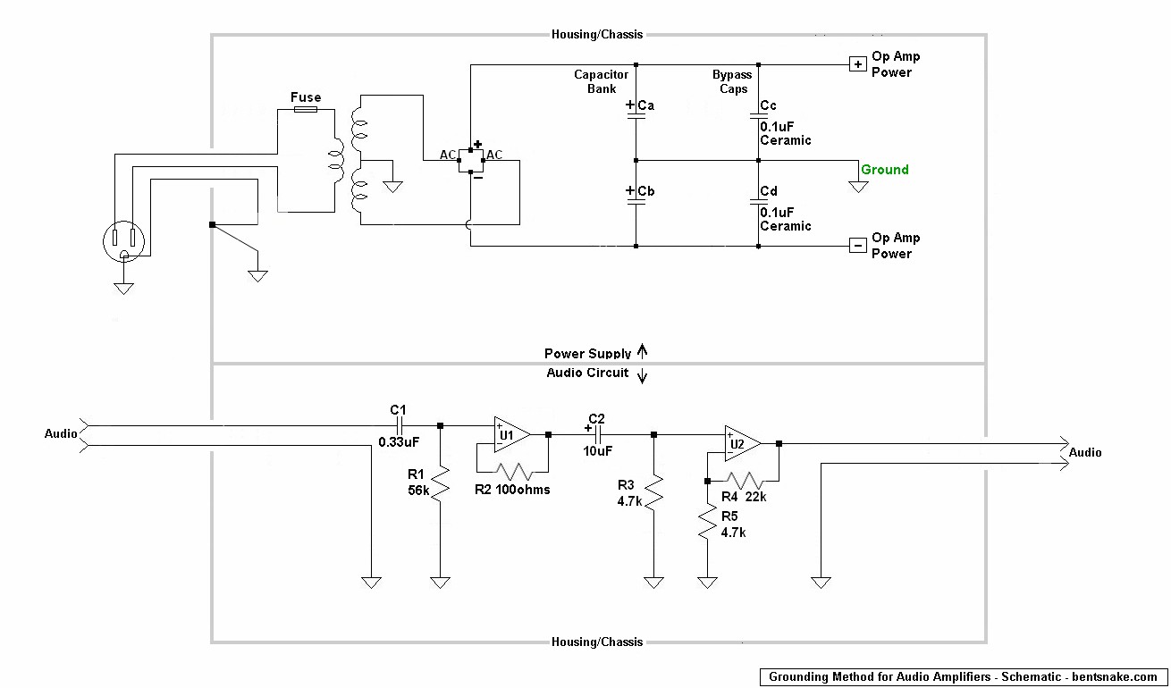

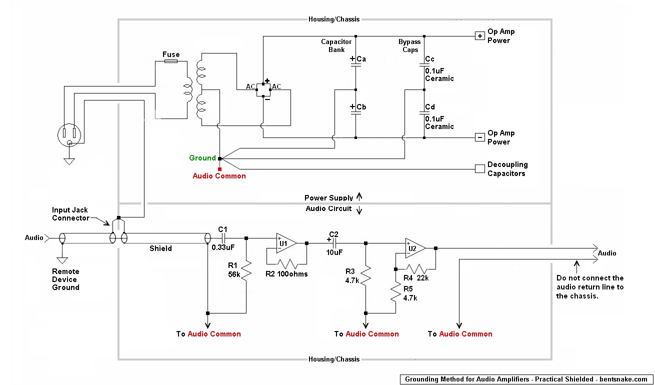

Would anybody like to comment on the grounding scheme posted below?
The principle here is to minimizer audio distortion by keeping the audio signal away from power supply voltages and currents. But at the same time the entire cicuit must be grounded with a "safety ground" which does connect audio to power, creating a contradictory situation.

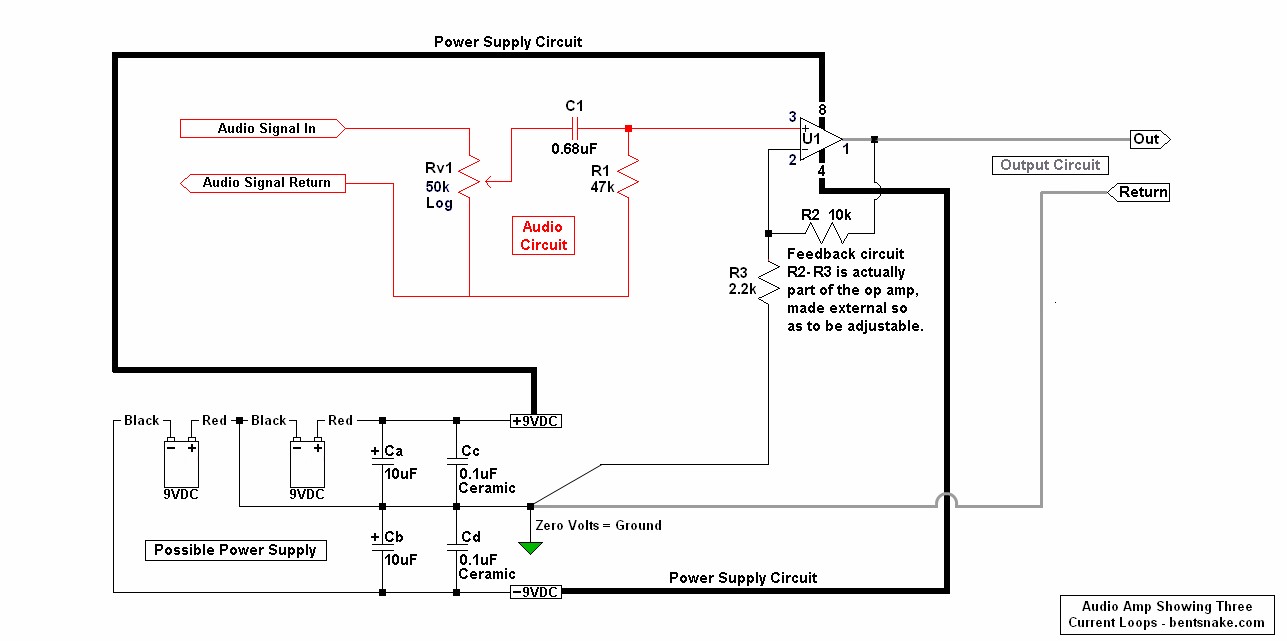

This contradiction is dealt with in various ways by various gurus. The goal in the circuits posted below is to comply with every mandate laid down by every guru there is, individual or corporate. The circuits are intended to be not schematic, but practical, showing real-world wiring and connections.
All three circuits are electrically the same. The first is for reference, drawn using the customary schematic symbols. The following two circuits are practical, the difference between them is whether a shielded input conductor is used.
If I've made mistakes, or have misunderstandings, I'd be very glad to hear about them. Looking forward to hearing about what I've missed, misinterpreted, or just plain not caught onto.

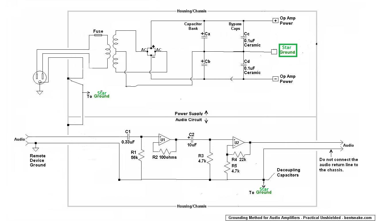

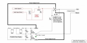

Fourth option. This is a more audio friendly layout.
Smaller audio loops. Smaller power loops. Moved PSU GND. Removed input ground loop. Removed high inductance (one for all channels) decoupling GND. Added GND loop breaker. Moved mains earth chassis connection.
I've used this scheme in commercial units. The chassis is 'loosely' connected to signal ground using small value (<10 Ohms) resistors and having the power company ground hard tied to the chassis as required by code. No problems at all. Best rule is never use the chassis as a conductor, only as a shield.
G²
post2 is much more likely to work.
Post1 is rather misleading in that it mixes up a whole lot of "grounds" that are actually parts of very different circuits.
Yes, all the circuits in post 1 inject PSU charging pulses into the audio ground. Post 2 is the way to go.

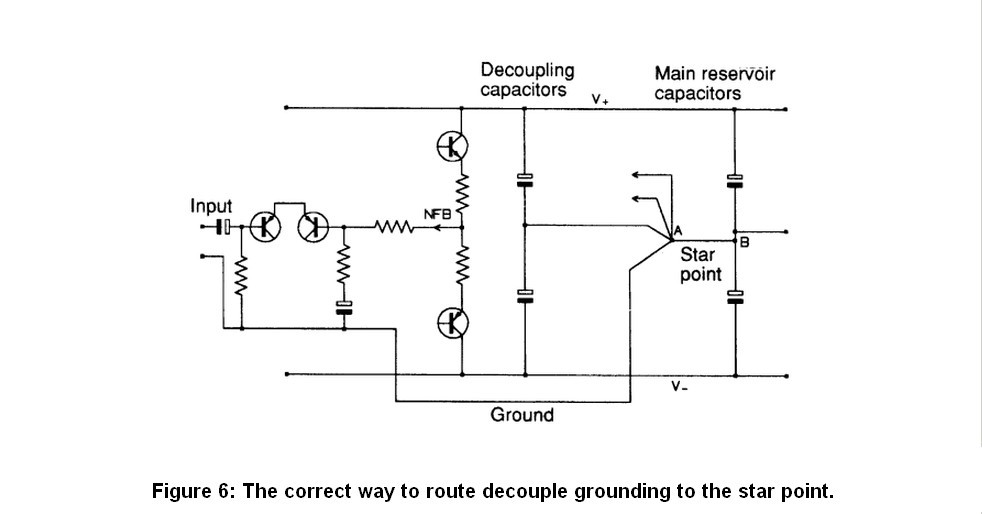

The first illustration below is from Douglas Self's, "Self on Audio." This is figure 6 in Chapter 21, section titled, "Distortion 5: supply ground loops," page 272. Note the separation of the capacitor bank return from the decoupling cap return, and the provision for additional returns to what Mr. Self calls the star point. Do not fail to study Mr. Self's explanatory text notes.

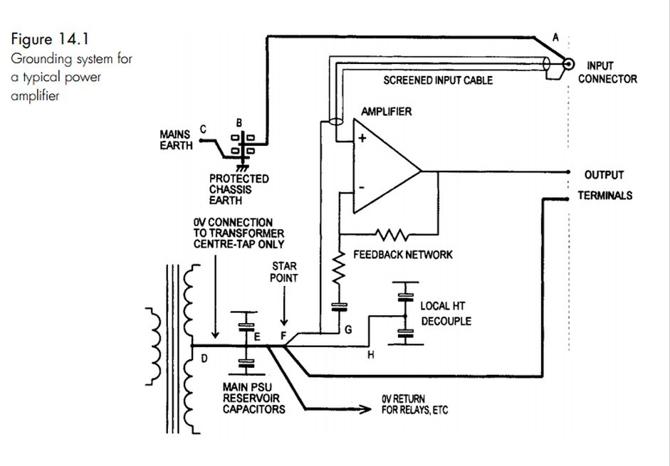

The second illustration is from the same Mr. Self's, "Audio Power Amplifier Design Handbook," Chapter 14 titled, "Grounding and practical matters," section titled, "Power amplifier PCB layout details," page 402. This illustration gives perhaps the best overall view of the concepts involved.
Especially important here are Mr. Self's text notes throughout the chapter, in which he explains, among other things, why the audio-to-chassis ground connection should be made at the input connector.

Now that you have named your sources it will be easer to explain why the differences in layout. The TI layout (figure 2 of TI link) doesn't take the inductance of the ground trace/wire into consideration. The decoupling capacitors plus the inductance of the ground connections form a Low-pass filter (CL). The ability of the capacitors to supply current to the opamps and receive current from the PSU is severely reduced. There will probably be oscillations caused by the higher inductance but this will also depend on the components used. Please do the simulations. I also cant see how to design this without creating larger loops.
Perhaps you could post some links of PCB designs or amp designs that use multiple connections between the PSU GND and the AMP GND.
In the past I have looked at the PCB layouts of the D. Self power amps and he uses a completely different layout. He likes to have large +Power/-Power/GND loops, placing the positive and negative decoupling (and the power rails) as far apart as possible with each decoupling capacitor having its own trace to PGND. On at least some of his designs he has the output return very close to where the PGND enters the PCB and places the input GND as separate as possible.

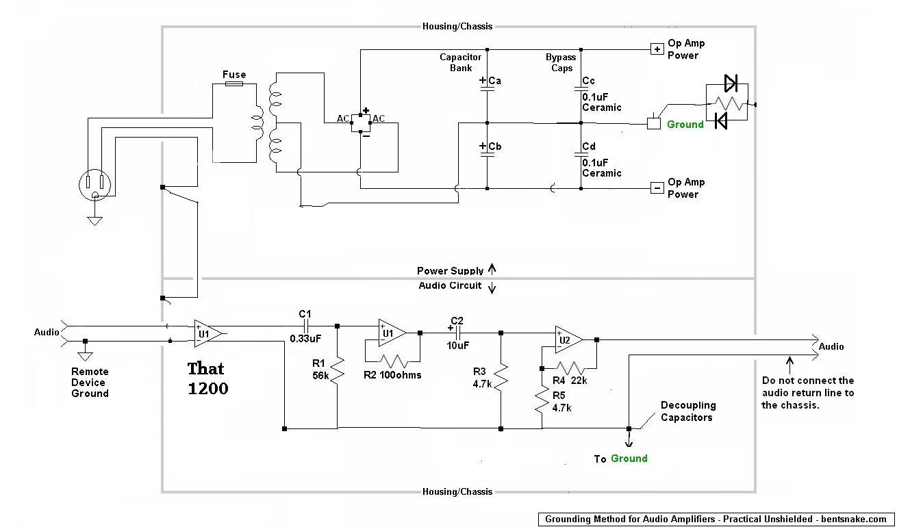

No ground loop breaker?
Can the ground loop breaker and THAT1200 be omitted and use a Star Ground (near the PSU output) with wire running from the Earth and Audio Gnd?
I am not sure what the THAT1200, quick search shows it's a balanced line receiver? Looks like it isolates the input/remote audio device ground from our circuit. Can I do without it?
This was just an example of a grounding layout. As a design/layout it is incomplete.

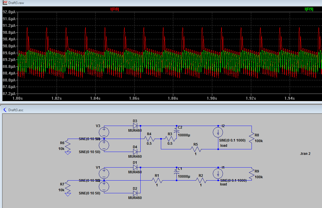

Since you (bentsnake) said you were looking for answers...
Consider the pic attached. It's a simplified power supply but it will establish the principles. The 1R and 0.5R resistors simulates the wires' resistance. Ignore R6-R7, they only establish a reference for the simulator. The currents through R8-R9 show what happens accross the audio loads (I1-I2)
The top setup is what you are proposing. See how we have 100hz spikes ?
The bottom setup is what has been suggested in post 2. See how those spikes disappear ?
<< The top setup is what you are proposing. >>
No, it's not, it's something entirely different.
It's functionally identical to a single rail version of your scheme. Explain why it would be "entirely different" ?
To say it otherwise. Look at the first post, third pictures. The "common" ground is halfway on the wire going from the CT to the reservoir caps. This is what is illustrated as wrong in my sim and what post 2 corrects.
<< It's functionally identical to a single rail version of your scheme. >>
So it turns out that a half-wave, single-rail circuit is functionally identical to a full-wave, dual-rail circuit? Forgive me if I think not.
Which at once tells us that further discussion would become an argument over the meaning of "function." Absolutely no point in going there.

This is a dangerous proposal (and technical it makes no sense too - go to a Class-2 design if you want the ground float)!
Read the relevant legal restraints before using a ground breaker.
Think of what happens if the transformer has a fault and 230 V appear at the output?
Can you be sure that the circuit breaker will not be blown before a 35 A fuse?
At least use small fuses on your power inlet and a Class-2 transformator.
And be prepared to justify your abondon of "the state of the art" at court if something terrible happens...
