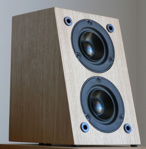

I did a small HT Presence speaker using dual NE95W-04 drivers wired in series. I played some music through them prior to installing them in the HT and couldn't hear any odd effects (e.g. combing) compared to the single driver. Sounded quite fine through out the operating range. The HT speaker setup didn't pick up any odd sharp dips and peaks other than a suck out at around 400Hz which is a boundary effect.
The main reason for using dual drivers in series was to obtain a better impedance for the HT amp, reduced excursion and better power handling. I did look at the 1.5 way series option but didn't like the additional 100uF cap which would have made it harder in this very small enclosure as well as during listening trials, wasn't worth the effort.
The design also allows these to be used for Atmos if required by laying them on their back and firing to the ceiling.

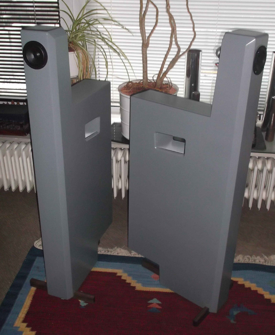

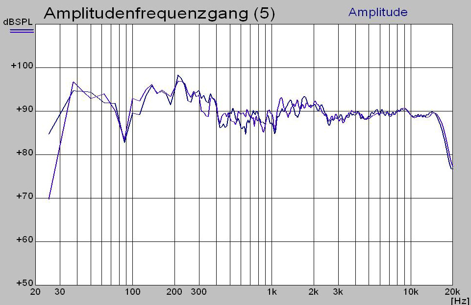

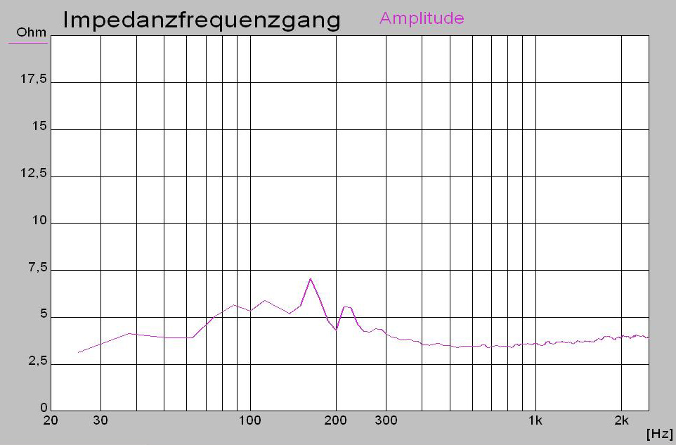

bipol
if the room is integrated in the construction there is no problem,
look for example my MINI POSAUNE, room measurement, a lot of gain,
but 35 Hz in 22sqm and the point is the impedance.
3 points i miss: reducing of K2 by invers combination, distance between the driver,
impuls combensation, bass more than 1 oktave below driver reso.
