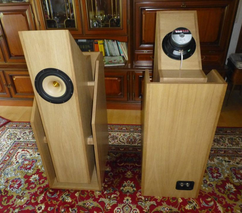

Hello,
why do you chose that driver, no data, expensive for the quality,
easy make a coil ~8 mH at + of the seccond driver.
Look your country look SICA.
in my double horns you can increase the bass around one oktave deeper in Bass,
your driver is not useful in horns.

Using two drivers will allow you to EQ the low end more to your liking without running into trouble as soon as with one.
In other words you increase dynamic range.
Using two drivers, it's a terrible waste to low pass filter one of the drivers.
Instead you have a chance to improve directionality of the top end.
To combat attenuation due to interference in the highs do one of the following:
- Splay the drivers (angle them out from each other horizontally).
- Put the drivers one above the other as close as possible. That will limit the radiation pattern vertically which can be beneficial in certain settings and is was to accommodate in many cabinets.
- Finally, you could put one of the drivers on the back in bipole setup to have it reflect of a hard back wall.
