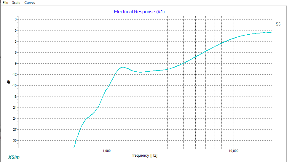

As one example;
Here's one compression driver/horn combo that's pretty straight-line ( in it's downward slope from 2.5K on up ) for a driver.
These traces done by Zvu ( are from the Peerless DFM-253508 on the 152i Clone from B52 .

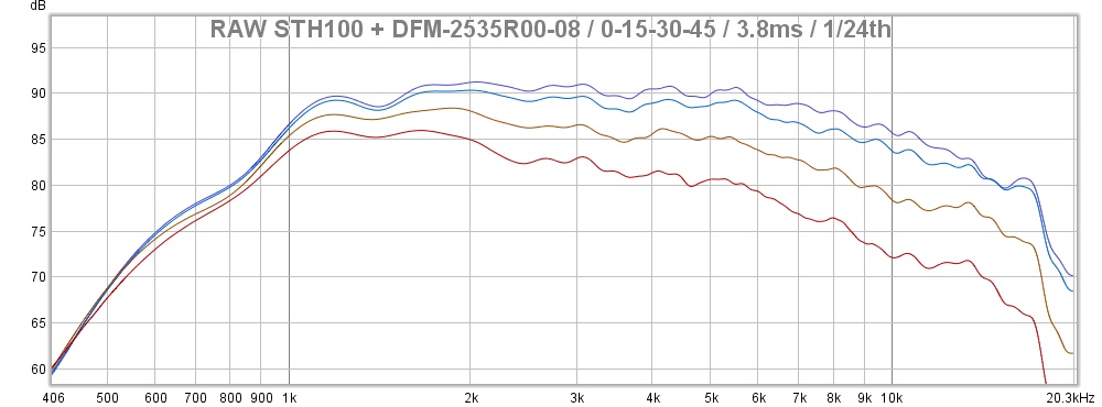

Here's an example where it's not really practical to combine the 2 functions of HiPass with that of Response Flattening .
This "Trace" belongs to "grahamgraham" .

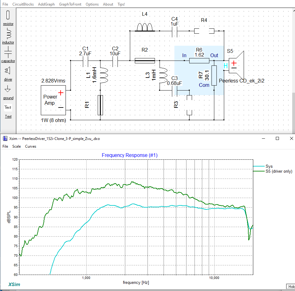

Kris,
Here's an example of a filter that combines the functions of the HiPass with that of a HF Compensation Circuit ( which flattens the overall HF response ).
This is one of my Peerless drivers on a 152i Clone wavequide.
BTW; R1 + R2 are bypassed here ( iow; they are not in circuit so ignore their presence or values ) ).
- The same "out-of-circuit" observation applies to the 2 pictured PEQ circuits seen ( L4,C4,R4 + L3,C3,R3 ) . They aren't active + are not there ( functionally ).
This filter also employs a mild "Bump-Filter" ( at cut-off ) to PEQ boost a small area .
Here's a shot of the filters transfer function.
Again, this combo approach is only doable when the HF response presents a "good-enough" straight line.
These simple horn circuits are quite widely found in many Sound Reinforcement crossovers.

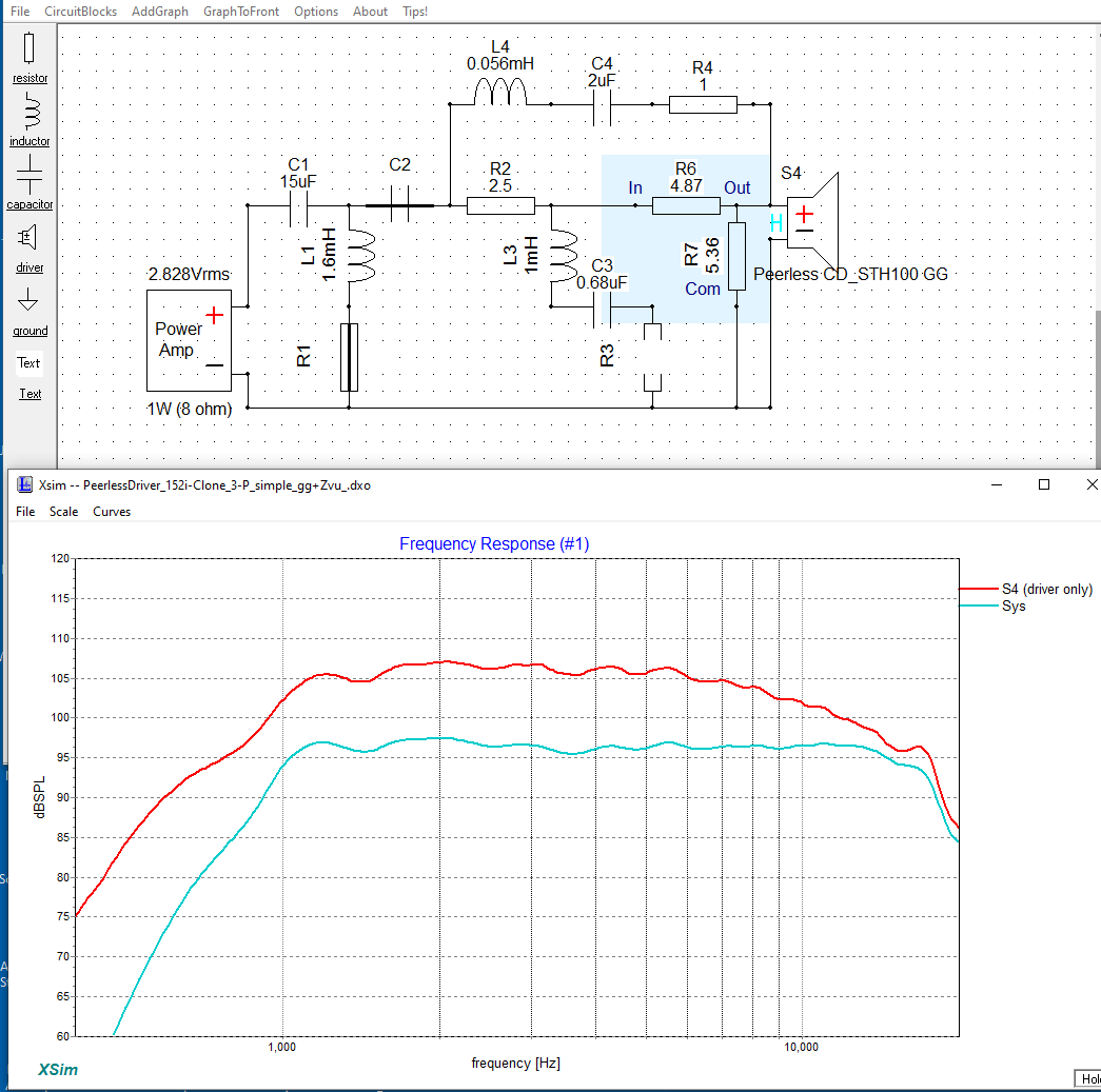

Here's a look at one way to handle the gentle roll-off curve seen in grahamgraham's trace of the Peerless driver on the STH100 waveguide.
Again, C2 is shorted and the LCR notch ( L3,C3,R3 ) isn't engaged.
The red curve ( seen above ) is the raw response ( I've used a zma file from my own files to make this happen > so the simulation is only so-so ).

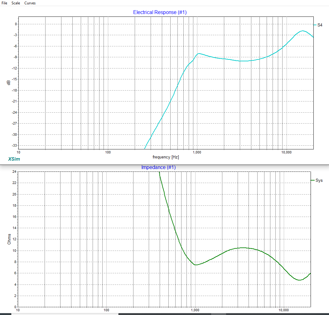

And here's what the electrical filter is actually doing along with an impedance trace.
- Both "Peaking" filters betray their presence ( when looking at the dips in the overall impedance ).
