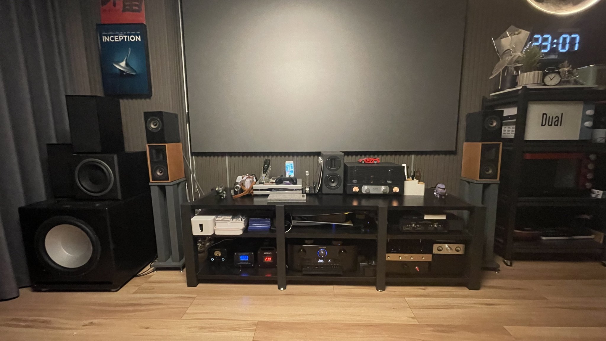

My approach to combining active and passive crossover has been sorted out decades ago. I selected 150Hz as crossover point between woofers (two, not one sub) and two mid-tweeter boxes. Hence i have many active crossovers set at 150Hz.
Then i build many midweeter sections, easily swapable on top of the woofers, optimized with their own passive crossover. I use biamping, so difference in sensitivity between woofers and mid-tweeters is no issue. Other advantage is that small wattage amps are enough for top. Another advantage is no need to have way to many bulky floorstanding speakers around to clutter. Its easier to build and store mid-tweeters (bookshelfs).
I totally agree. I currently use two subwoofers (one 15-inch and one 10-inch) to take care of sounds below 150HZ, and the others use small bookshelf boxes with my Marantz8805 preamplifier for low-frequency management. The advantage of this is that it can Get very good mid- and high-frequency imaging and positioning, and very easy replacement of bookshelf speakers.
