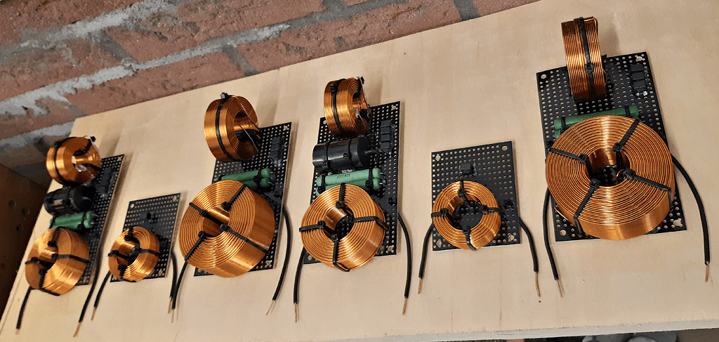

I mix passive + active xover when I need better integration of bass frequency with subwoofers in a 3 way floor standers or 2 way systems with fullrange + low extention driver. That way I can play with low frequency eq and delays without affecting high range drivers to better gel with the subwoofer.

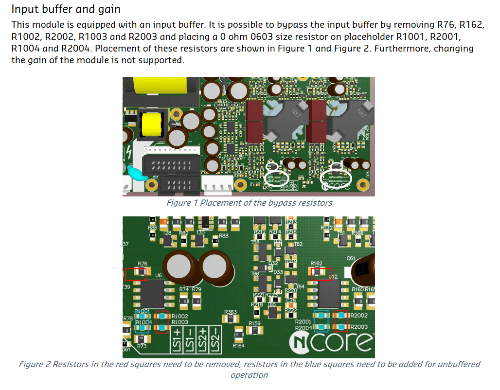

Not true for the FA122 with several typical drivers (efficiency of about 90dB per Watt). The self noise is low but especially at low listening distance of about 1m you can hear the self noise of the amps. My question here is it worth to lower the self noise of the amp slightly by using a high pass or low pass or does the passive components degrade the signal so that the self noise is a better trade?
It's a shame, the Stone Age of gain mismatch between DSP and amplifier still exists.
The solution requires soldering :-(
Buffer deletion 13.5 dB less amplifier gain.
Check out the screenshot
