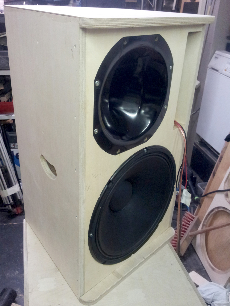

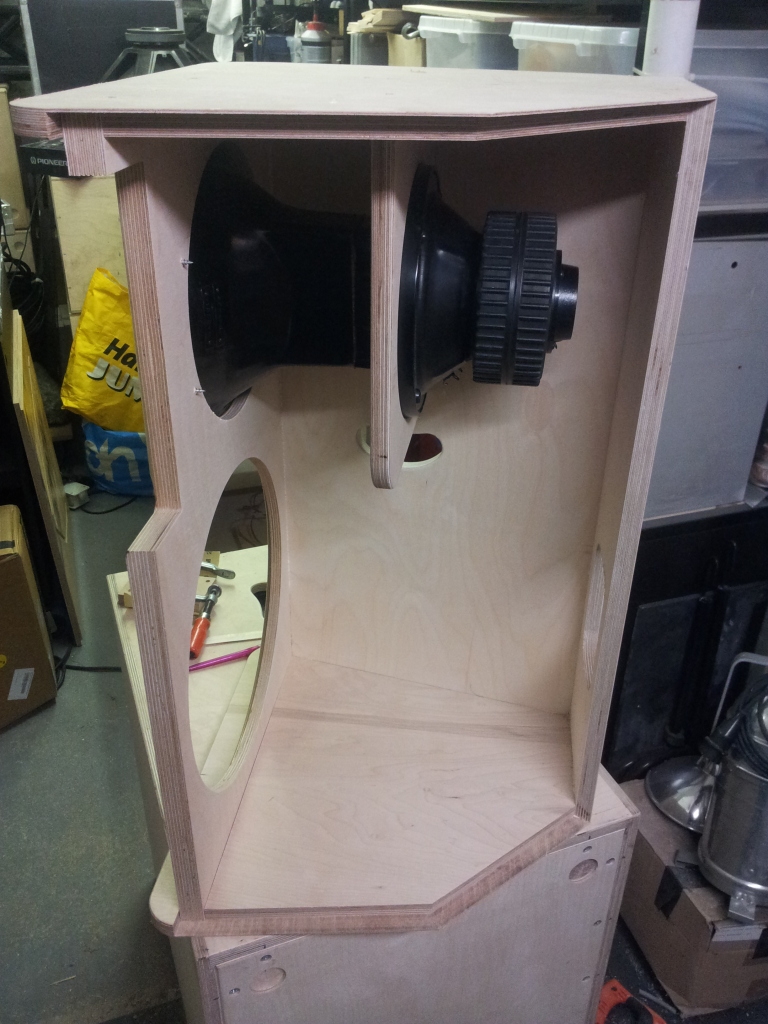

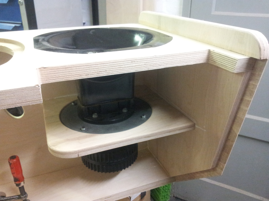

I built a 90x60 elliptical by using hornresp comparison of the beamwidth of different directions, specifically to avoid pattern flip by having them open up at the same frequency. Turns out the narrow direction needed to be wider (higher) than the other angles before going to half space, to maintain this.
If I'm not able to make the finish look good, at that point I could wrap the entire speaker in grill cloth a la Vandersteen.
That would make it look a lot like this:
I think your challenge here will be to keep the cylindrical profile, where the horn is cut out into the cylinder. You would have to have a metal mesh underneath the grill cloth, and either force it to the same profile via pressure, and tacking it above and below, or have it rolled to match the profile of the cylinder.

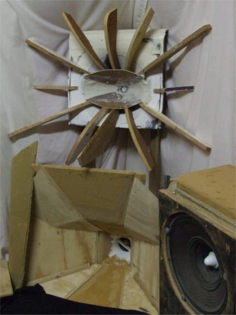

Just some food for thought. I'm having a hard time finding a picture of it, but I understand that many people who build multicell arrays 'shade' it by stuffing some of the cells with foam.
As I understand it, the foam plug that Geddes put in his speakers was originally going be along the walls only, but then he wound up filling the entire waveguide.
And last of all, it might be possible to 'shade' a multicelled horn by using individual drivers for each cell, then power tapering the cells to 'shade' the horn.

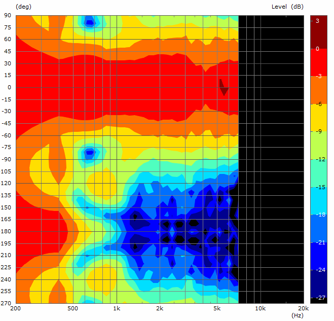

As I understand it, the Lambda Unity Horn was basically a 'scaled down' version of the Sound Physics Labs TD-1. The tweeter is the same and the midranges are the same. The Lambda Unity Horn uses a horn that's about half the diameter, and the woofers are Lambda instead of whatever is used in the SPL TD-1.
Follgott's new speaker has a baffle that's 31cm wide. With a baffle that wide, you'd expect to see the directivity collapse around 1100hz. (1100hz is 31cm long.)
But it doesn't. Here's the polars. You can see that the beamwidth grows wider, but it widens slooooooowly.
Obviously, those woofers on the side are doing SOMETHING but I wasn't entirely sure WHAT.
There's some clues in the crossover. The midranges and the woofers are playing at an equal level at 580Hz.
Here's my theory on what's going on. In a speaker with one midrange, the sound will start to wrap around the enclosure below 1100Hz, because the wavelengths are longer than the baffle. (illustration on the top left.)
If you put TWO midranges on the same baffle, the pattern narrows. This is because the midranges combine constructively in front of the baffle. (In the illustration on the top right, you can see how the drivers combine.)
If you put TWO midranges on the same baffle, along with two woofers on the side, it looks like you can approximate the performance of an array that is physically larger. (illustration at the bottom.) The speed of sound is constant, so by juggling the delay and the geometry of the woofers, you can produce a wavefront that's shaped as if the woofers were actually spaced further apart.
In other words -
To control directivity down to 580Hz, you need an array that's 59cm wide. FollGott's array is 31cm wide. The speed of sound is constant. So you can use DSP delay, or physically delay the woofers, to create a wavefront that mimics having the woofers physically spaced 59cm apart.
Obviously, this would require some trial and error, but I imagine that's why FollGott made a BEM model. (Pseudo-coaxial with narrow directivity (and Horbach-Keele filters))

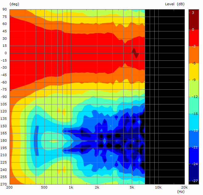

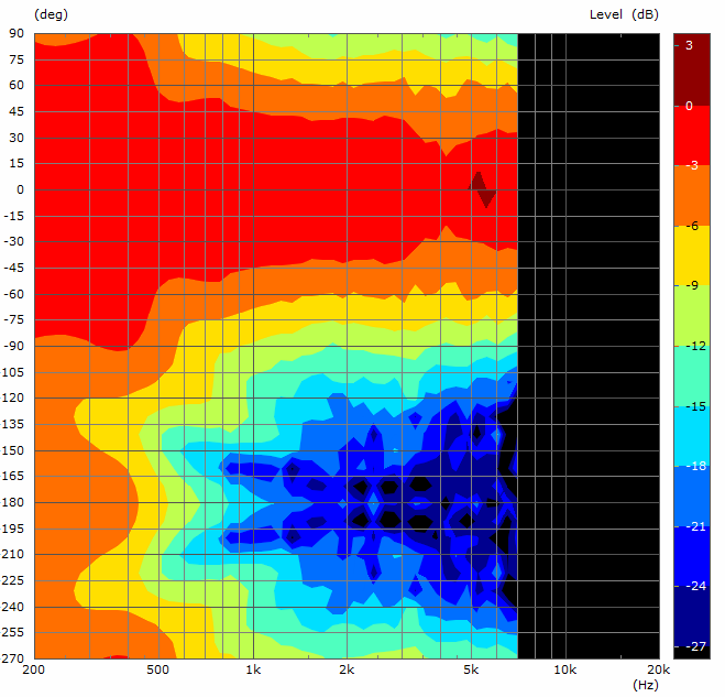

I think you are right. The trick is the overlapping of the woofers and midranges. In this range they form some sort of array.
Only front woofers:
attachment.php
Only side woofers:
attachment.php
All woofers (front drivers delayed):
attachment.php
As you can see the front woofers alone widen faster below 1 kHz and much faster below 500 Hz.
The side woofers alone narrow directivity in front hemisphere, but significantly radiate in the back hemisphere and produce side lobes at 800 Hz.
With all woofers enabled and the front woofers delayed most of the problems in the back hemisphere are attenuated and still the directivity is narrowed in the front hemisphere.

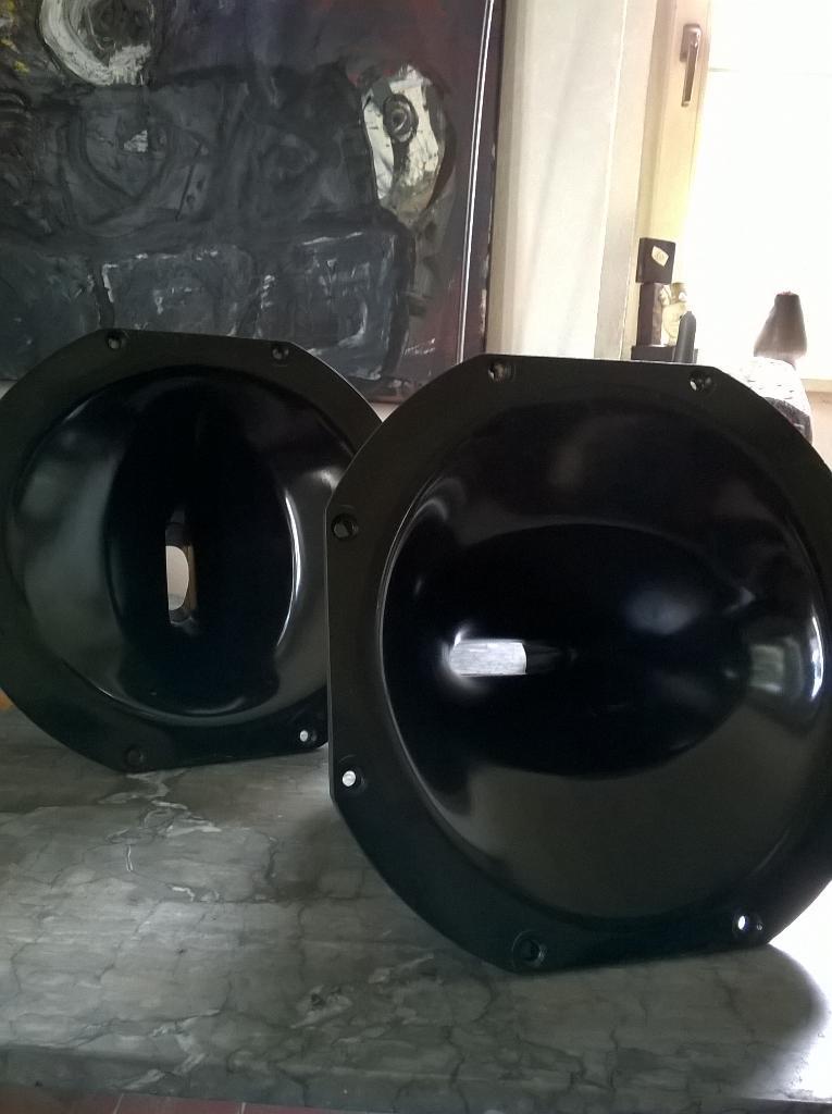

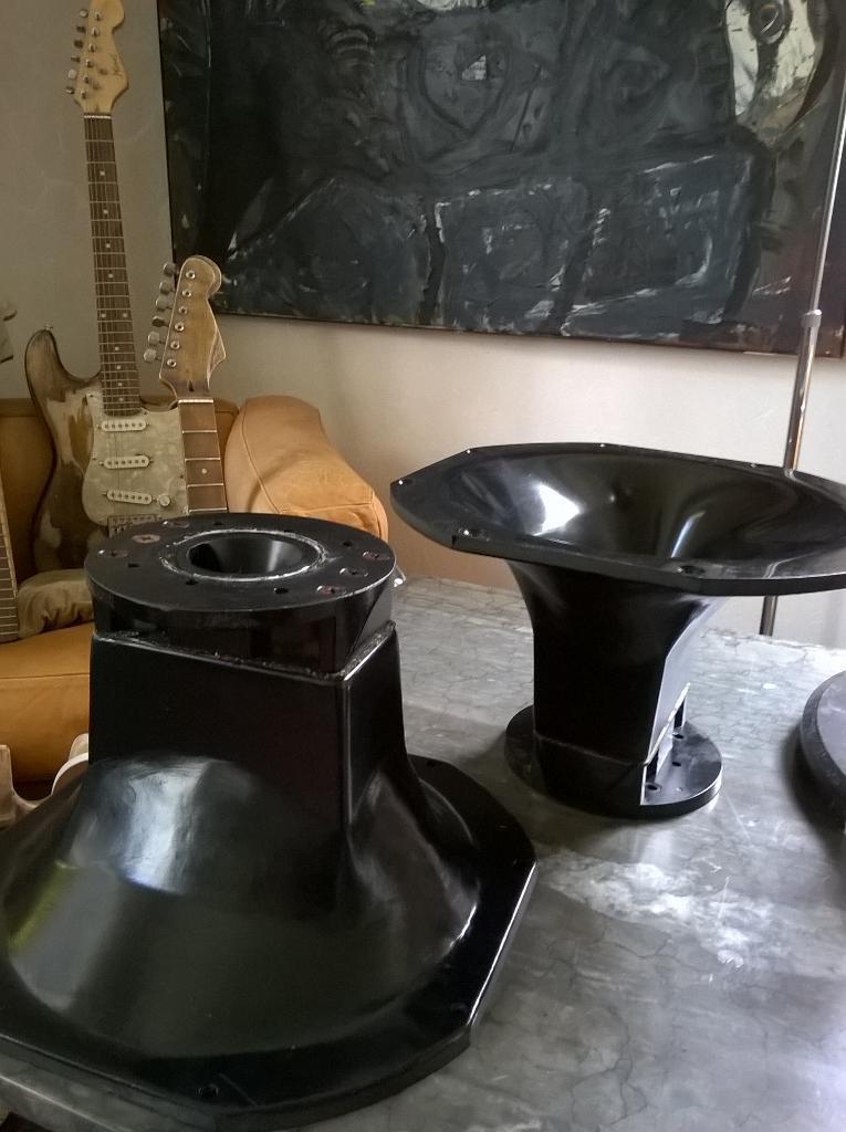

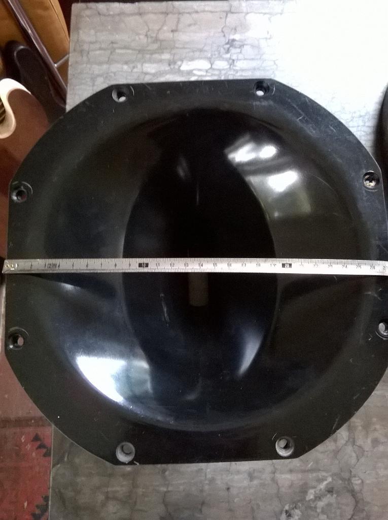

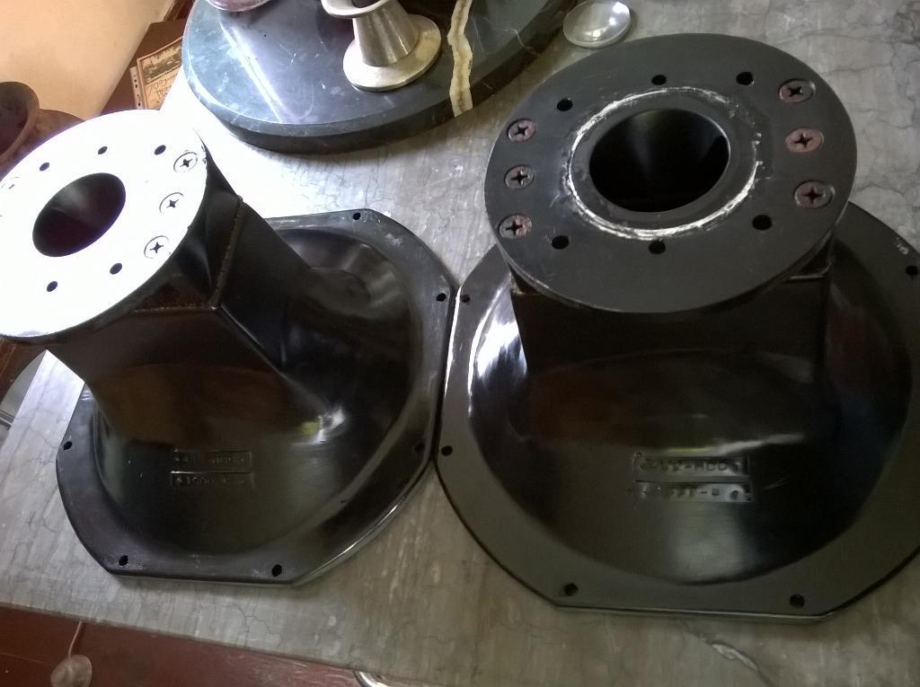

This is an interesting and often marginalized subject in horn related discussions.
A few months ago, I was tempted to buy a pair of Renkus-Heinz Complex Conic Horns that were offered on a local ebay marketplace.
For a number of reasons I let them pass, but I did save the images.
At the time I wasn't convinced these horns would work with my 2" drivers, or even work at all without the compression woofers, as shown below.
