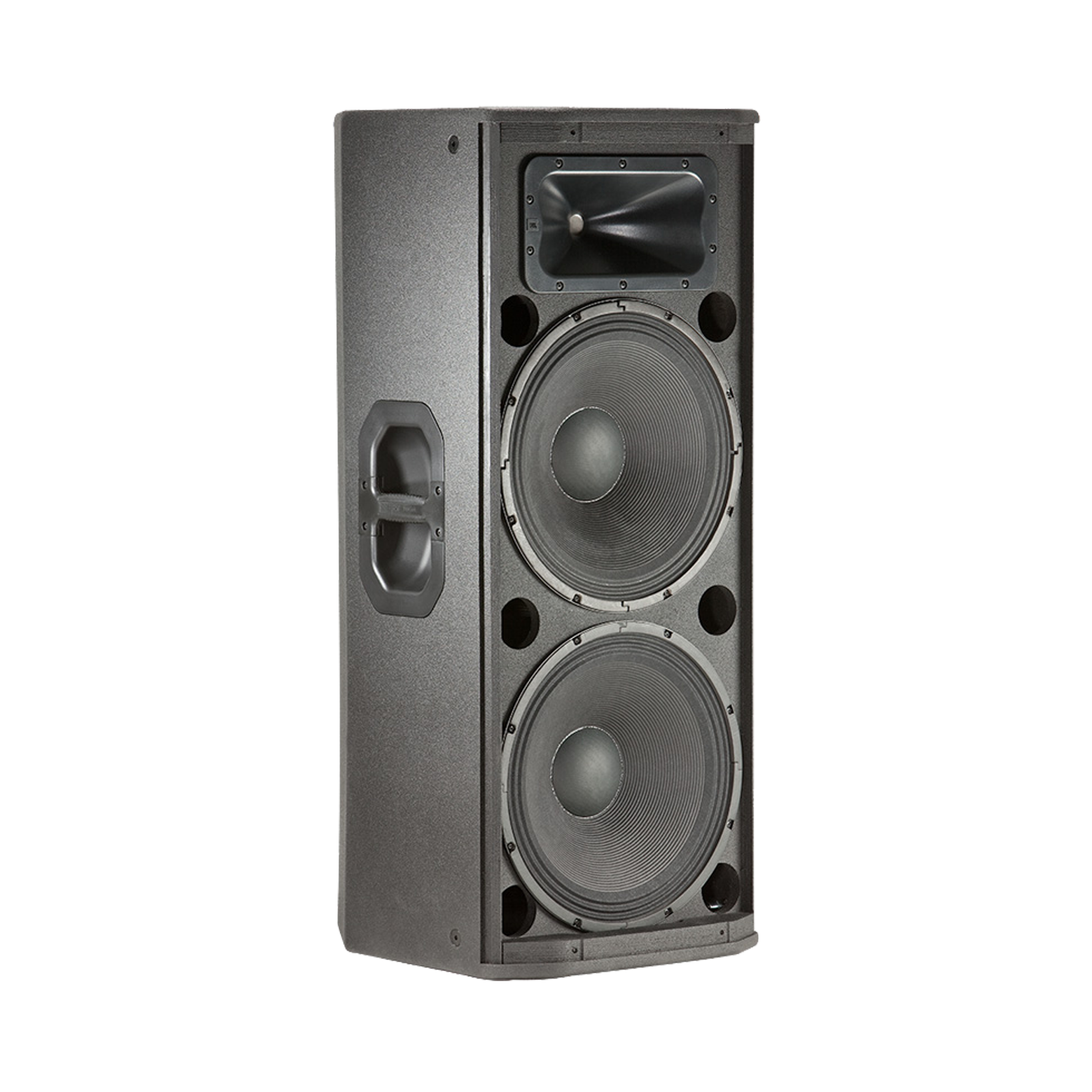

One of the downfalls with this is 'pattern flip.' Pattern flip is when the waveguide or horn loses 'pattern control' on one axis but not the other
For instance, the waveguide on this JBL PRX 425 will control horizontal directivity down to about 1350Hz, but it's vertical directivity will collapse at about 3300Hz.
This is caused by the dimensions of the waveguide. It's waveguide is approximately 25cm wide, which means it will control the pattern down to 1350hz. (34,000cm per second / 25 cm = 1360Hz.)
'Pattern flip' can really make a speaker sound weird. You basically have an octave or two where the directivity of the speaker is completely asymmetrical. IMHO, this asymmetry makes it VERY difficult to come up with a crossover that sounds natural. When there are a couple of octaves where the directivity is all over the map, it's not possible to 'voice' the speaker properly.

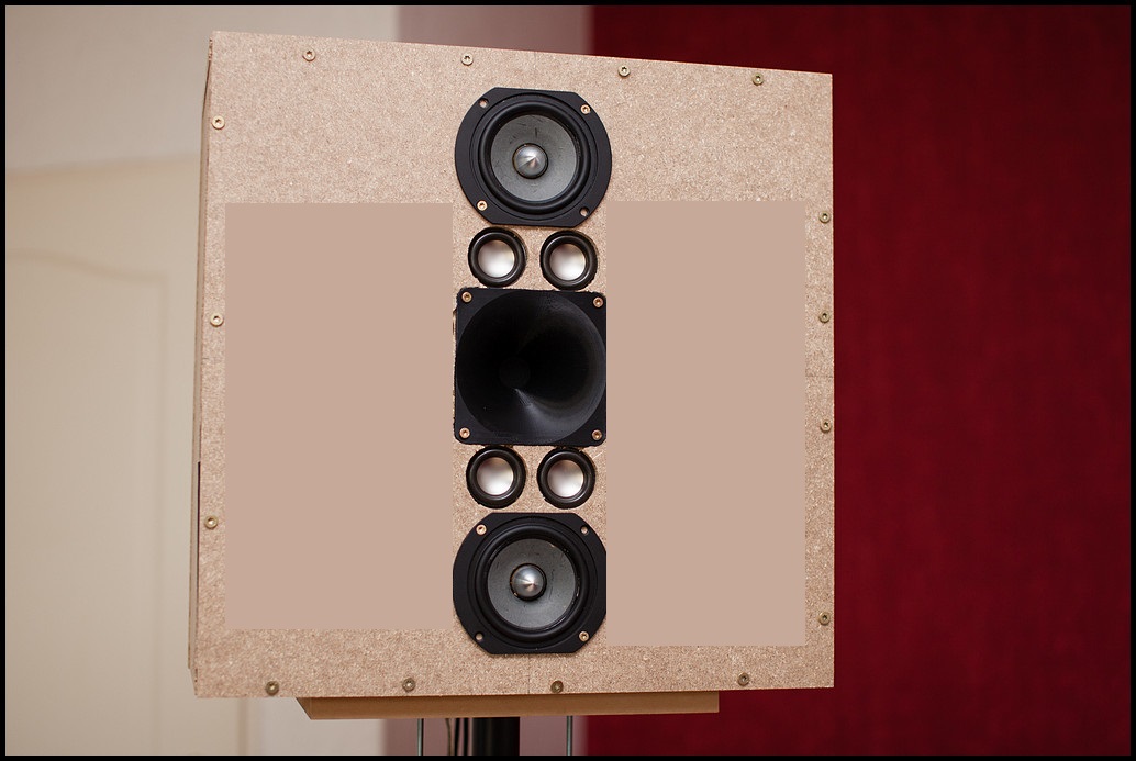

Another solution would be to put woofers both above and below the waveguide and use Horbach-Keele filters. Vertical center-center spacing is a problem, so use a waveguide without a proper mouth roundover on it's top and bottom lip (like the Econowave waveguide) and use small woofers. In order for the woofers to remain beaming horizontally, multiple woofers might need to be arrayed horizontally.
Like this, but with an asymmetrical waveguide:
Image taken from Pseudo-coaxial with narrow directivity (and Horbach-Keele filters)
