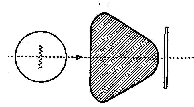

Would it be feasable to mould a lightguide from, say, polyester resin, perhaps embedding the LED matix in the process?
Hey Ace I was looking at your LED light guide and it looked like a fiber optic cable. If you are going to use this idea it will work bacause fiber optic can transfer light to one piont with little or no intensity lost, but LED will not be a great light source. Unless you use a lot of them.
rmccoll said:Hey Ace I was looking at your LED light guide and it looked like a fiber optic cable. If you are going to use this idea it will work bacause fiber optic can transfer light to one piont with little or no intensity lost, but LED will not be a great light source. Unless you use a lot of them.
heya buddy thats exactly what it is except we are making ours out of square optical plexi, if we use round cable we have a problem, when they are all placed together ( say 400) we will have gaps and those gaps inbetween the cables will be dark spots on the lcd so we use square. Each led is asigned to its own guide so there will be alot of them lol, intensity losses will be very minimal even if the eye can notice at such a short distance, it all depends on how polished you get the plexi and the material used, put it this way it will be far brighter then having the same light from that led going through air, infact that brings me to another point, glue the led in with plexi resin, this will even be less loss of light.
Plexi resin = solvent and plexi shavings, stair till desolved and till its a paste, and there you have plexi resin, Drying time is anything from 24 - 72hrs and the strength is the same as the original plexi. USE CLEAN PLEXI SHAVINGS! lol
Trev🙂
dnsey said:Would it be feasable to mould a lightguide from, say, polyester resin, perhaps embedding the LED matix in the process?
You could but it wont work right, the guide has to be no wider then the led, ( or you loose intensity ), if we make a big solid block you will have the leds in the middle making hot spots in the center of the lcd, you will also loose light and the light wont be guided correctly.
Trev🙂
