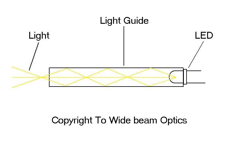

Heya Allan, i see you had trouble with your image, to fix the double image you need light control film by 3M, that will solve the double image problem from the leds. Take a search on the net and you will see what it does as my info is out of a fat optical book.

Thanks for the tip. I actually think that I didn't explain the artifact correctly. The film you told me about does indeed work for double images caused by reflection, but my double image is actually due to the light coming from different angles, so I actually had 4 or 5 different images. I think that using an apropriate condenser lens would probably work, but my condenser lenses won't do the trick here. I did notice that I was able to insert the LED cluster into an OTC LCD projector and the image came out fine! The image was on the dark side, of course, but I could easily fit twice as many LED's in there and also use ones that are 4,000 mcds brighter! I think that there is some potential here, especially because this method gave me a sharp picture, though the color was a little green.
That film guides light to the correct angle so there is no double images or artifacts of any kind, its a light guide in a film form, it guides light to paralelle. A condenser lens will never work with multiple light sources either, wheather its leds or not, the only way i can see of this working is using a light guide and to hand make one of them for 400 or so leds is alot of work, thats 400 holes all polished through 400 guides, this would be the only efective and eficient way of preserving the light fron the led and to combine the light. by doing that only then you will have a perfecly square and evenly lit block of light.
Ill see how much time i have maybe ill do 1 guide for you with 1 led to show you just how efectivly that idea works.

Heya buddy not yet, ive got about 10 other projects going at once which isnt a good thing as its too easy to loose data so ill show you how it works.
Basically all a light guide is, is a mirrored channel, the light guide acts as a mirrored prisim and all of our light is forced forward. This idea will and does work 100% but it will be upto you and your materials properties on how well it will work, bassically u need to do alot of polishing, have you ever polished the edge of some plexi and looked in the sheet so you are looking behind the polished side? notice its a mirror on the inside? thats how prisims work and plexi is by far a perfect chioce for this operation.
Get some 10deg 5mm white leds, get some 8mm square plexi beams, cut to size wich we calculate out to our beam angle, 8cm is a good start, polish all sides and the ends, drill a 5mm hole with a drill bit the same tapper as the taper on the front of the led, notice on normal 5mm led that there is a lip on them? thats the depth you want to go, after the hole polish the hole and your done. Place the led in the hole, turn it on and on the otherside you will have a very bright square of white light, make another 400 of these and you can fill a lcd. Dont glue them together as glue will interact with the plexis polished surface, you need to make a up a clamp that holds the whole lot together (wich is easy enough) and there is your block of light. You should only need the one frensel thus being the top one to guide the light through the projection lens.
Here is a quick pic on how a singular led system works.
Trev🙂
Hey, thanks. 🙂 I'll give that a try, pretty sure I understand now.
