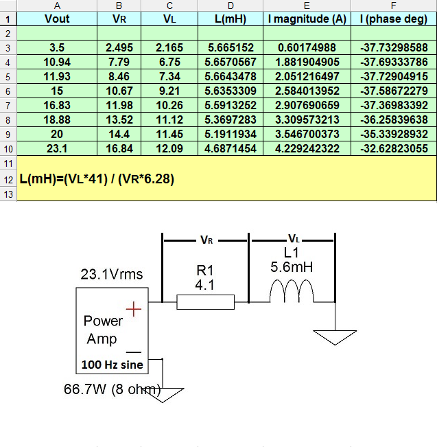

I'd advise exchanging a ferrite inductor only if it were totally of unsuitable quality and if you were causing it to saturate under normal operating conditions and it takes quite some current to start misbehaving at all. An example attached.
