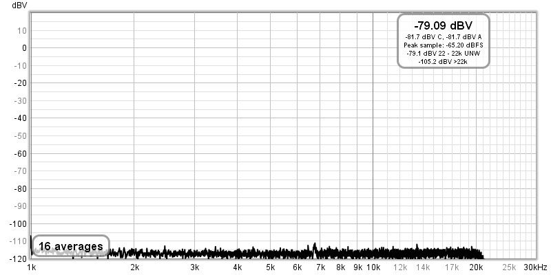

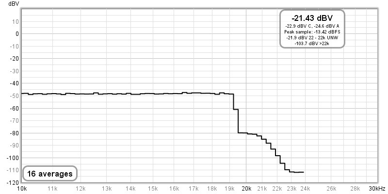

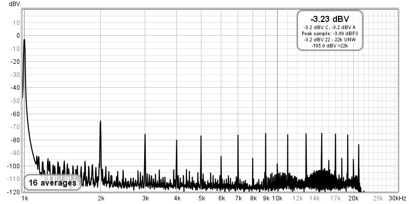

I did some testing to see. First off is a basic frequency response, which I like to do with Pink noise, because it's quick and painless. This is driving the amp board via USB connection, as setup automatically in W10.

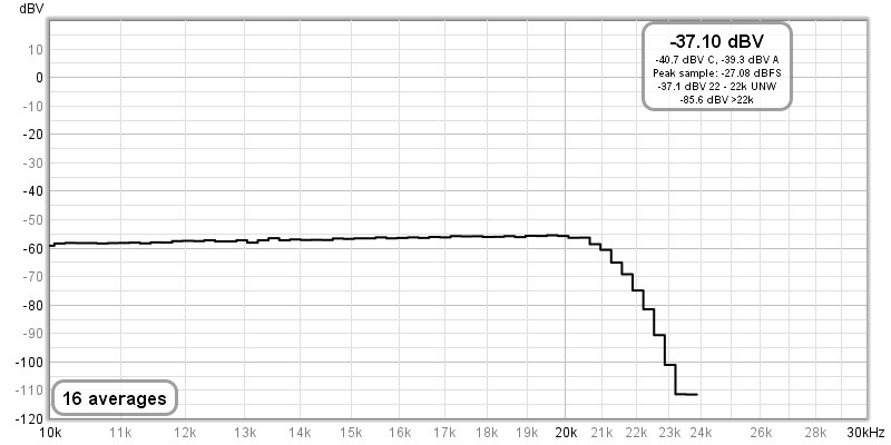

There's something going on ~20K, so I did a closeup.

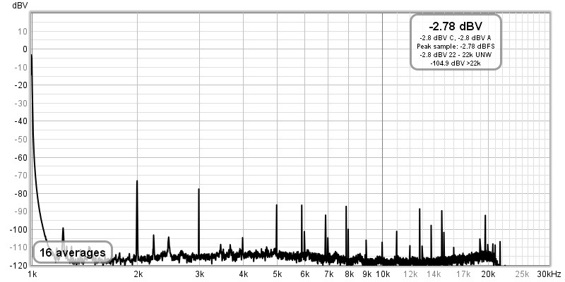

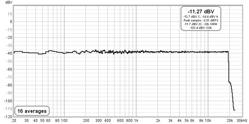

Ensuring that's not my soundcard as input, I checked that weird shape using my HP 33250's white noise output;
So something is going on with the amp / pink noise file at 19 kHz. It could be the file, but I doubt it... A quick spot check using the amp's analog input, driven by the function generator, did NOT show this anomaly.

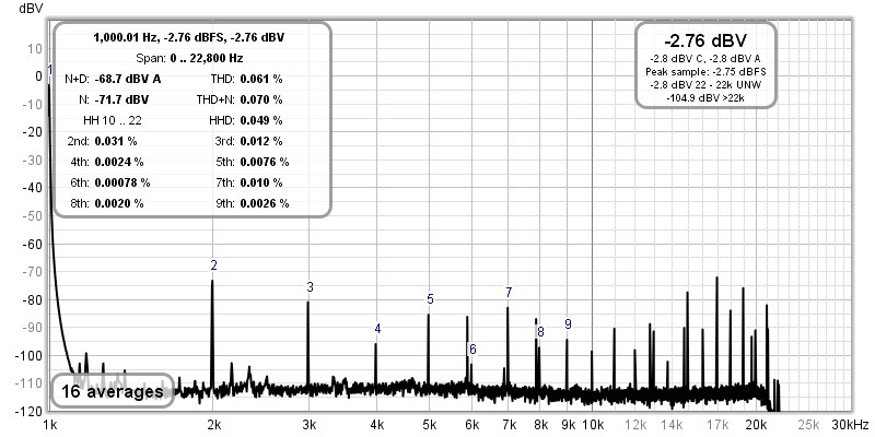

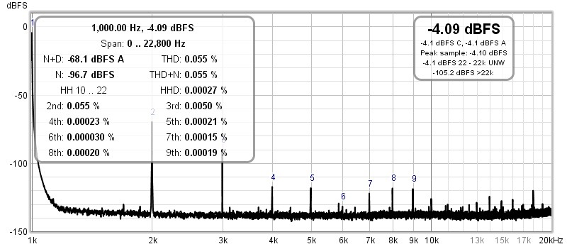

Next I set the HP to sine, measured ~2.83 with my DMM and did a spectrum of that instrument's output. Just as a what's what reference.
Then, using its USB interface, whilst playing a 1kHz low distortion flac file and setting this little amplifier to appx the same level, I did two spectrums; one with the JBL HLS 610 speaker as load, one with an 8 Ohm, non-ind resistor as load.
Resistor load;
I used an old Gateway (Liteon) 19V laptop brick (6.3A) for DC Power. I believe both channels were driven.

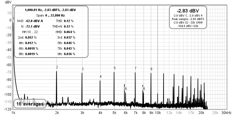

Resistor load;

I guess they reverse engineered the TPA3116 chip to squeeze a few more dollars out of it. The pin count is different but arrangement is similar. So the power amp is separate - but that other chip that handles DAC/ADC/BT still does amazing things for being a sub component on a $4 amp.
Thanks for the measurements Jjasniew. Looking like a lot of higher order harmonic components. Possibly from the lack of a proper Class D filter. The measurements would indicate some nasty listening fatigue given the higher order distortion peaks. I wonder if this is an artifact of the the measurement somehow.
I can try again. I recall seeing something similar on another class D amp I measured. It would be nice if I knew what it was supposed to look like - a "good one" - either from experience or results being reproduced in another's lab ;') I'm pretty much just getting started at this.I wonder if this is an artifact of the the measurement somehow.
My sound card is USB connected. The noise floor is pretty low with no input, unplugged. I wonder if a USB isolation cable would help, or, not at all for frequencies above 10KHz?

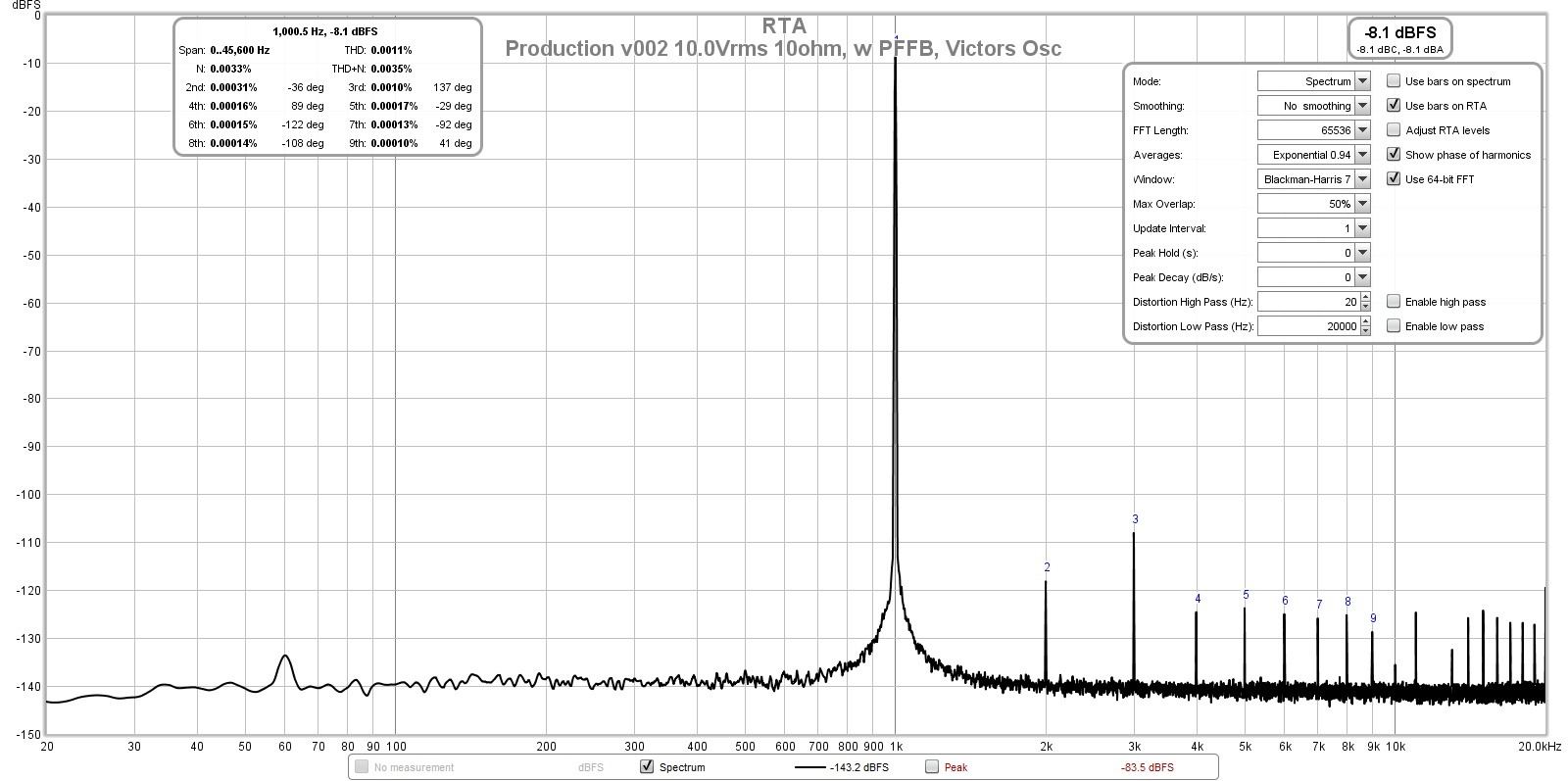

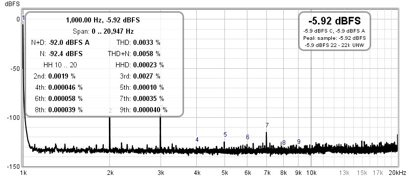

Here is what a good Class D amp FFT looks like. This is from my reference TPA3255 10Vrms into 3.3ohms:
It’s not fair to compare a $4 amp to $277 amp but you get the idea.

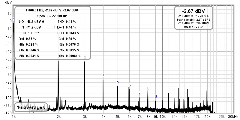

Next, I redid my HP function generator, producing the same voltage (~2.83) as the amps into my ADC / probe;
Next, I tried a small 6V6 amp I recently purchased from another member;
I can see it follows the function generator maybe even from 8K on up. So is it the ADC/ Probe, or what goes in must come out?

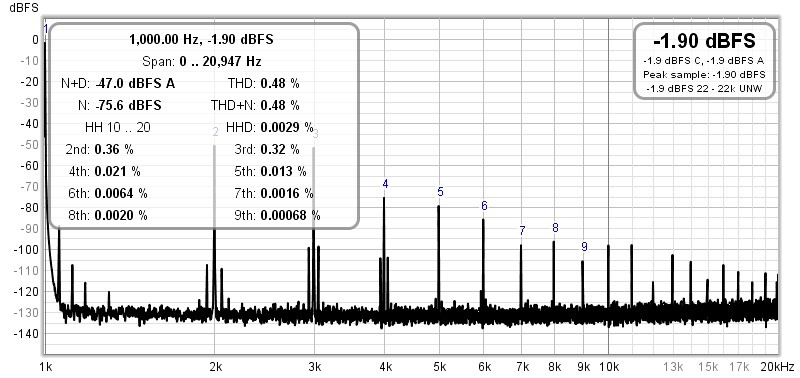

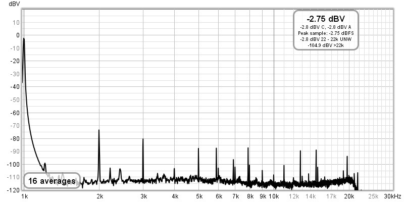

Then I tested a TDA7498 amp I picked up off ebay recently.
And a retest of coffee money.

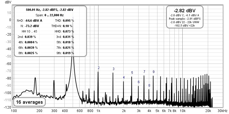

I also tried 500Hz, which seems even messier.
I dont know two things;
1. How to subtract the distortion of the input signal from the result. Would I find this in "How to do distortion measurements using REW"?
2. If I got a better ADC, worked on better shielding for the probe got a -140 db floor; would the whole train of harmonics shown above between -70 and -80 stay at the same level, with the floor between them falling lower? I'd assume so.
The TDA7498 amp has "real" output inductors and film caps in its output filter, versus the little SMD things in this amp, along with MLC SMD caps. I did notice there's some unpopulated pads near the output connectors; maybe someone worked on what is showing up in the spectrums, but someone else decided "good enough for the price" to omit it.

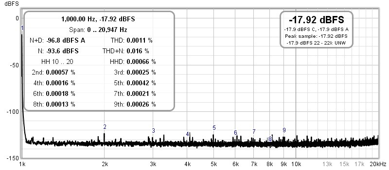

Here's what the Lookback looks like on the device I used to take data. "JamLab USB", $20 - $30 on ebay.
This is after calibration and saving a cal file. The harmonics seem highly dependent on level coming out of / going into this thing;
This is for 1V RMS I/O, which is close to the level I setup when testing the amplifier. I figured any level below clipping, as shown on the REW oscilloscope would be fine;
Now here it is at the 250mV level, the level REW defaults to;
So, this suggests I better I/O at 250 mV, with the amps producing 2.83V.

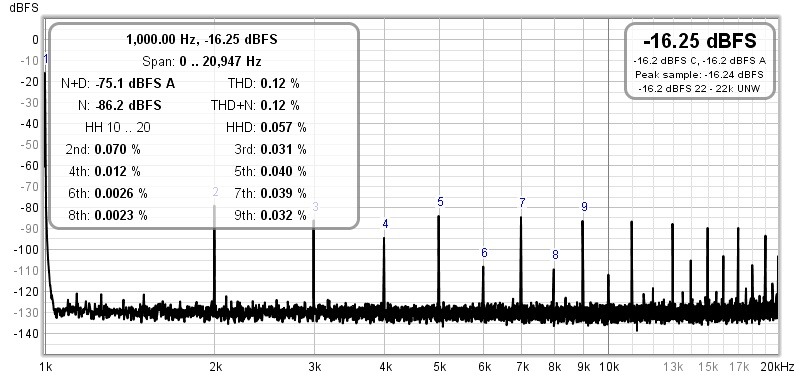

I also have a Tascam US-122L, it behaves similarly at the ~1V RMS level;
