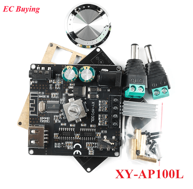

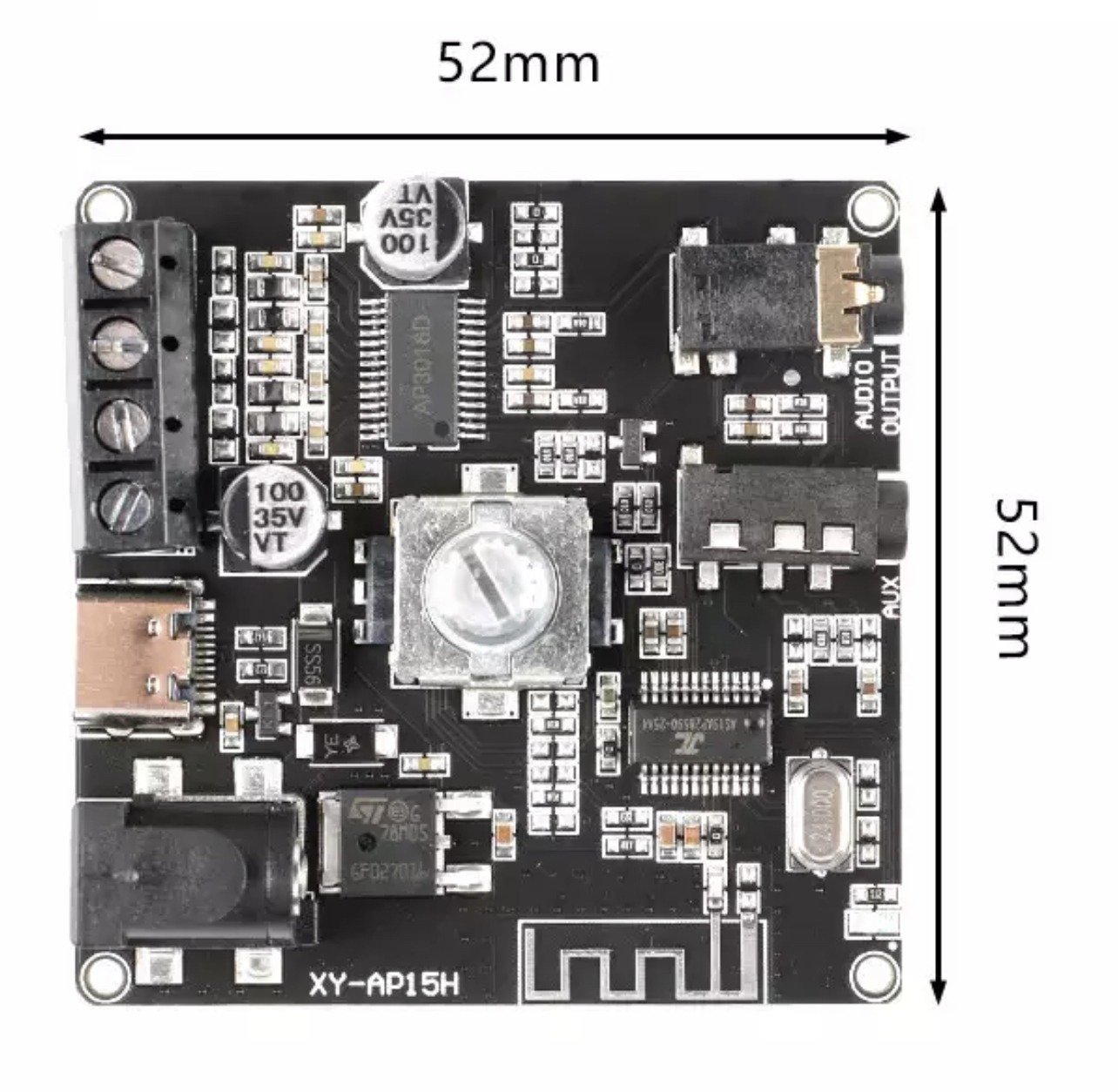

A friend recently sent me an amp he got from AliExpress for $4. These go by the name “XY-AP15H”. Do a search and you will get hundreds of hits. There are also higher power versions up to 50w. I have just the 15W version and it’s quite fine for a small room.
My friend wanted my opinion on the sound quality. It’s a tiny board only 52mm x 52mm and arrives fully, built but not assembled with PCB like top and bottom covers plus some brass standoffs and screws. I don’t know what chip it uses but it has built in Bluetooth 5.0, a USB-C memory card reader, 3.5mm aux in and out. But the cool thing is the big knob rotary encoder on the top for changing volume, selecting tracks, pause/play and power on/off. The knob rotates as well as acts as a pushbutton selector via pressure.
You need to supply an external 12v to 24v DC power supply. There is a standard 5.5mm coaxial connector. It also comes with an screw terminal adapter to allow you to use flying leads for power. The speakers outs are screw terminal blocks. Assembling it requires little hands and little screwdrivers as these are M2 screws and standoffs for hardware. I used a Meanwell 24v 65W desktop brick that I had on hand. I figure many other leftover 12v to 24v SMPS bricks can be used. I used 16ga zip cord speaker cables with crimped pin end connectors, and everything connected easily and looks tidy enough. I connected to my Rockville 2 way speakers (an homage to the LS3/5A but with better bass), and I was not expecting much. Turned it on, my phone connected to the BT easily and no annoying voice recording of some lady from HK telling me my BT is connected :)

I wonder what the AP3016D chip is and what the output filter topology is on this? Not that I'd be able to touch it with the skills and dexterity I have these days, but the mind is still curious!

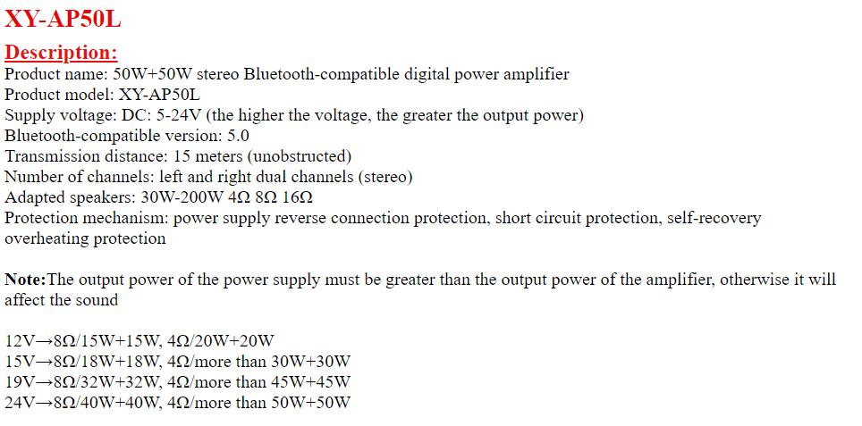

Just for posterity, the high power version is called "XY-AP50L".
Edit:
I guess we can safely say that these things are dethroning the TDA7297 for value per buck.
I "guesstimate" about 22 clean-ish Watts in 8 ohms, perhaps 35 clean-ish Watts in 4 ohms at about 25V.
There is an even higher power version that utilizes TWO of the mystery chip AP3050D.
They claim it to be able to produce upto 72W at 8ohm in 26V, which is very impressive if it's true, even for 10%THD. If it can do 35W at 1% THD that is still very impressive. They state a suggested PSU of 6A, and 26V max, that's close to 65W per channel if it has an efficiency over 85%.

The mystery chip in the first picture is from Zhuhai Jieli: http://www.zh-jieli.com/ and it is probably from the AC696N series. There was a discussion about an earlier version of the chip--the AC690N about 2 years ago on Parts Express: https://techtalk.parts-express.com/...his-tiny-little-bluetooth-amp-isn-t-bad/page2.
The JL AC690N parts use a common core design, with different packaging, ranging from 16-pin DIP to 64-pin. These chips show up in lots of devices, from Bluetooth speakers to car stereo heads. I've got the documentation for that series if anyone is interested--it's got the specs on the uP core and A/D and D/A. I've also got the JL toolchain that you can use to modify the code, but it had a somewhat complicated programming sequence that I never tried to implement.
It looks like the AC696N series is a nice improvement over the AC690N. Here is some info on the company, which calls itself "Jerry" in some of their documentation :): https://posts.careerengine.us/p/61a6dd39bab4b93f61869fc6

I think the amp is the TPA3116. The AC696N doesn't include the amp. But yes, it is an impressive chip.
I assume the Bluetooth uses the "High Quality SBC" codec, which some have claimed is comparable to the Qualcomm apt-X codecs. This chip doesn't support apt-X, but that's probably not as big a deal as some marketing types might claim:). I haven't played with an AC696N chip, but I did set up a switch to evaluate the sound of audio going through the analog input to DAC chain for an AC690N. I noticed a difference in audio quality and decided that it is better to switch the audio outside the chip than using the internal routing.

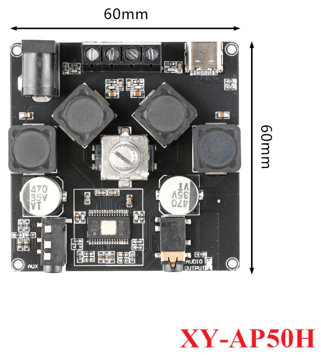

That amp chip is hard to track down. According to one site, this board is offered in 5 different "flavors", differentiated by the amp chip:
AP15H: AP3016D 20W*2
AP50L: AP3050D 50W*2
50H: TPA3116D2 50W*2
AP100L: AP3020D 100W*2
100H:TPA3116D2 50W*2
So, it looks like there are "imported" TPA3116D2 versions along with those "domestic" AP3016D, AP3020D, and AP3050D chips. The only reference I could find to any of the AP chips was at http://www.neko.ne.jp/~freewing/hardware/audio_digital_amp_ti_tpa3116_zk_502h/, where the AP3050D is identified as a CS8673E. That chip is only 16 pins, but the picture links to the CS8683, which has the right number of pins: http://www.szczkjgs.com/UploadFiles/fujian/4906/CS8683.pdf
Hard to tell, but my guess is that those AP chips are actually from Shenzhen Yongfukang Technology Co, who apparently make knock-offs of the TPA3116. The TPA3116 is over 10 years old, so I suspect the AP chips are decent replacements.
Yes, it is just the XY AP50H that utilizes the 3116.
