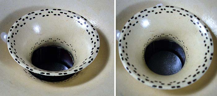

Are the patterns for decoration, or do they have an effect on breakup modes or something like that?

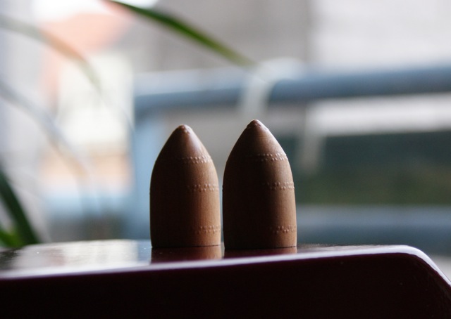

planet10 said:nd the phase plugs need doing too...
My phase plugs look a bit "dry". I first thought about oiling them... but with paint hat could be an issue. What do you advise?
Nice whizzer paintjob. I choose colourless as I am afraid the pattern will get distracting after a while (for me).
J.R.Freeman said:Are the patterns for decoration, or do they have an effect on breakup modes or something like that?
Jim
Here is a good start to read about it.
http://www.diyaudio.com/forums/showthread.php?s=&threadid=119676&highlight=enabl
Jim
They work just like all the rest of the EnABL spots

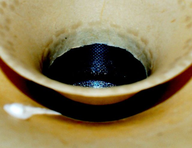

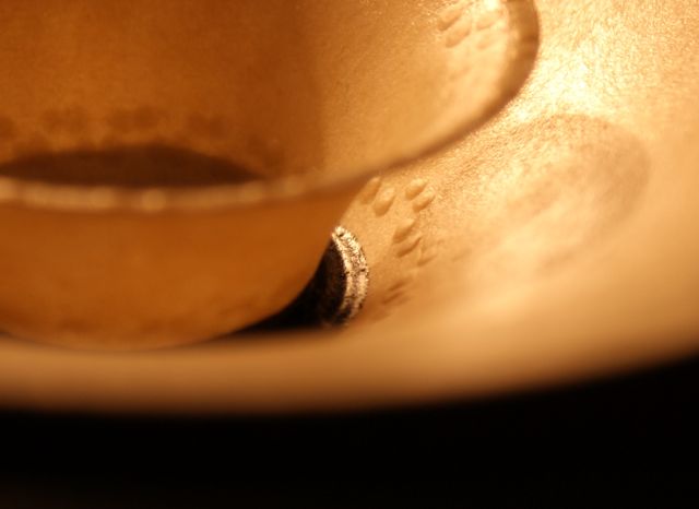

They are finished with a polyeurathane clear finish. I use a #56 or #66 nib to put the dots. Just touch the tip.. watch you don't make to big a dot when you have a fresh load of pollyscale (on the plugs pretty easy to clean up with 1st a dry q-tip and then a wetted one if necessary). When you are running out of paint on the nib it might take a bit more work.
I will post the where and a picture with the template -- i've 2 more coats of clear and then i have to do 6 more plugs.
dave

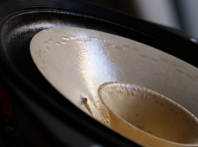

JeroenR said:- can I coat the plug with the gloss I used for the cones? Only one coat?
- (of topic) Can I use the same recipe with my FE103Sigma's? Any experience with those?
Yes. Yes. (and a bit of PVA on the tip* and then gloss just on top of that). Yes
*(a tip -- get a cardboard box, cur a small pair of holes just big enuff to securely hold the plugs nose down. Add the PVA, and put the plugs nose down in the hole to set up.
dave

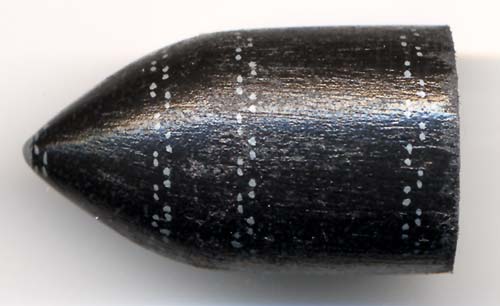

JeroenR said:2,548 stripes/dots
((144+144+144+216)/driver + (144+144+144+7)/plug)x2 = 2172
What did i miss?

Thanks!! Yep, good tip, my PVA was starting to hang down the tip, so applied two layers...
I'm listening to those FE103Sigma' for over 10 years now, I'm very curious if I notice the difference after EnABLE.
What did i miss?
Nothing. And I was wrong, but the number increases as I did a few dots three times...
(dots=stripes)
driver:
3 rings of 72 dots
1 ring of 108 dots
all touched/painted three time for some height
(3*72+108)*3=972
plug:
3 rings of 72 dots
1 ring of 12 dots (at top)
1 dot (top)
all touched/painted twice for a bit height
(3*72+12+1)*2=458
so two drivers is (972+458)*2=2860 😀
Jeroen
planet10 said:((144+144+144+216)/driver + (144+144+144+7)/plug)x2 = 2172
That should be (i should never try to do stuff like that before the coffee takes affect 🙂)
((72+72+72+108)/driver + (72+72+72+13)/plug)x2 =36*15+26 = 566
