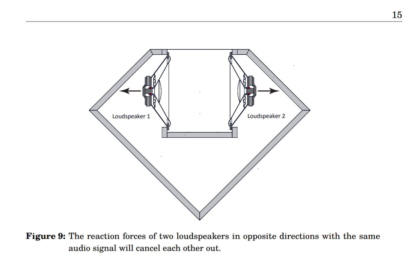

an easier way to get rid of / massively reduce box vibrations would be to mount the drivers in an opposite push-push
It has been mentioned before, but since it is such an excelent solution not taking advantage seems silly.
Mass of the box in itself is not a metric that tells you much. A push-push box can have much less heroic construction and yet outperform a box such as the OP’s.
We did a test build with 2 x SDX10 push-push in. 15mm BB box with a set of simple cross-braces. It worked supremely well. One could pick the box up sans drivers w 2 fingers in a driver cut-out — add the woofers and 2 people are usually needed.

Not opposing driverson opposite walls, opposing drivers in the same box close to each other:
In the image (stolen from https://rmsacoustics.nl/papers/whitepaperdistortion.pdf) we have a push-push configuration. Another option is a push-pull config if we invert one driver (but keep the cone movement same as in the picture) then we will in addition to cancelling the forces also cancel even order distortion. Kind of like a push-pull amplifier, but with a speaker.
As long as the distance between the drivers (around the outside of the box) is such that it is less than a quarter wavelength then there will be no FR issues from the driver separation.
Just design the box so the magnets are close (also aids in better driver coupling).
Note that with the configuration shown in the previous post it is hard to get good driver coupling and also a harder than necessary box to build.
dave
