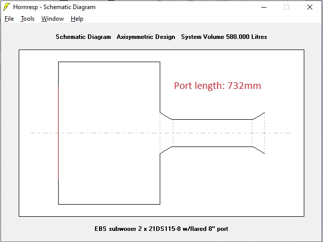

My hope though is that the bracing will somewhat help prevent standing waves. One of the weaknesses of the design is its 137 cm width. Combined with 96 cm height and 76cm depth, the longest internal dimension (from coordinate 0,0,0 to 133,92,72) is 177cm, which half-wavelength corresponds to 97Hz, at which frequency the subwoofer will have audible output even with a LPF of 80Hz (LR2).
The long internal dimension is a result of another weakness of the design, namely both drivers sharing the same volume. However, all designs have trade-offs and this one has to do with space (for drivers and port), hopefully mitigated by the tight TSP between the drivers and the fact that in reality (IMHE) this is seldom an issue.

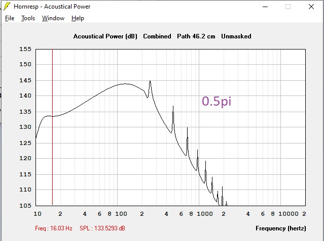

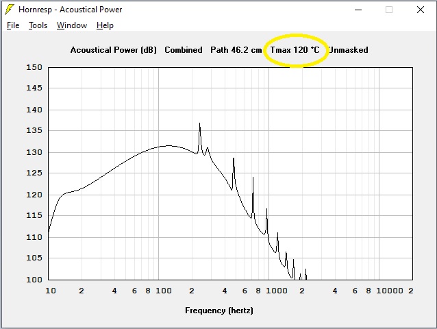

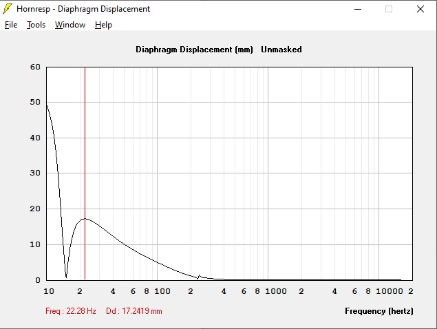

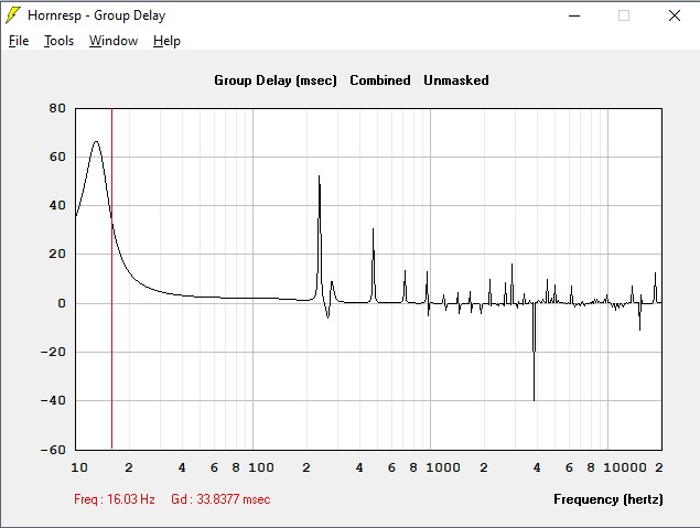

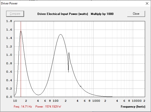

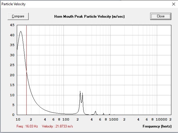

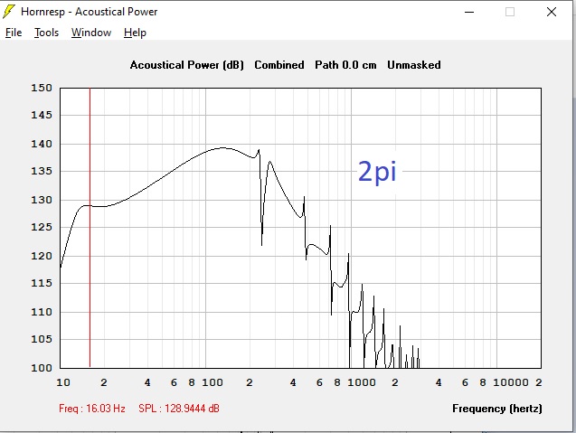

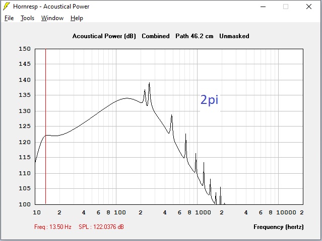

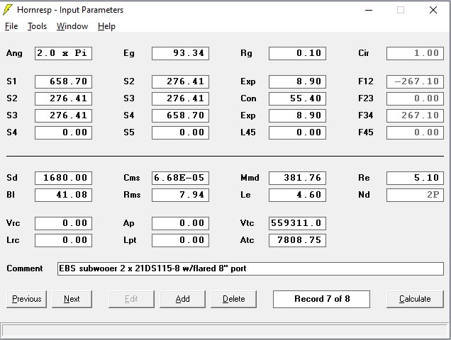

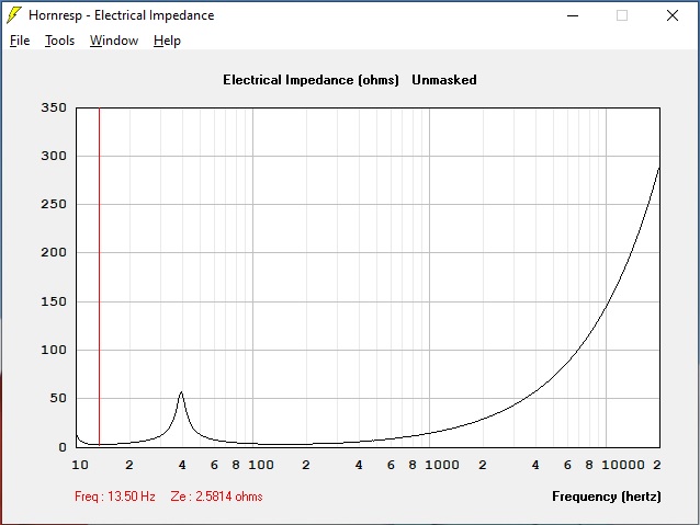

This thread was not meant to be about the design per se but I may as well post a few sims if anyone's interested:

Wow Is it going to be bolted down or fixed tightly into the space somehow?The box is supposed to be a solid foundation for two 21" pro drivers that will be driven by a couple of thousand watts (bridged IM Smiths FP14000), capable of +120dB below 20Hz in a HT setting, so there's some kinetic energy and pressure involved.

EDIT: The half-space graph above is not the right one, this one is:
