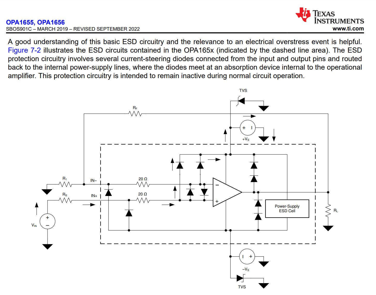

Gate stoppers are already inside chip. Because of usual ESD protection diodes, it is necessary to use input resistors for limiting input current below datasheet specified max. value. In case of OPA1656 and most TI opamps, that is 10 mA. I know from practice that 30 – 50 mA short pulse current doesn’t damage protection diodes.

I don't think that 10 mA applies to an ESD strike. I'm pretty sure it's a steady-state value.Because of usual ESD protection diodes, it is necessary to use input resistors for limiting input current below datasheet specified max. value. In case of OPA1656 and most TI opamps, that is 10 mA.
Of the three commonly used ESD models, human body model (HBM) is the most gentle on the part. It involves connecting a capacitor charged to a few kV to the pins of an IC through an LC circuit. The L limits the peak current. Even then, the peak current is far beyond 10 mA. The ESD diodes, rail clamp, and power rails on the IC are designed to handle this. There's no need for any added protection outside the IC.
The only exception would be for connections that the end user can touch. So the inputs and outputs should be protected. That's especially true for connections to itty-bitty devices inside of logic gates.
Tom
Yes, it is a steady-state current limit. It was not said otherwise.
FWIW, I had several TI opamps subjected to test, where internal diode had 50 mA / 50 ms long peaks, repeated more than 500 times in a row at 14 s interval, with no ill effect. Later, recognizing design error, I’ve added external diode from input pin to the rail.

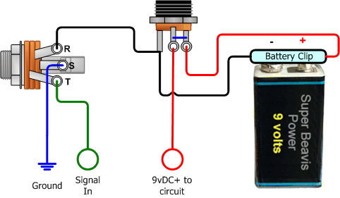

I make guitar amps which are customarily abused: inputs/outputs (I´m talking signal level; speaker outs are a wholly different Pandora´s box) where inputs expecting an (electrically) mild signal (less than 1V RMS from high impedance source) (passive Guitar pickup) getting speaker outs, pedals fed from poorly grounded supplies carrying significant voltage differences or grounded to different outlets, sometimes as bad a mismatch as to trigger GFIs, static buildup (Guitar player walking on a nylon carpet on a dry day), leaky pedal or preamp or active guitar coupling capacitors passing significant DC, to boot a normal 🙄 way to turn pedals on is to use a stereo jack with battery negative terminal connected to unused terminal on a stereo jack, so plugging the cable there sends full 9V DC straight to preamp input, the whole catalog of horror stories, and then some.

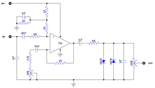

So at least 33k or 47k are added in series with input pin, clamping diodes are even better.
Increase in noise?
Probably, but a dead amp is even worse,so.
No Idiot proof anything exists, but in over 14000 amps I have had a handful of dead input Op Amps, so protections mostly work.
Of course, "never say never" 🙁
Notice "unused" Ring contact gets 9V battery (or supply) negative.
When a regular Mono guitar plug is half inserted, while plugging in/out, tip gets -9V, body(sleeve gets the other through the pedal circuit.
Notice 10k in series with input pin:

OPA1656 has 20 Ohm gate stoppers embedded in chip. Probably, many other opamps have them as well, only it is not specified as that is part of internal design.

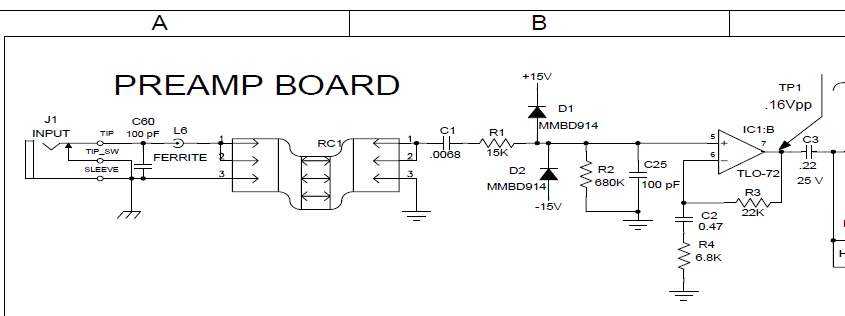

I wonder what is R1 doing there. 🤔
In the schematic of post #17, resistor R1 (15K) works with capacitor C25 (100pF) to form a lowpass filter whose -3dB corner frequency is ( 1 / (2*pi*R*C) ) = 106 kHz. This attenuates any radio frequency interference that might be present (even after the ferrite bead L6), and keeps it out of the rest of the amplifier.

Agreed. And you can also say that it provides some protection for too high input levels.
