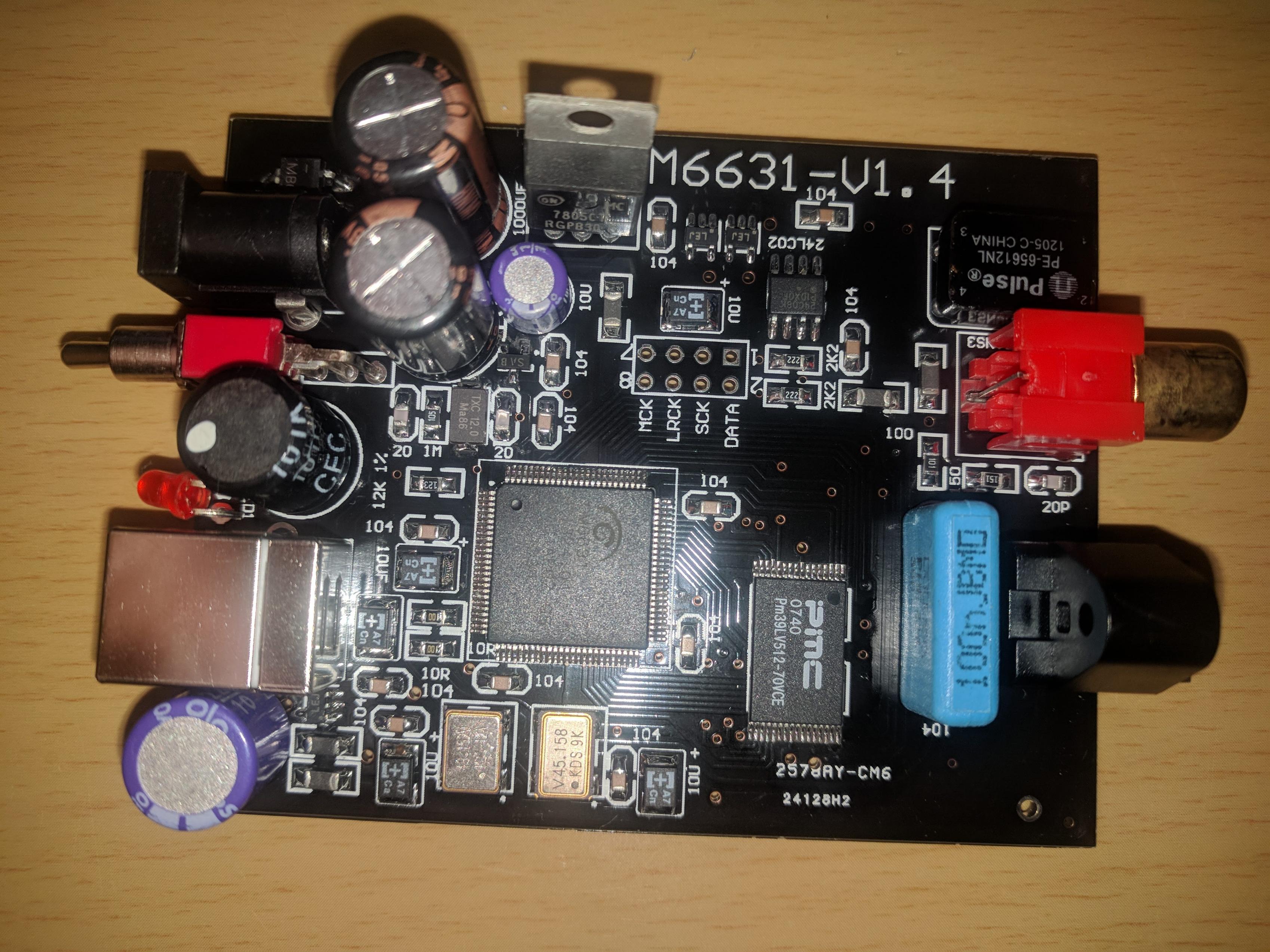

i've been using a cm6631 usb->spdif/toslink adapter for several years now on my x86-based server. due to some issues with skipping when the server is under heavy load, i've been working on setting up another device as a dedicated streaming device.
with the new device (an "ouya", based on nvidia tegra30 soc), i am running into an issue with the cm6631 that i never encountered when hooked up to my x86 nas. apparently randomly, the audio will become robotic sounding and distorted, as if the sample rate doesn't match the playback rate. i experienced this issue on multiple versions of the linux kernel (ancient 3.x vendor, and latest 4.18 which was released a couple days ago). it seems to be something about the tegra30 usb that triggers it.
i read that in linux, there is a workaround in the usb audio driver specifically for cm6631 and this exact issue. the problem is, the glitch that triggers it seems to happen outside of an intended sample rate change via alsa, so the workaround isn't executed. i think it is a momentary stutter or something with usb. the original fix is here: [alsa-devel] ALSA: usb: Work around CM6631 sample and another separate fix someone came up with earlier: What exactly is... : Help - Volumio
while i don't expect to fix the compatibility problem between the tegra30 usb and the cm6631, i had another idea - to desolder the cm6631 and replace it with a cm6631a, which apparently does not have that issue.
from reading this thread, it seems that i could disable the parallel flash on the board (with CE# pin) so that the cm6631a would boot from ROM. once booted from rom, i think i could re-enable the flash and use the firmware tool to flash the proper cm6631a firmare via the usb firmware tool. i got this idea from here: http://www.diyaudio.com/forums/digi...m6631-usb-audio-interface-66.html#post5376831
the board i have has an i2c or spi eeprom along with the parallel flash. maybe i should just erase it after desoldering the cm6631 chip? i have soic-8 test clips and various methods to program it (ftdi, buspirate, etc.)
attached is a picture of the board. it is the "breeze audio cm6631 usb-spdif".
thanks for any insight if this swap is possible, or if i'd just be wasting my money and ruining the board 🙄 btw, i have never updated the firmware or anything on the current cm6631 chip.
here's the image of the board i said i attached my previous post, oops. missed the edit deadline :blush:
Not sure if replacing the CM chip will solve your problem. The chip has 100 pins with 0.5mm pitch so it's not an easy job and require good tools (hot air gun, SMD microscope) But if you do go ahead with the swap:
The I2C EEPROM doesn't do anything for the 6631A, you can remove it.
If the board has a external reset delay circuit, disable it (connect XRST to gnd), otherwise the startup will be too slow resulting in the computer not recognizing the chip properly. The 6631A has an internal reset delay circuit.
The parallel flash only needs to be disabled during the fist start. As soon the chip started from ROM you can erase, restart and then program it. No need for soldering, just temporary short some pins to gnd when power up until it boots from ROM (as apposed to hanging).
Not sure if this is worth the effort as real 6631A boards are not expensive.
i actually found someone local to me who has the tools/experience to do it. they said they'd done one that big before but it's been a while 🙂 personally i'd struggle to desolder an soic-8, lol.
thanks for the pointers about the i2c eeprom and reset circuit, i'll remove them. it does have the reset circuit. i saw some other posts/blogs about it, but it makes sense now thinking in terms of board vendors who used the same old CM6631 designs for the new CM6631A chip.
i'll give an update if/when this happens. i still need to source the IC.
