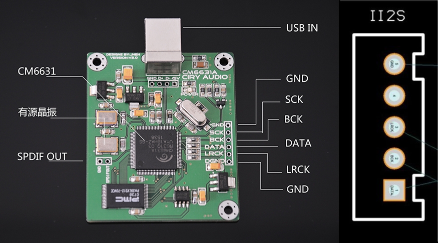

Hi everyone,
I have ordered a CM3166A board with IIS and SPDIF Outputs. Nothing more
So i was looking for a dac to combine e.g.(ES9023, WM8740,CS4398,AK4495)
but i have a question!
Can i connect them directly or it need some receiver/decoder like CS8416 between them?
Thanks in advance

Do you mean you are building your own DAC from scratch using one of those chips, or ordering a pre built DAC unit or PCB?
Yes and no. It will be like from semi-scratch. Several mini boards to be combined with my own supply
I want to avoid smd soldering, but if it's needed i can solder up to SOIC size and print 1-side pcb
Stand-alone pcbs (with only 1 chip each) would be prefferable to combine them.
Below is the board i ordered

On one side of your board you have six pin holes: that is your I2S interface.
I looked around to see if there were any DAC boards with the same pin order, but I couldn't find any.
But you could use this one:
NEW ES9018K2M ES9018 I2S input DAC decoder board
As you can see, the pin order is not similar and can't be aligned directly with socketing. You will have to use either short (less than 10cm) flat cable interface or three short thin coaxials (shield always grounded) to link pin by pin. The pins are BCK, DATA, LRCK and DATA.

Now i see what you mean..!That is not a problem. Thanks
I can use o short cable or make a mini pcb that will make the pairing
So back to my first post
Can i connect them directly or a receiver/decoder like CS8416 between them is needed?
Reading about dac all these days it seems IIS pairing to be better. Am i wrong?
