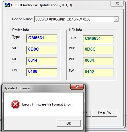

There are so many request for the CM6631A Configurate Tool. I decide to put it here. If you need it you can download it. But please note this tool can only use to generate CM6631A firmware. You can not use this firmware which generate by this tool on CM6631, CM6632 and CM6632A. If you do that you device may not function any more.
This tool do not include firmware update tool. You need ask your IC provider or device provider to got it.
Thanks a lot! But wich version of fwupdate tool are compatible with it's output? I got 2.0.1.3, but it sad: firmware file format error.
I have no luck with searching for newer version like 2.0.1.9 shown here: CM6631A 384KHz | H i F i D U I N O
When you get this error, unplug and replug the USB connection of the CM6631(A) device.
Make sure you're on real Windows XP.
It's giving back the same error on a machine from stone age with XP. Unplug / replug does not change this, still not accepts the firmware file. I think it's not an OS based problem.
Instead of updates the updater at least able to read the generated hex file specs.

You should erase the firmware on the device first.
Unplug and plug in again.
The left side with Version, PID etc will be empty.
Then you can upload the firmware to the device without the error.
The version 2.0.1.9 firmware update tool can work normally on Win7. (But I cannot upload it because of the size limitation of attactments!) And recently I solved the problem about 24/96 limitation. It is exactly caused by incorrect hardware configuration. The XGPI4 pin must be pulled up to VCC in order to switch the chip to Class 2.0 mode.

I used a mini test board designed by myself. It seems that the 32/384 mode can be only enabled on Linux or MacOS. I uploaded the tool below(compressed by sub-volume mode). Before unzipping it, you need to change the filename from fwupdater2019.z01.zip to fwupdater2019.z01.
If I read the pdf right, it seems to say that Windows 7 can only be used to update CM6631A, but not CM6631. Strange.
Thank you, it works fine under Win7! Now i set all options to 64BCLK (I'm using 3 wire i2s with pcm5102A dac) and all of the options works up to 24/192 in Win7.
My new FW also works in Linux, now i get sound. Yeppy!!!
