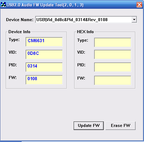

Hi all.
Got the CM6631 unit. Opened up case and it's the CM6631A. Works with the Emotiva XDA-2 drivers in Windows 8.
I tried it with the MacBook Pro running OS X 1.8.2 and it's recognized as standard USB Audio, not HD Audio - only up to 48kHz.
Any tips for this? I thought it was supposed to run in OS X plug-and-play?
Here's what the USB2 Audio FW Tool shows - VID 0D8C / PID 0314. I assume no firmware upgrade for this?

USB2 Audio FW shows VID: 0D8C / PID: 0314 / FW: 0108. Any alternative firmwares for this unit?

Did you power up the CM6631A unit _before_ connecting it to the Mac? Or after?
According to this document, try unplugging and reconnecting the unit to your Mac:
http://emotiva.com/resources/media/xda2/Emotiva_XDA-2_Apple_Drivers.pdf
You have the same firmware as mine.

Thanks for the tip wklie.
Unfortunately still cannot get the MacBooks to run in high-res with the CM6631A device. Strange since "MIDI Studio" does call it "USB2.0 High-Speed True HD Audio" but when I look at the "Audio Devices", I still cannot go beyond 48kHz.
The interesting thing is that I have the ASUS Essence One also and it works fine on the laptop all the way to 192kHz, so I have the driver in there!
Is there any way to flash this with the Essence One firmware?! Maybe that will work...

CM6631A Firmware 0101, 0108, CM6631 Firmware 2203
Disclaimer: I'm not responsible for any damage that occurs as a result of using these files or these instructions.
CM6631A Firmware 0101 VID 0x0D8C PID 0x0319:
https://docs.google.com/file/d/0B_6YdmyVvVtmYmpPTmtZVFRtQjQ/edit?usp=sharing
CM6631A Firmware 0108 VID 0x0D8C PID 0x0314:
https://docs.google.com/file/d/0B_6YdmyVvVtmWU51YXV0RFRZdTA/edit?usp=sharing
To be used with the flash update tool found in the CM6631 Firmware 2203 package VID 0x0D8C PID 0x0309 on Windows XP _ONLY_:
http://www.nutsaudio.com/driver/CM6631_Firmware.zip
Instructions:
- A Windows XP PC is needed (XP compatibility mode on newer Windows does not work - do not try it)
- Connect the CM6631(A) unit to a USB 2.0 port at the back of the PC, do not use the front ports even if available
- Run the flash update tool
- Erase firmware
- Unplug the CM6631(A) unit then reconnect it again
- Update using a new firmware hex file
- If a File Format Error or a Flash Error is shown, reconnect the unit again and flash it again
