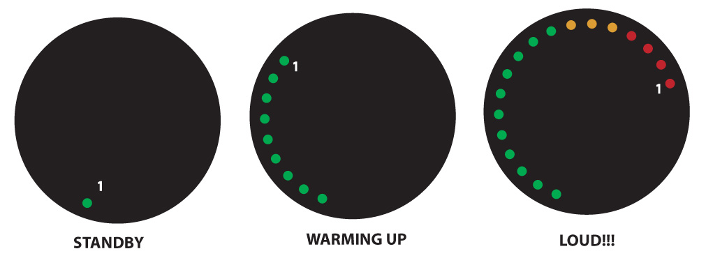

This is an intriguing idea really, and I have at least had some thoughts in my head.
Many years ago I suffed a single led in a knob and had a) a Power On indicator and b) an indicvator of volyme setting.
The real thing however is to have a VU.meter in the knob like in my pics below.
You stuff a number of LEDs, if possible multicolor that gets information from the VU-circuits, through a microcontroller that also keeps track of the rotation of the know and makes sure that the display is always "level". I added the '1' to just indicate where the dent (on a standard knob) is at a few volumes.
I am sure that this can be done and whenever I get further down my MUST-DO-list, I have to see what can be done and how.
Not really what you were looking for, but ... well ... anyhow ...
