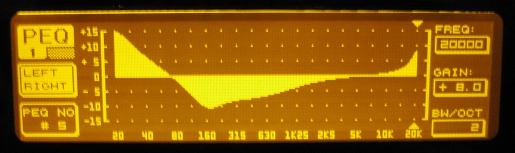

What do you guys think of the Behringer FBQ1502? It looks like it is all analog - no DSP. Indepedent left/right sliders. For $100 it sounds awfully tempting just to have for all my other speakers to play with.
My one concern for use as the main IDS-25 EQ is whether or not it has enough boost at 30 Hz (+20 dB IIRC). +12dB may be the most. However, one can offset everything by -8dB to get +20dB relative - will need to boost overall level out (or into EQ).
Hey X,
I don't think this analog circuit design by Behringer will better their DEQ2496. With the 2496 you get a lot more EQ power (Graphical and PEQ) plus you could choose to use it with digital in from the source and route digital out to a dac of your choice.
Wesayso,
You are right, the DEQ1024 has a lot more features for an extra $150. Perhaps all the bad analog business that Bob had to fix can simply be avoided by running the CD player's SPDIF into the DEQ and then using a third party DAC on the output? More boxes and requires a digital source though. Staying in the digital domain for all processing prior to DAC and power amp is a good thing though. Nonetheless, the $100 pricepoint and sheer simplicity of hard sliders and good old op amps to effect the EQ'ing interests me for my usual stuff. How is speaker tower coming along? Have you installed drivers yet?

In the past I've seen a lot of graphic equalizers that gave you a rather non-smooth FR when the controls deviated significantly from being centered. With the controls up fully, the FR looked like a triangle wave on a scope. Pretty bad. Used with a IDS25 clone you would be pushing controls close to their limit. A Parametric should be a better way to go if it has enough range, but you might well need more range than +/- 12dB according to one IDS25 project guy (see attached pic).
The DEQ2496 has optional compressor/limiter functions that might be useful if you like to play music real loud. If you know how to use the DEQ2496 with strictly digital in and out it might be pretty good. They may have cut the corners on the analog circuitry in the DEQ2496 just so you could hear an improvement when using the digital only interface instead...(?)

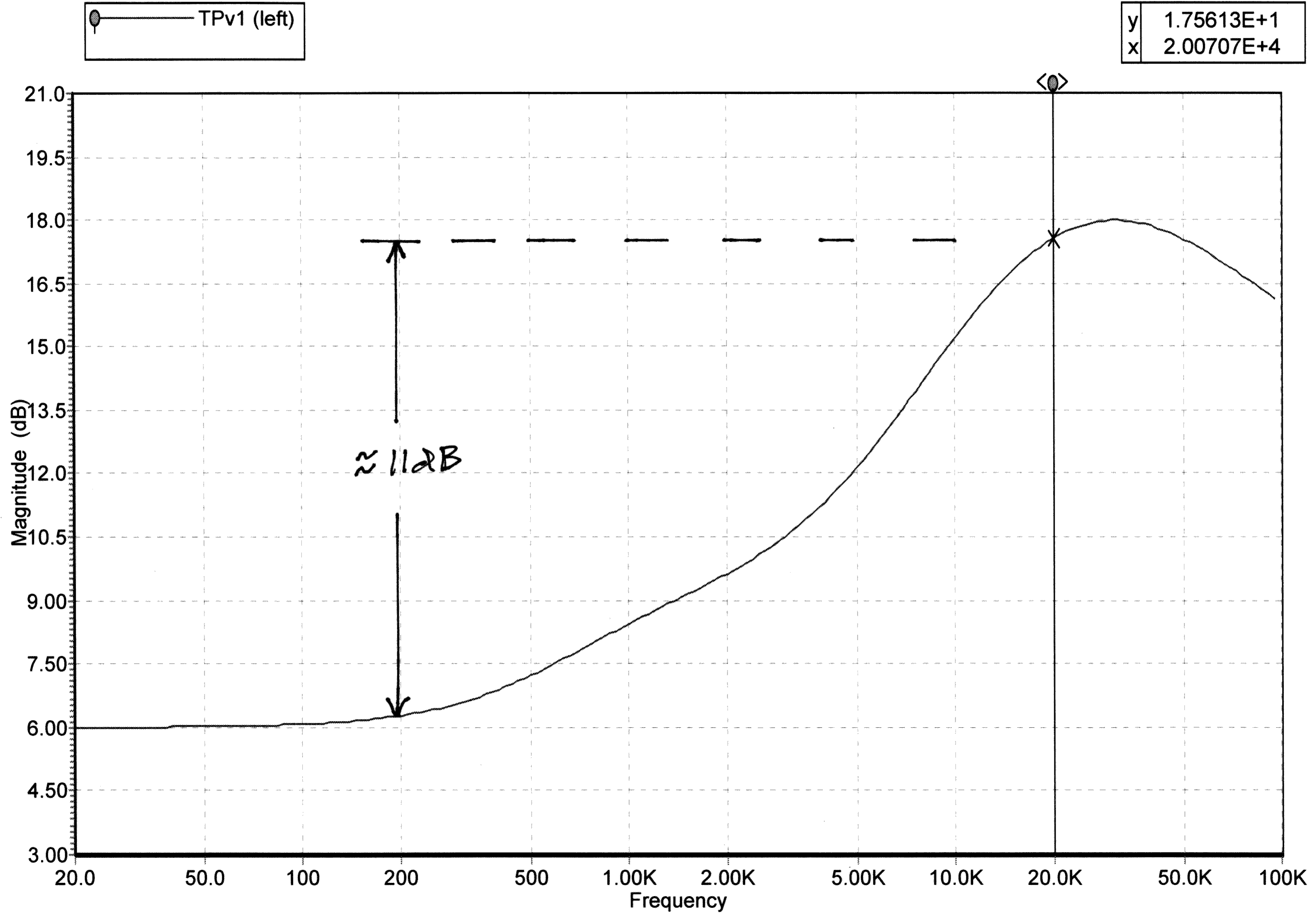

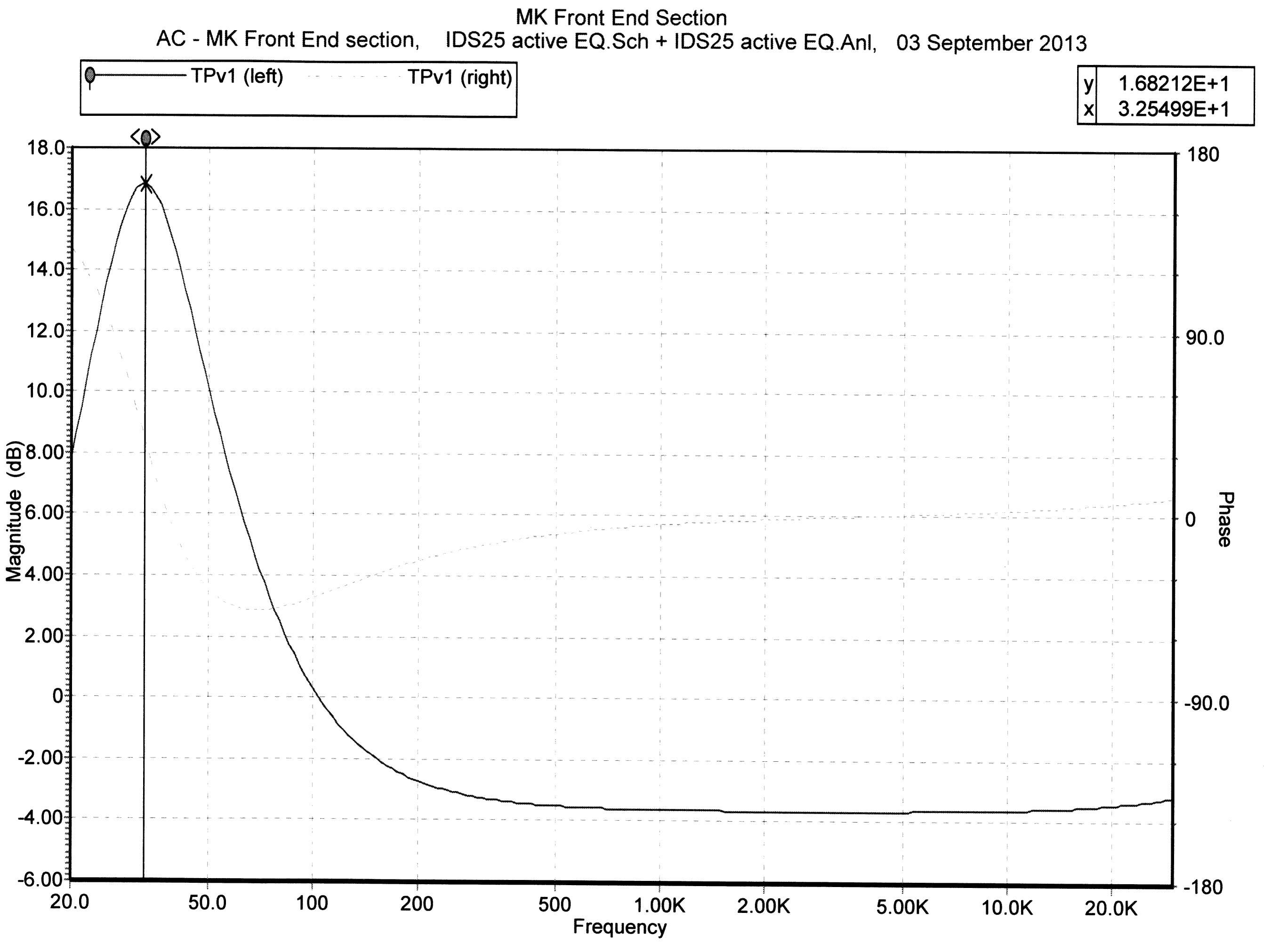

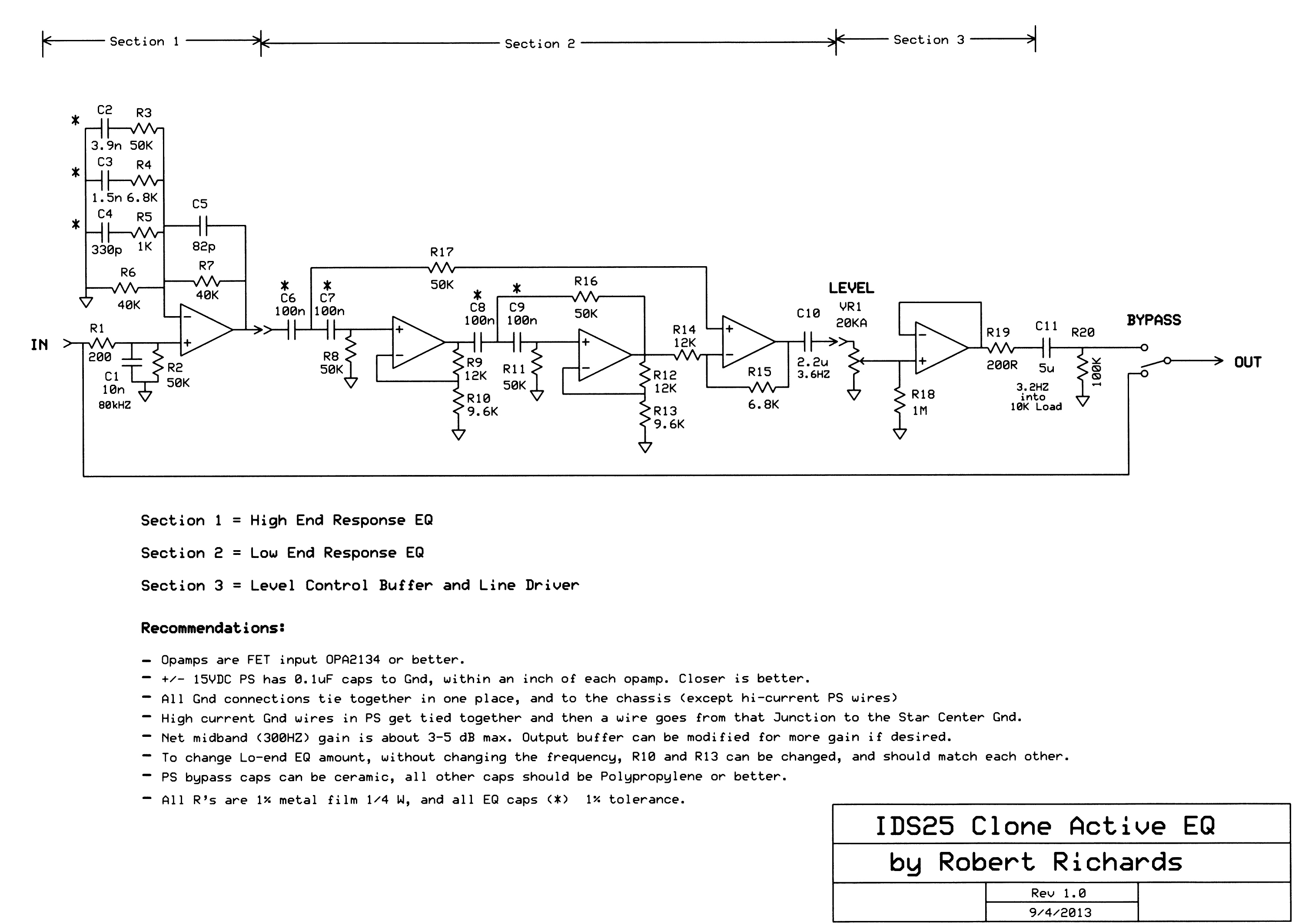

IDS-25 Clone Active EQ Circuit
If I were building an IDS-25 Clone with the 3 inch Peerless/Vifa TC or TG drivers, this is the Active EQ circuit I would use. I haven't actually built this, but it should work fine. The graphs are the result of the SPICE models. I had to do each section separately due to limited page size in the free version of SPICE. If you can't get an exact R value, use one that's as close as you can. Same with caps. Verify operation on bench if possible before connecting into Hi-Fi system. After clicking on a graphic to make it big, you can click again on an icon in the lower left corner to make the image even bigger..
Bob,
I cleaned up your graphics and replaced them. Drawings like these should be saved out as low bit gifs (or png) -- the replacements are 2 bit (4 grays). jpg adds serious amounts of noise and, in this case, the gifs are about a 1/5th the size.

Bob,
Wow! Looks very nice, and not too complicated. You recommend poly caps on the EQ components, could ceramic caps at 5% tolerance work? If I were to miniaturize this as SMT, ceramics would be the way to go. I have to start saving for the 50 drivers now. 🙂 This circuit looks like a fun build. Thanks so much for doing this and sharing.
X

That was quick, Bob! Now I just need to learn how to translate that into something real 😀.
