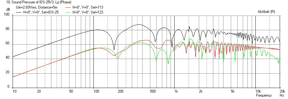

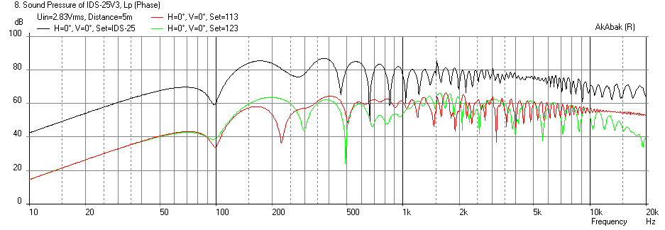

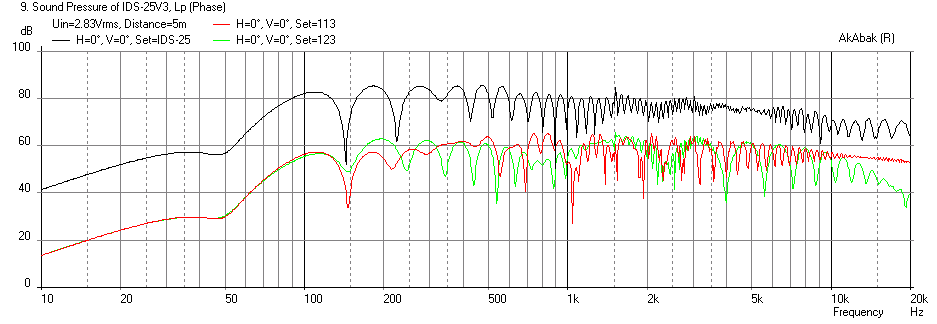

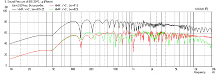

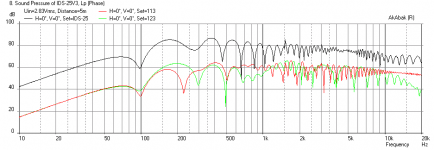

Effect of Wall on IDS-25 Response w/o EQ
Here are the sims of the effect of a rear wall.
- SPL vs Freq for cabinet back 6 in away from wall
- SPL vs Freq for cabinet back 24 in away from wall
- SPL vs Freq for cabinet back 60 in away from wall
All for 1 watt input with mic at 5 meters away and located 24 in off the floor.

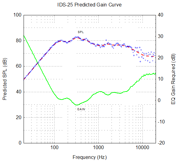

Predicted IDS-25 EQ Gain Curve
Based on the results of my simulation, I came up with the following EQ gain profile for the 25 driver TC9FD array.
Here is the plot of the SPL vs Freq and the Gain Curve derived from it (green).
Below are the actual values of the green curve in ASCII text.

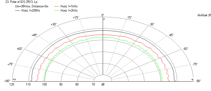

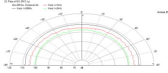

Check out the polar directivity of these speakers. Once EQ'd out they are essentially uniform radiators over 180 degrees with no lobing. Amazing.
Yes, I agree it is exciting for us to live vicariously through Wesayso's Two Towers IDS-25 clone. From the sims I have run, these will sound amazing - the dynamics and transients coupled with how large the sound field is will be quite something to hear. I want to build these. 🙂

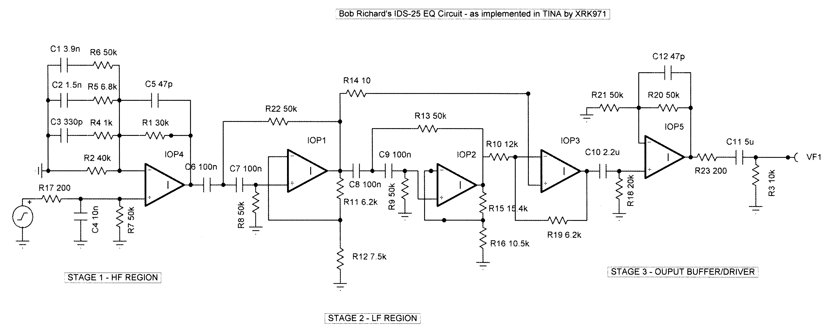

With help from xrk971 (getting the TINA program to work right), I think we may have a good circuit now to share. The 20k resistor at the positive input of the final out opamp is supposed to be a 20KA pot. There's more gain than most will want (at 250HZ) so do put in the pot in place of the resistor. The 10K resistor from the output to ground is a simulation of the worse case load, and should NOT be part of the circuit you build. Replace it with a 100K. R14 is listed as 10 ohms, but should be 0 ohms. A previous circuit analysis program had a problem with 0 ohms for some reason.
I designed the peak heights relative to 250HZ, the low point on the graph. I think this is as good an approximation as we can predict at this point. I would not expect it to be perfect and would therefore use tone controls in addition. Get rid of the previous circuit (and models) if you stored them on your computer. I made a mistake copying the low end EQ circuit, which is fixed now. Several values have changed, and a resistor was added.
As always, make sure to have 0.1uF (or so) caps from the power supply rails to ground, within an inch of each opamp, Closer is better. With a circuit this size, I'd probably have three pairs. I use ceramics for that. I also put 100uF AE caps from the supplies to ground on the board if the wires from the powers supply board are more than about 4 inches long. They may not be necessary, but they won't hurt anything. And of coarse use a regulated power supply. 7815 and 7915 are good enough for that. Copy and print this info too, and keep it with the circuit and graph printouts. Questions are welcome.
Very nice job Bob.
I have a couple of comments to the circuit:
Use the very best opamps (like lme49710 or eq.) and passive components.
Through the IDS25 clones you will hear everything in the chain before them.
If I was to use an analog compensation for the IDS25, I would go all passive with inductors and capacitors just like a normal crossover, but between the source and the power amp.
Opamps (and here a lot of them) does not do anything good for the sound IMHO.

Doing the EQ circuitry passively may result in more noise than you want. Using inductors is rarely a good idea. I was suspicious of opamps myself until I heard the Linkwitz Orion speakers with very good source material. Linkwitz has at least a half dozen OPA2134 opamps in the signal path of his 4th order active crossover and active EQ, and the sound was spectacular. It motivated me to buy 4 Seas Millenium tweeters for my open baffle speaker project at about $850, and redo the active crossover and EQ.Very nice job Bob.

The thing about opamps, and amps in general, is don't ask them to do something they can't do well. Most do audio ferquencies very well, Rf not so much. That means put a passive Rf filter at the input of the circuit, and the 200 ohm R at the output to lessen the effect of any reactance down stream (cables), have good power supply bypass caps right near the opamps, and use all gold alloy connectors and on any switch contacts.
There may be better opamps than the OPA2134, but those are excellent. It's more about phase margin than whether or not a given opamp is showing even better specs, in my opinion. Use gold alloy sockets for the opamps if you use sockets. Keep input wires away from output or power supply wires. Do the star grounding technique right. Those seemingly little issues are where most people screw it up.

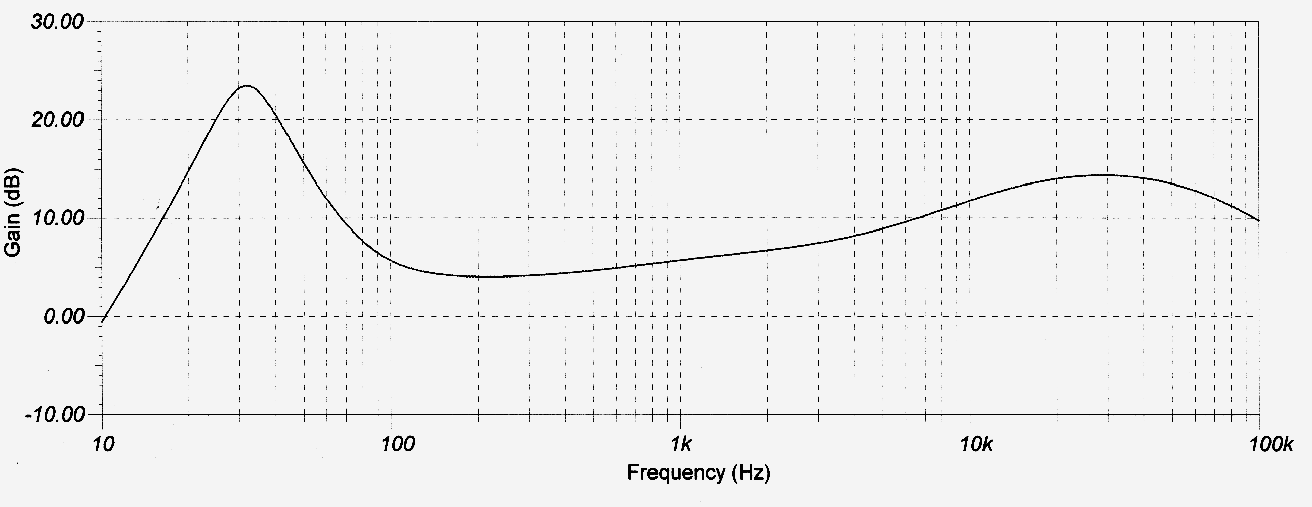

The gain from this EQ circuit is in amplifier gain dB (volts), but the sims I have run shows sound pressure SPL gain (dB) required. I think it all works out in the end but just double-checking if we have the right gain settings required for actually making the speaker do what we want?
Their could be something to that, but what we have here is what Roger Russel recommended for the EQ curve. I also took into account the curve submitted by the guy with the Behringer EQ. When you consider what room acoustics do to the sound of any speaker, getting close is all you can hope for with any EQ circuit. I generally aim at getting a flat response, and then I adjust my regular Baxandall tone controls (4 band in my case) for best overall feel. Those who think tone control circuitry is necessarily bad have been fooled.Bob,
